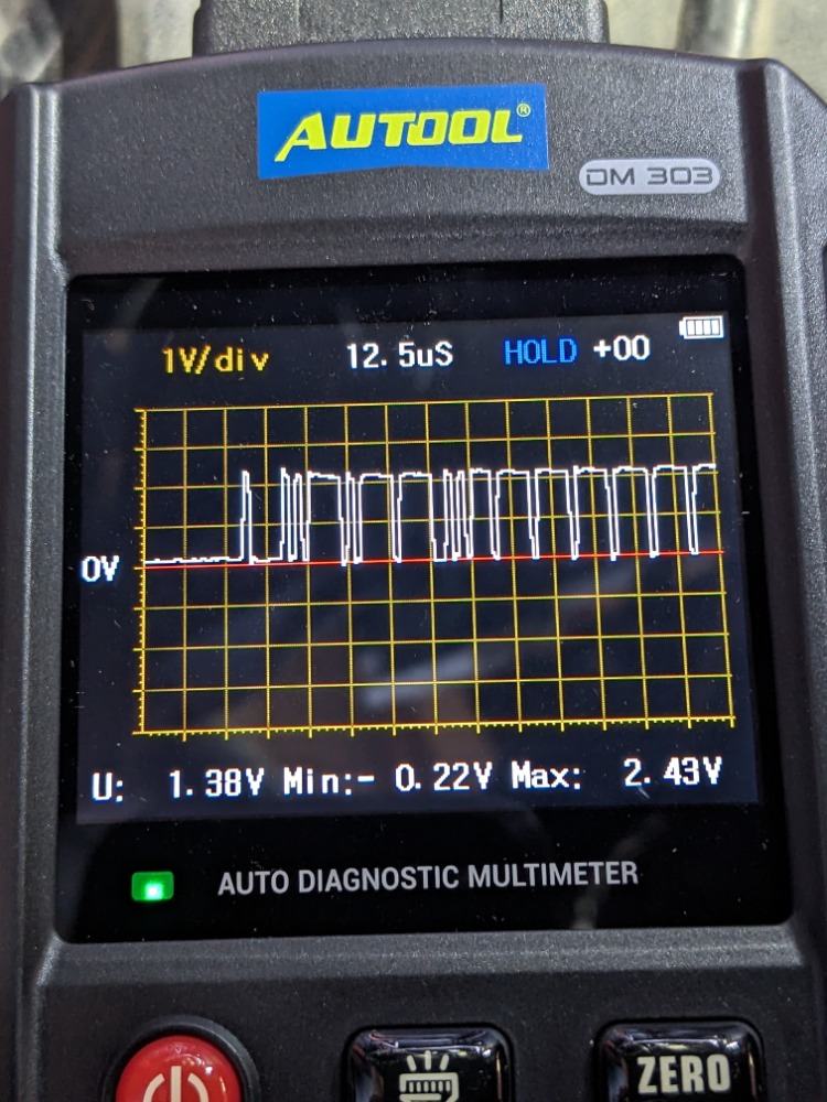

10 months 3 weeks ago #83514 by ChallengerDude
Here's what the can bus from the dlc looks like. Not sure what would cause that wave form.

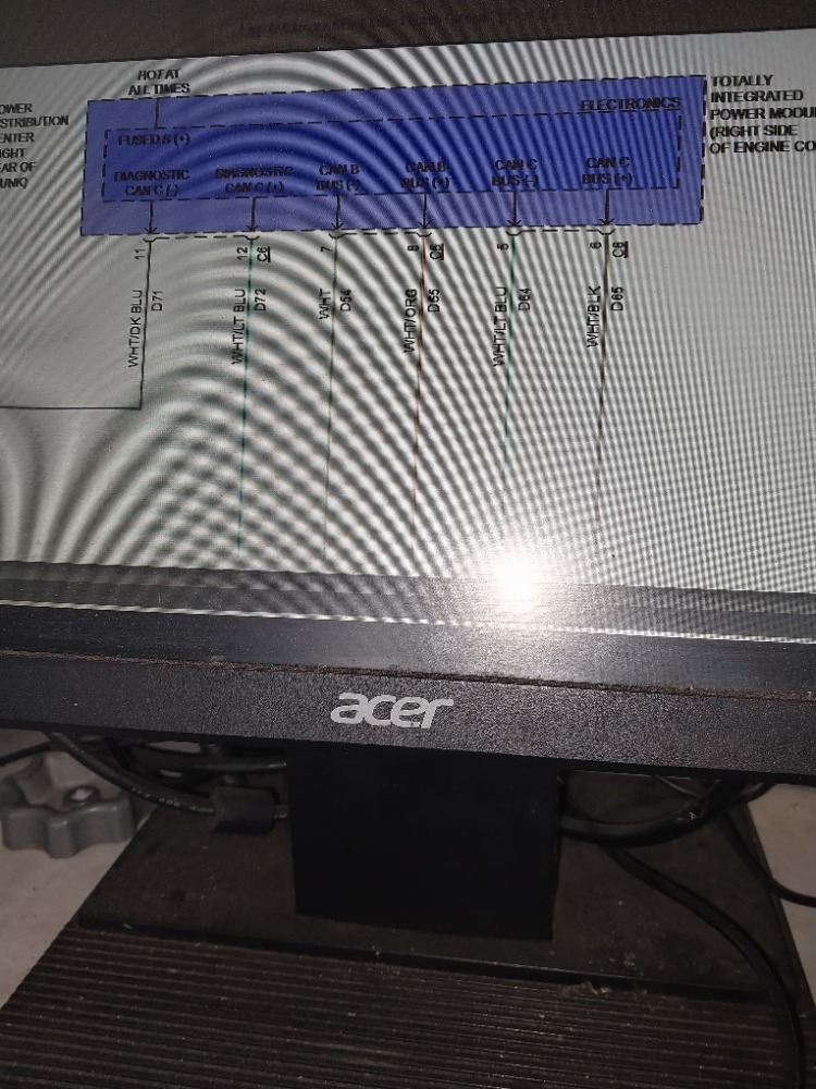

10 months 3 weeks ago #83516 by ChallengerDude
The wiring diagram shows the diagnostic can c bus going to the TIPM and the can c coming out of it. I think I might try to hook up the scope to can c after the tipm as well. Could the tipm produce bad voltage on can c that's keeping the pcm from communicating?

10 months 3 weeks ago #83519 by ferris48
I think you have this single channel scope hooked like this: can high on red lead and can low on black lead. This would explain the absence of the bias voltage. To check for proper bus bias, you'd want to hook up your scope to battery negative.
10 months 3 weeks ago #83603 by Monde
Can you provide the can bus diagram to us if possible?
Is that the diagram you have?
