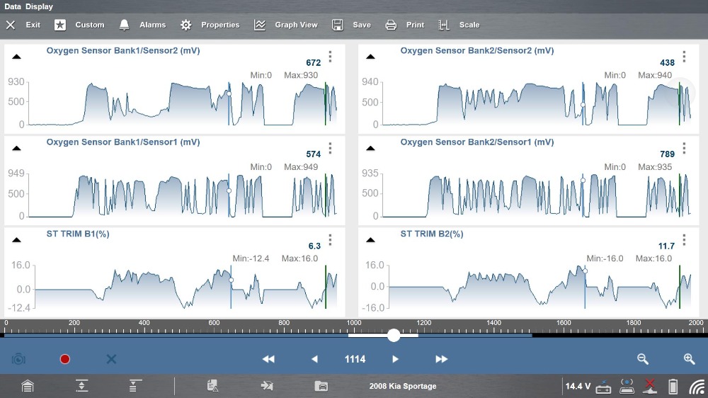

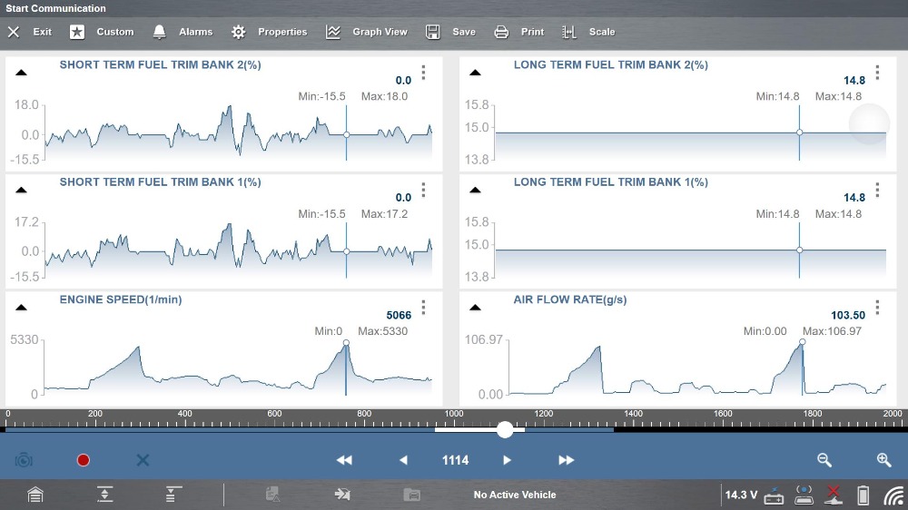

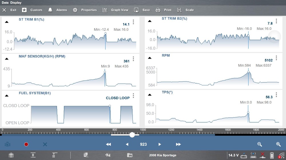

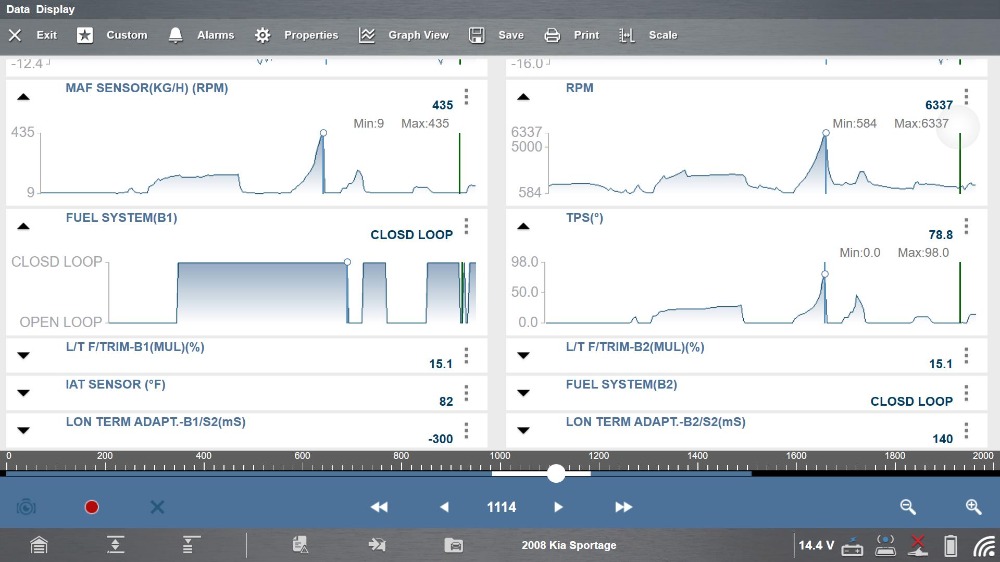

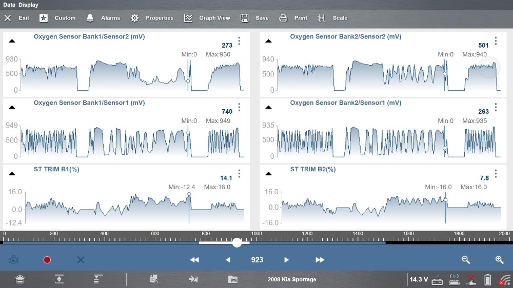

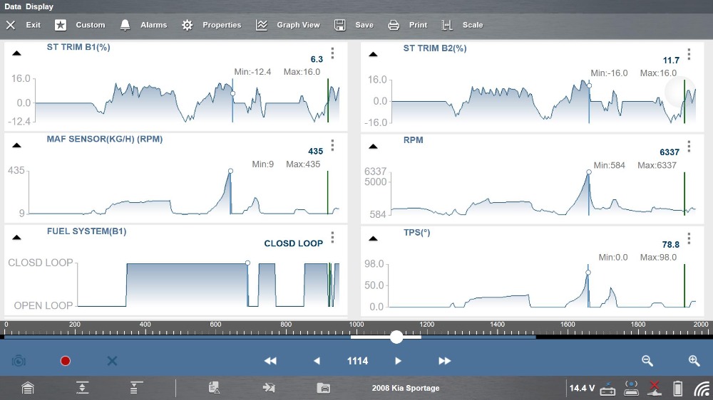

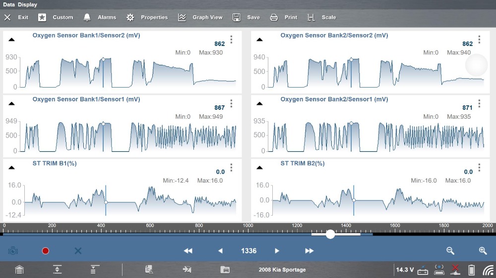

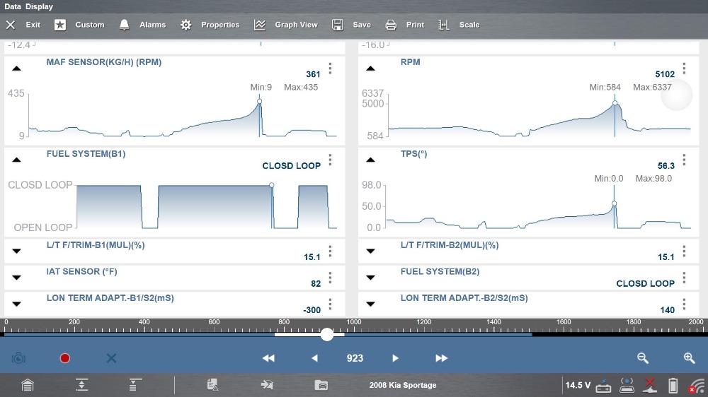

1 year 11 months ago #66885 by Andrew Parry
Replied by Andrew Parry on topic 08 Kia Sportage 2.7L LEAN Both Banks

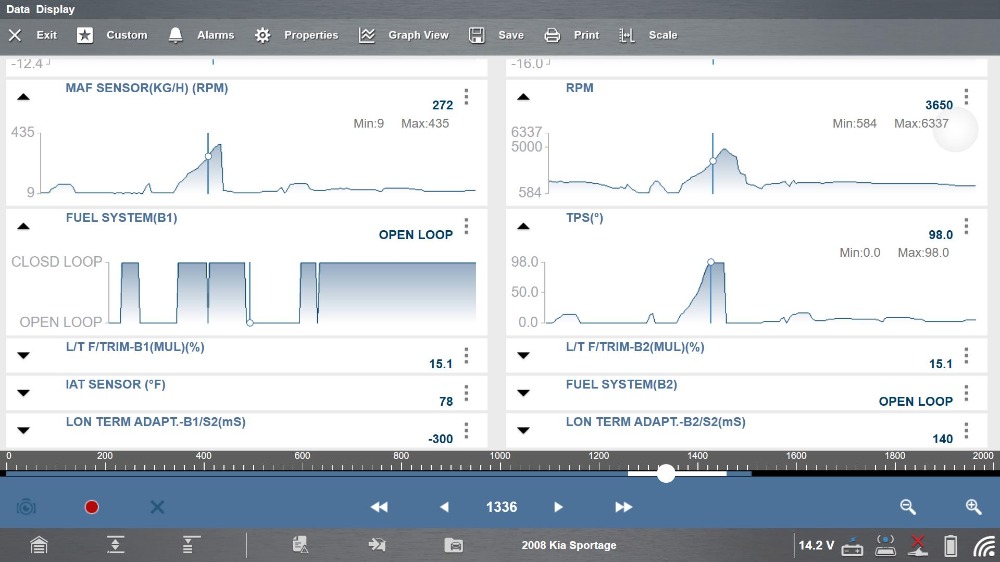

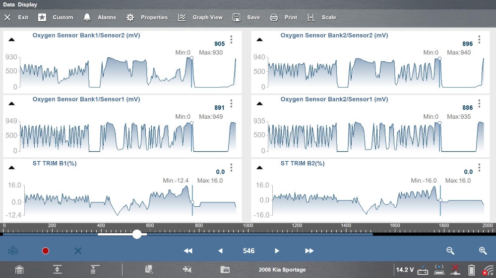

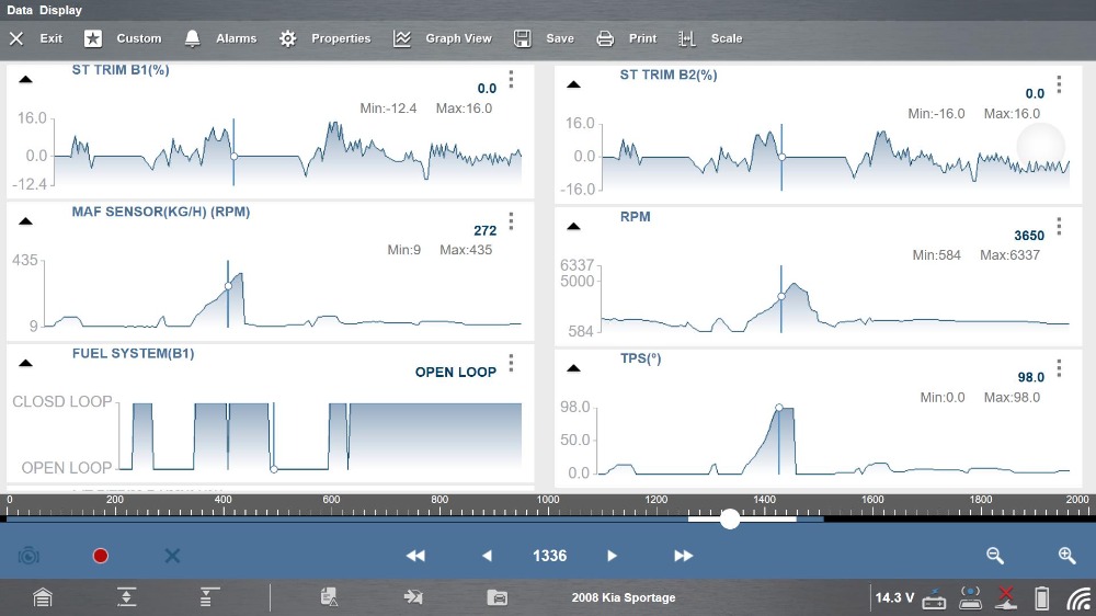

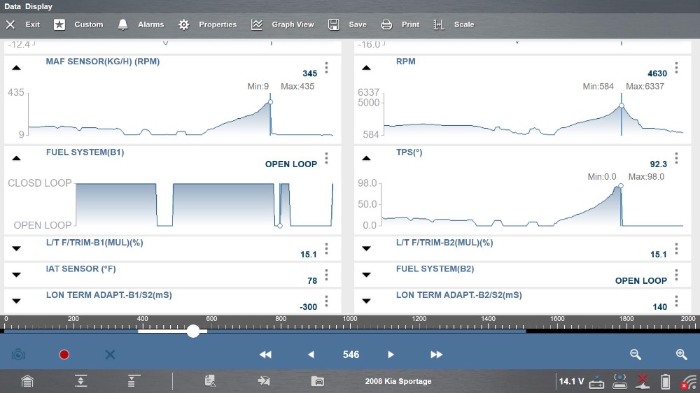

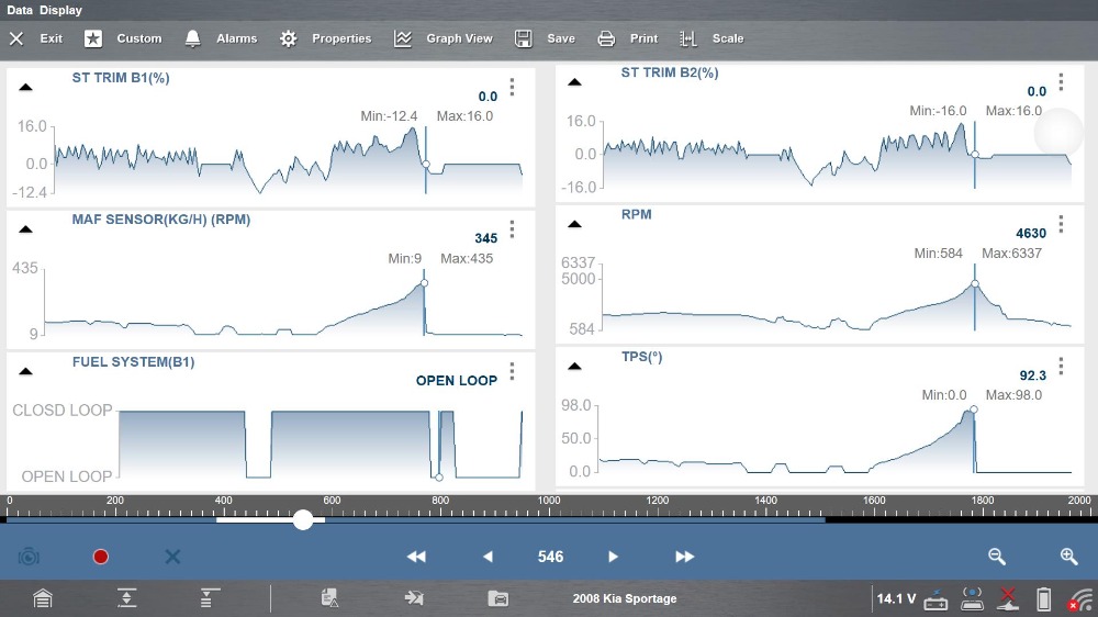

Ok so here are my captures from this morning, my best attempt at doing this.  I am used to doing wide open throttle tests, but not in a manner so slowly and patiently like this necessarily, haha.  I WAS able to select 2nd gear, so that did help.  sometimes I think I went too slowly on the throttle and it was maxing out the RPM before i was at 100% throttle.  Other times, I went slightly quicker on the throttle so to reach WOT completely before RPMs maxed out.   So take a look, let me know what we can gather from this.  I do see MAF reaching 350 kg/h.
I have labeled the pictures "Try 1 1" which means, first try, first screen shot.  then "Try 1 2" which means, first try, second screen shot (SAME point in time, just scrolled down to show other PIDs).  and then like wise for Try 2, Try 3, and Try 4.  Hopefully that makes sense
Truthfully, I cant find anything necessary wrong.  BUT, I am NOT an expert yet, thats for sure.  let me know what you guys think!
  • Andrew Parry
  • Andrew Parry's Avatar Topic Author
1 year 11 months ago - 1 year 11 months ago #66886 by Andrew Parry
Ok only allowed me to post 6 photos, so here are the next two tries (3 photos each)
Also, I do notice that it went to Open Loop as I approached WOT.  Had a hard time avoiding that.  is that going to be an issue?

1 year 11 months ago #66889 by Monde
Replied by Monde on topic 08 Kia Sportage 2.7L LEAN Both Banks
Do your O2s respond to rich and leak conditions as they are supposed to? Do your trims get better or worse at higher rpms while vehicle is in park?
I personally like to use calculated load value, rpm, front o2s, mass airflow sensor voltage if available, throttle position sensors voltage or percentage when dealing with a lean condition caused by a Maf sensor or a fuel delivery issue. I will let others comment on your captures.

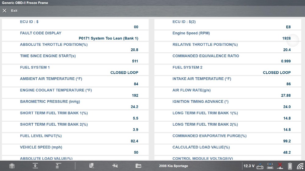

Bringing this back again, as I have this car back again. I am finding now that freeze frame has the BARO pressure low for what it should be in my area, and low currently also, about 23-24inhg when it should be about 29 today. There is no BARO sensor on this, no MAP sensor to infer it from. Maybe inferred from MAF and air intake temp? Or is the BARO Sensor internal to the ECM? Does anybody know how BARO pressure is inferred on this vehicle? I cant find it anywhere in SI either. Thank you!

I would ignore the Baro data unless there is a PID for it, which I doubt. Your vehicle does not seem to be equipped with a Baro or a MAP sensor. Can you post a picture of the freeze frame data?

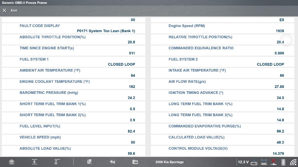

There is a PID under global but not under enhanced.   But it must be inferring it from somewhere though, right?
here is freeze frame data
1 year 10 months ago - 1 year 10 months ago #67029 by Monde
The p0171 code was set when the vehicle was under load( 1927 RPM) at 50 MPH, where total fuel trims in bank 1 and 2 were respectively 20 and 19% which leads us to believe that it is either a MAF issue or a fuel delivery issue. You can try to run the vehicle at idle and noted the total fuel trims for both banks and at 2000RPM to see if it matches the freeze frame data. No need to graph the trims. Just select just the 4 PIDs: STFT and LTFT for both banks at idle and 2000 RPM. Share the picture if possible/

I am not trying to make you work harder. I am just trying to gather some data that can help us fix the vehicle. The way Paul Danner attacks a p0171 code is by looking at the freeze frame data to see what temperature, what rpm, speed and total trims, then compares it with live data to determine the cause of the p0171. Sometime, the freeze frame data is not accurate. If  we could look at the total fuel trims for both banks at idle and 2000 RPM and determine if we have a vacuum leak or a MAF or fuel issue, that would be great. That would help us better in diagnosing the vehicle. That is what most of us, if not all, would suggest. As I said in the previous post, do not graph them. Just see if the total trims decreases or increases. You can also run the vehicle at WOT with all o2s data, TPS voltage and MAF voltage and Loop status chosen, as well as absolute load or calculated load to determine a vacuum leak (o2s will be rich) Maf and Fuel ( o2s will be lean) . If voltage on Maf is 4v or higher and TPS voltage is 4 v or higher and calculated load is 85% or more, we can conclude that the Maf is reporting accurately. Let us do that and see. Good luck.

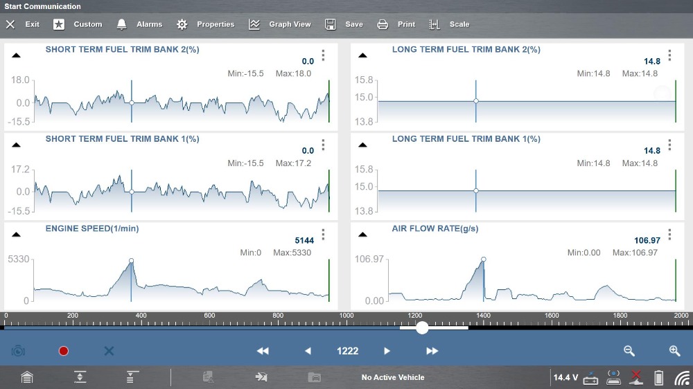

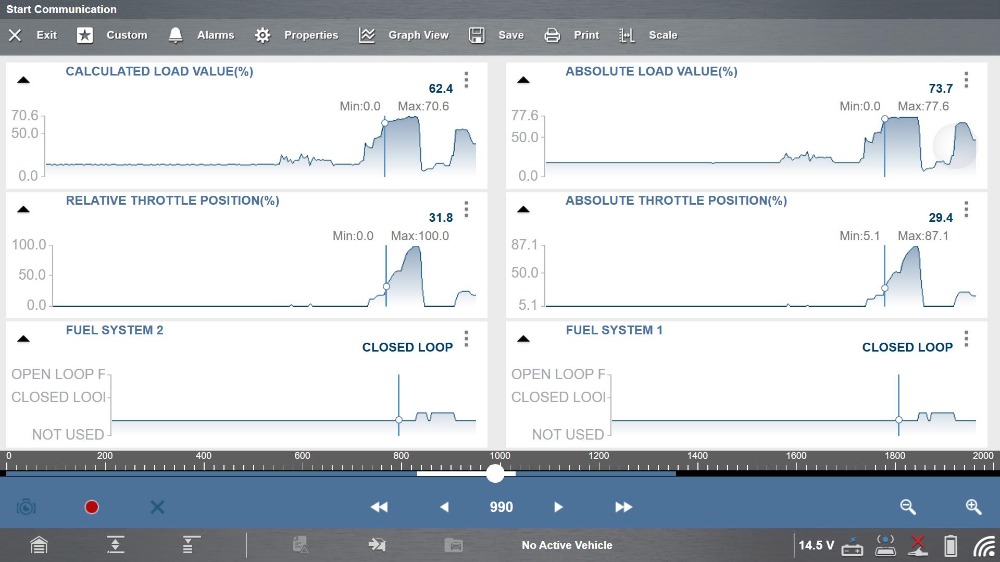

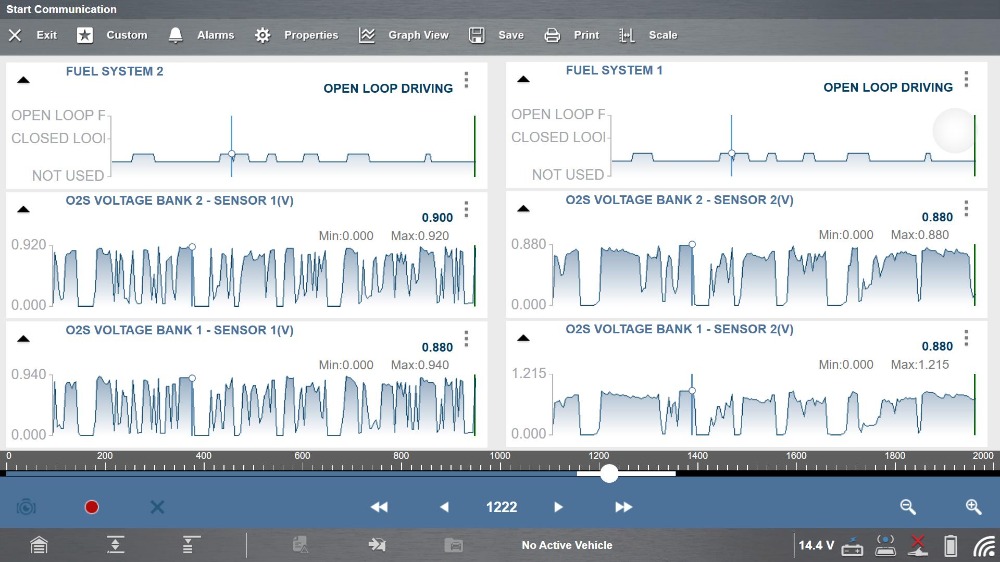

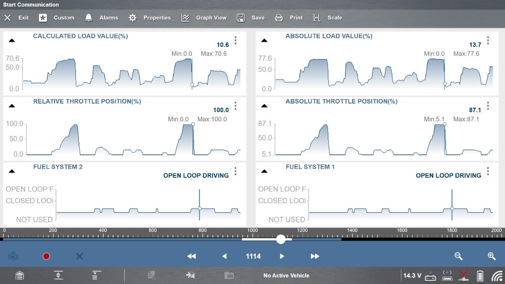

1 year 10 months ago #67045 by Andrew Parry

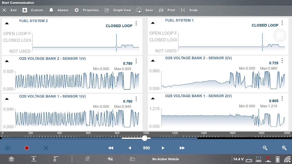

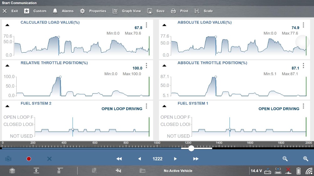

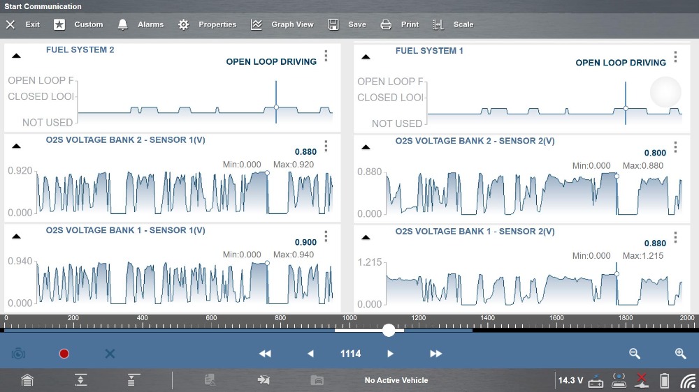

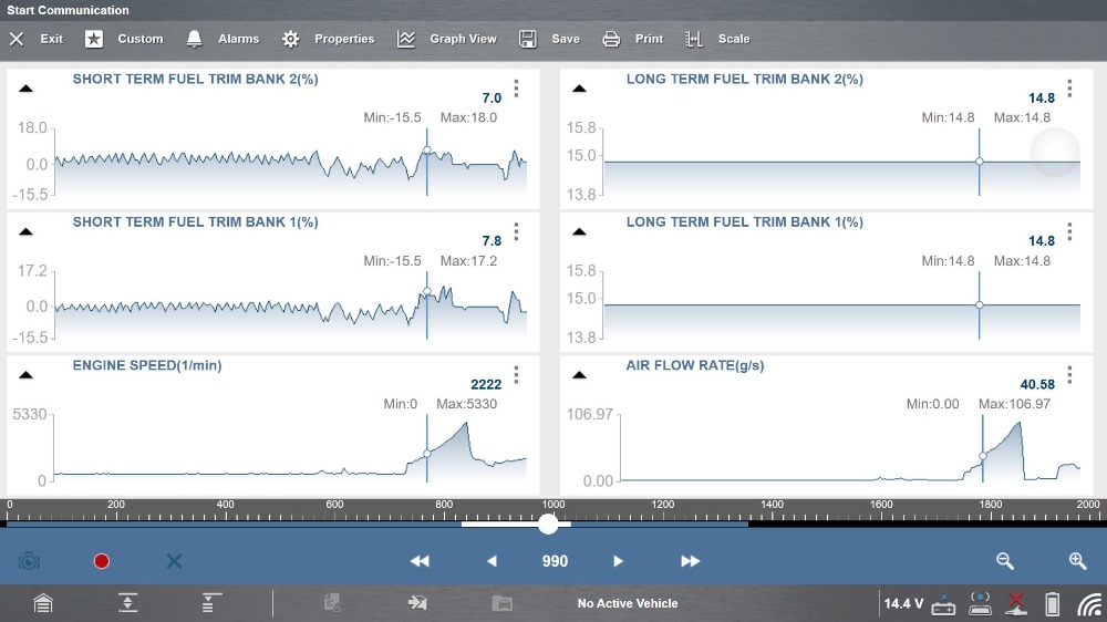

No I do not think you are trying to make more work.  I am genuinely interested, and trying to learn more, how all the pieces fit together, and are very grateful for your help.  I did do some more runs this morning, and am attaching some captures.  Things I notice.  the Trims do go more rich than lean when under load, but go to zero at WOT because it goes into OL.  the O2s do go rich also, at WOT.  My load seems low, which has always been the case, but my MAF does hit 4v at WOT.  I do not have MAF or TPS V here on these captures because I am under global for these to get the Load PIDs.  enhanced does not offer load pids, but does have MAF and TPS voltage.  But on previous test drives, the MAF does hit 4v.  Also, on previous test drives, I was able to hit about 120g/s, if I let rpms climb close to 6k.  I am just getting leery and being careful with this old car...I already blew out the p/s pump from revving it so high haha.
here are the captures,  I just went ahead and recorded all the pids requested, then opened the graphs to get the pictures.   the pictures go together in sets of 3 (the titles are labeled also).  so the 1st 3 go together and are the same moment in time, just scrolled to screen shot different pids.  then the same for the next 3, and the next 3.  Thanks for all your help!
  • Andrew Parry
1 year 10 months ago #67046 by Andrew Parry
Ok I couldnt post 9 in one post, so here are the last 3
1 year 10 months ago #67049 by Monde
The MAF is underreporting. 67% at WOT is too low . I would clean the MAF and see if you have any improvement.

Let's look at the total fuel trim at idle. Just graph the STFT and LTFT for both banks at idle. If the total fuel trims is high, we may have a vacuum leak causing the MAF to read low. I remember in your freeze frame data that the total trims for both banks were 20% and 19% at 1900 RPM and got better at 5000 RPM which suggests a vacuum leak.
