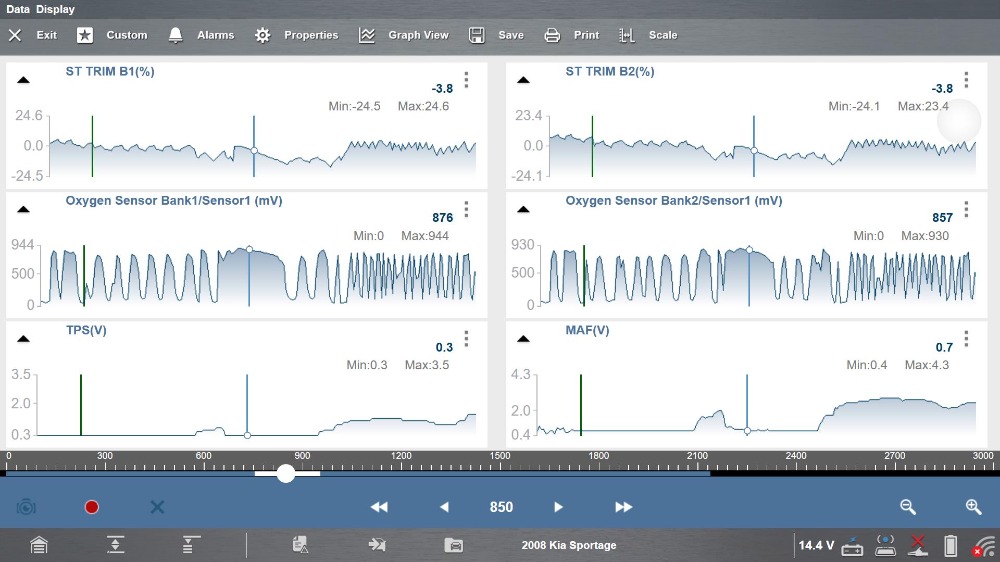

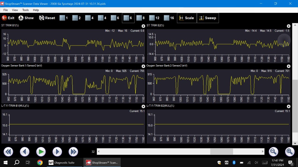

Hey everybody,
I am almost embarrassed to be asking about what SHOULD be a simple find.  Im not sure why but I am having a hard time with it.  I put a new (used) motor in this thing back in the spring for the customer.  engine blew up, vehicle was towed, dead battery, no previous codes available.  new engine runs great, customer is happy.  comes back a week later with lean codes both banks and LTs are matching at 15% and STs are very close to one another, within 1-3 percent at all times.  with dead matching trims, I am not anticipating oxygen sensors or anything.  thinking either air leak, or MAF.  Customer is nice and understanding.  I have tinkered with it on a few different occasions for them over the last couple months.  I smoke tested the intake, cant find a leak anywhere.  sprayed the intake down with carb/brake clean, cant get any change in trims or rpm.  MAF, according to SI, is right where it should be on the data pid, both at idle and at 2,000rpms.  (I admit I suck at properly diaging MAF so if further tests I should do, let me know!).  Oxygen sensors match one another, switching nicely.  They go rich on WOT like they should.  every once in a while, one of them DOES get stuck, sometimes RICH sometimes LEAN only AFTER a WOT event.  but when they are stuck it seems to have no bearing on the trims in a faulty way.  I checked the purge valve, because the STs go negative when you first start it up, thought maybe it was sucking in vapor from tank, then maybe getting fresh air after that - pinched the lines, no change at all in trims.
I did also clean the MAF and swap over the original throttle body (thinking maybe a bad IAC valve) but that also resulted in no change.
lets just pretend I know nothing, and have done no tests so far lol.  where do you recommend I start?
Thank you all for the help!

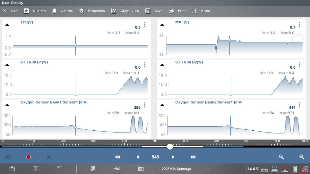

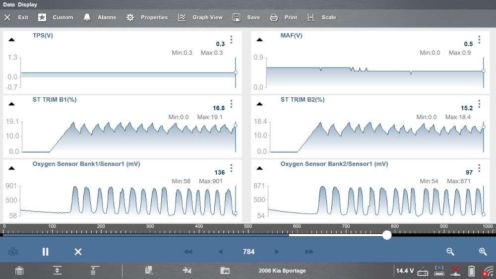

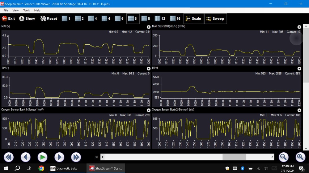

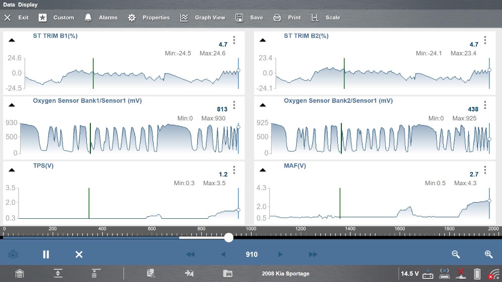

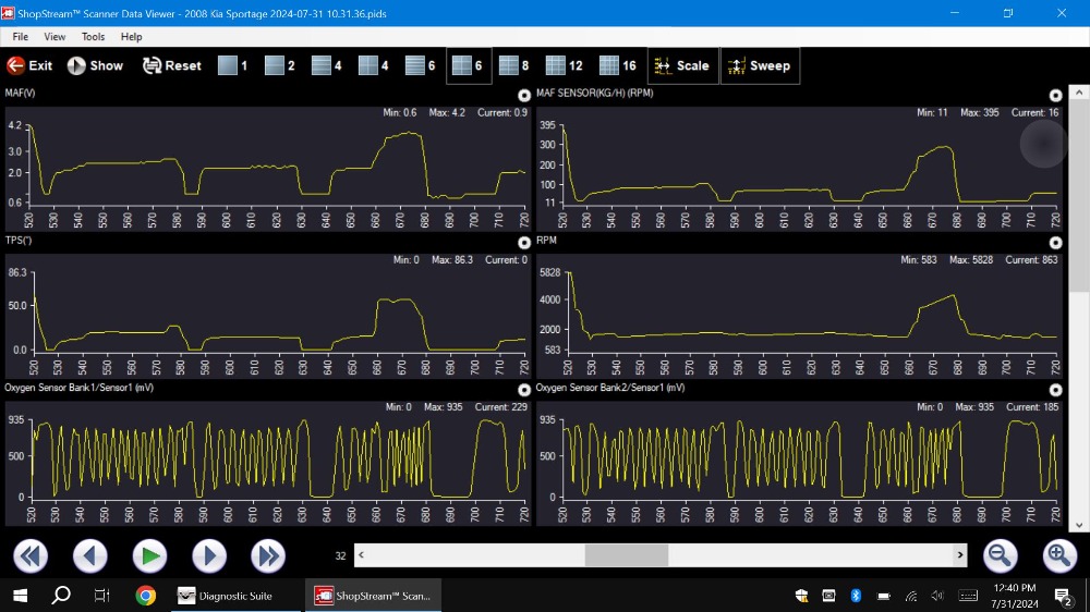

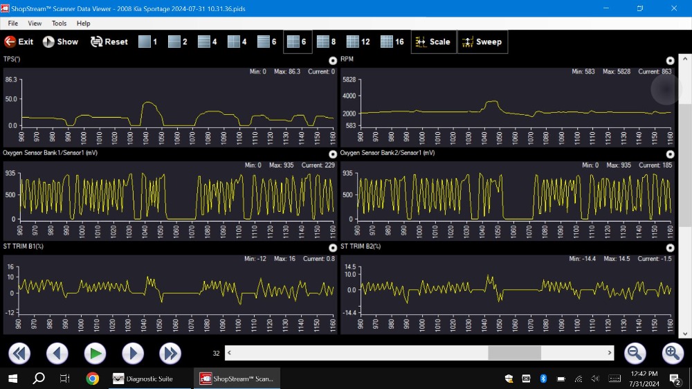

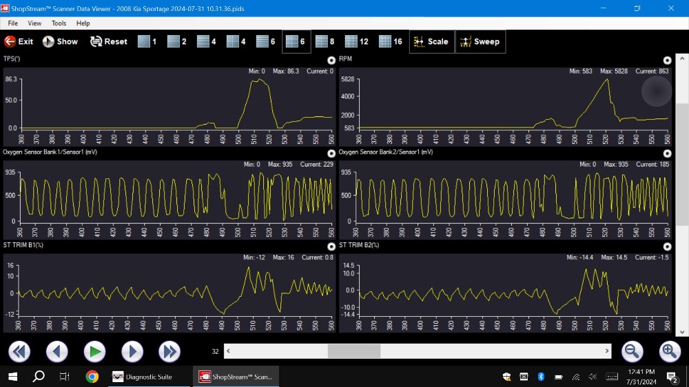

Ok here are some snapshots (all of the same test drive, for reference) that I just took today.  So today it seems, contrary to my memory of last time, the O2 sensors are NOT sticking full rich when WOT - rather they continue switching, although their frequency increases.  does this look like an issue?  is it due to faulty sensors or due to the lean condition?
2 years 2 months ago #66391 by Monde
Replied by Monde on topic 08 Kia Sportage 2.7L LEAN Both Banks
I am not sure how to interpret the switching at WOT. O2 sensors should go rich at WOT unless you have a fuel delivery issue.( Lean O2s). Wait and see what the pros have to say about that.

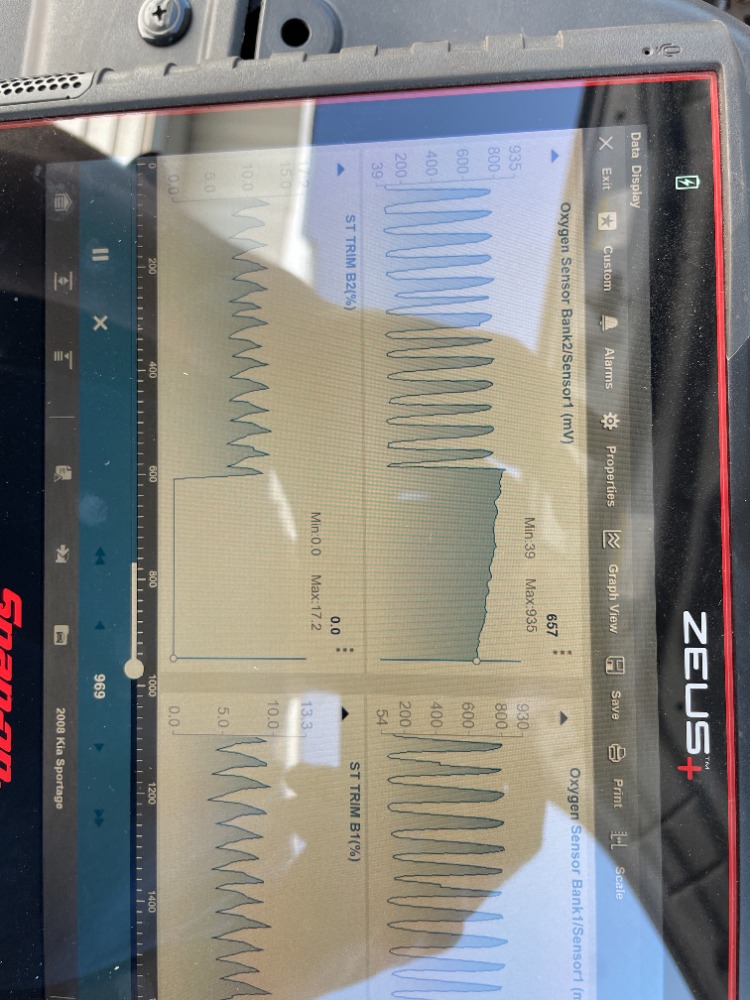

Correct, I am not assuming anything, which is why I haven't put any parts on it yet.  I am thankful that the customer is letting me take my time and figure this one out.
I thought I had figured it out today.  I started studying the fuel system, and noticed that the fuel rails were actually different.  So I swapped them, but no change in trims.

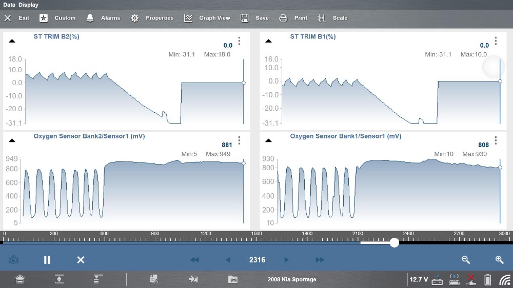

So here is another attempt, I induced propane into the system to try and get these O2s to STICK RICH.  I havent tried this very often, so again, I am not sure what to expect.  But, the O2s never stuck rich but kept on switching, as I slowly increased the propane.  when the trims go to 0, is when it stalled.   Sorry my picture sucks, and I didnt get the other side in the photo, but the other O2 did the same thing.  But I am just using the regulator on my torch, so hard to tell how much or how little I am putting in.   is there a better way I should be doing this?
I do notice that the B2 ST trim is often a few percent higher than B1, as in this picture.  sometimes they are equal, sometimes B2 is a little higher.  But LTs dont change from 15%.

Ok so I worked more on my propane test, and I was able to induce it much more slowly, and it did stick full rich.  And, to answer your question, when disconnecting a vacuum line, it goes lean right away too, no hesitation.  so..again makes us all wonder why they dont stick full rick at WOT.   And, since Oxygen sensors are appearing to be fine...I still have no idea where to go next with this thing, ugh!!

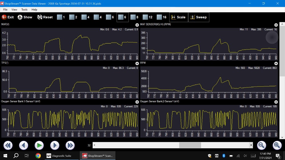

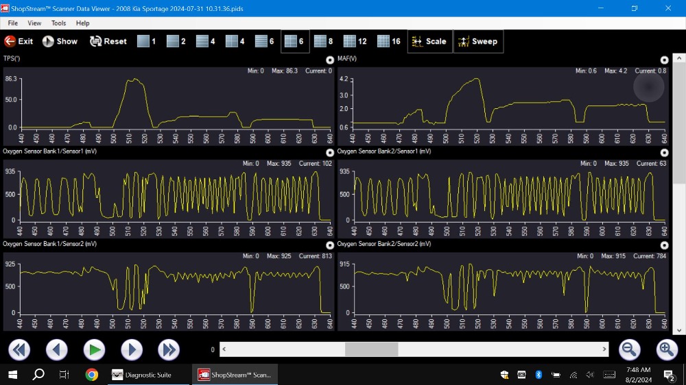

You can try graphing all 4 o2 sensors and do a WOT run and see if the rear o2s go rich.
  • Andrew Parry
  • Andrew Parry's Avatar Topic Author
2 years 2 months ago #66430 by Andrew Parry
Replied by Andrew Parry on topic 08 Kia Sportage 2.7L LEAN Both Banks

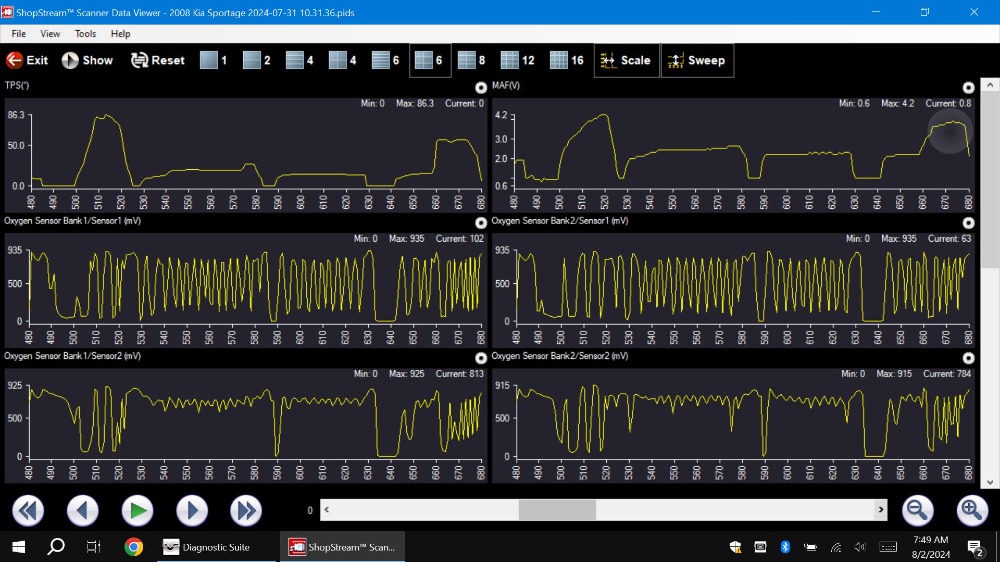

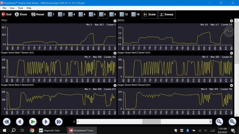

Sure.  I was able to just arrange the pids again from that same road test and screen shot them again.  Here you go.  They switch a little like the front ones, when WOT.  Other than that, seems to be roughly where they should be.  they go lean when the fronts go lean.  So probably accurate.   I would think.
I'm with Monde. You need to check fuel pressure at WOT.

I may be in the minority, but I have seen the o2s continue to switch at WOT. They don't appear to drop dead lean under load. If fuel deliver is suspected to be inadequate, a fuel pressure test will with a gauge T'd in will answer that question.
I would be interested in the freeze frame data: under what conditions did the lean codes set, as well as the fuel trim (long term and short term for both banks) at various RPMs.

2 years 2 months ago #66439 by Andrew Parry
Well I admit, I had not done the fuel pressure test yet.  because it is a pain in the but on this vehicle and had to customize a fitting to make it work.  But I did just do that.  And unfortunately, the fuel pressure is great.  all the time.  50psi.  never wavered below 49 or above 51, at all times.  bummer, was hoping for a dead give a way there.  I attached some more screen shots for fun.  Sometimes the O2s randomly go rich, when I wouldnt suspect them to.  not sure whats causing that.  Also, I reset the fuel trims and looked to see how things responded.  posted some pictures of that as well.  let me know if anything to note there.
I am starting to think that there is something weird between the different motors.  It came out of the same exact year and model.  BUT yesterday I noticed that the fuel rails were different!  (I was so excited, thought I found the issue!)  I swapped the rails and injectors, from the original motor over to the replacement, and there still wasnt any change.  But it makes me wonder, if there is something weirdly different about these motors.  Cal vs Fed emissions, or something, idk.  Repair link doesnt give any varying details.  same vehicle basically.

2 years 2 months ago #66440 by Andrew Parry

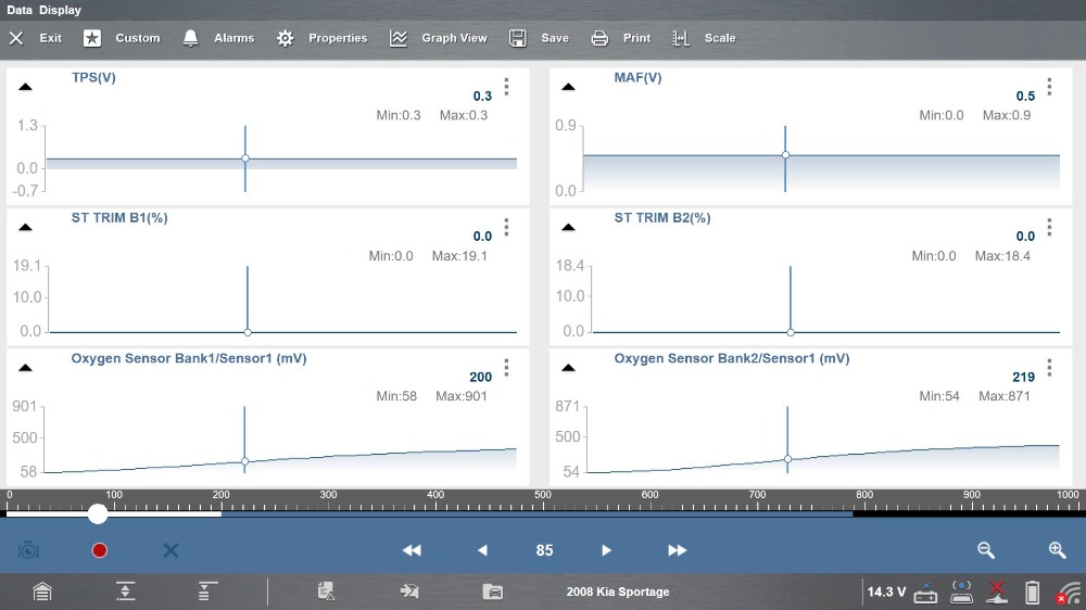

Sorry those photos ended up out of order. The last one is where I first reset trims and turn the key on engine off. the middle photo is where i turn the engine on. you can see the O2 start to drop again. then the trims kick in to bring the O2 back up.

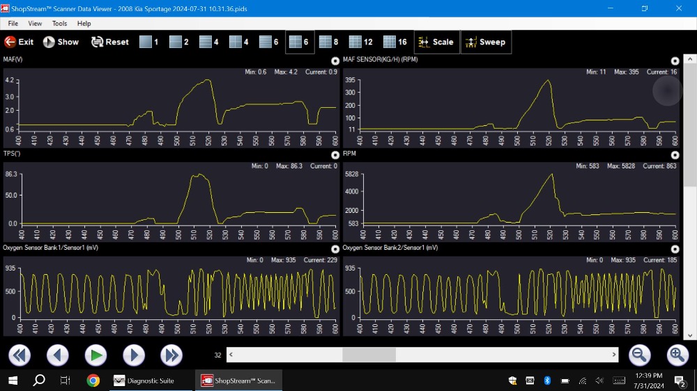

2 years 2 months ago - 2 years 2 months ago #66457 by Paul P.
Replied by Paul P. on topic 08 Kia Sportage 2.7L LEAN Both Banks
Good morning everyone!!! So far some very excellent discussion in this thread!
I'd like to point a few things out from the original 7 screenshots of data;
1. It appears that all of the Oxygen sensors are working correctly, they can switch lean/rich and the post sensor's are telling the truth.  Feedback System appears good.

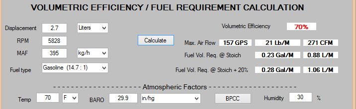

2. I see a max of 395 kg/h at an engine speed of 5828 from the Max/Min' this equates to ~110 grams per second
This a low number this engine should be inhaling 150 g/s or 540 kg/h plus!!!
3.  The data you have provided is insufficient to properly diagnose this issue because the throttle was only snapped on the drive test. Snap-On frames are 0.1 seconds of real time.  We need to get an accurate picture of all engine speeds under load over a longer period of time.
Drive Test
Data Pids of interest;
- ABS LD, which is the Volumetric efficiency of the engine or the Calculated Load
- ABS Throttle Position
- MAF (g/s) or (kg/h)
- Engine RPM
- Actual Equivalence Ratio                                      If the EQ ratio's aren't available graph all 4 O2's,  If you are confident there is not a bank to bank difference in the O2's
- Commanded Equivalence Ratio ( Desired)          Then just graph one bank, this will speed up data acquisition.
- Long Term Fuel Trim  (Both Banks)
- Short Term Fuel Trim   (Both Banks)
Data acquisition is key here!!!  Bring the vehicle at operating temperature and in Closed loop to a safe area.  If it is possible place the Transmission in a lower gear, or you'll have to practice gathering the data with throttle tip in to max RPM from idle without an upshift.
Normally I use generic OBDII data for driveability data acquisition, yes it is slower.  Since it looks like the O2's are working Enhanced Data Acquisition is much faster and more data.
You want to see a gradual rise in the TPS all the way to WOT,  not just snap throttles.  Snap throttles are good for checking Oxygen Storage Capacity of Catalytic Converters.
We really want to see what the fuel trims are doing at all operating speeds of the engine, this is key to this diagnosis.
For example we know that;  Fuel trim that is high on the low engine speed, but good at high engine speed is indicative of a vacuum leak.
                                            Fuel Trim that is good at low engine speed, but high on high engine speed is indicative of fuel delivery
                                            Fuel Trim that is high on low and high at high engine speed is indicative of a load sensor.
                                            Fuel Trim that is Negative at low Engine Speed, but Gradually Increases with engine Speed is indicative of a Dirty MAF.
Knowing these four crucial facts is why it is extremely important to acquire "good" data from a gradual increase in engine speed to WOT under load!!!

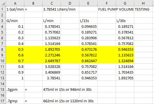

You also mentioned your fuel pressure never dropped out,  it is often overlooked to check for fuel quality and VOLUME.
Here is a volume chart i created:

  Next time you get to play with it, increase the rpm to 2 and 3500 and see if the LTFT improve. Also, do a WOT run and see if the calculated load value reaches 90%
Based on the current data set, I would be inclined to say you are right on the money!!!!
The whole point of this drive test is to determine are we dealing with an AIR or Fuel Issue.
When the ABS lD and Calc LD max out, we know the PCM is happy with the amount of air the engine is inhaling;  so if there is fuel trim it has to be on the fuel side assuming the feedback system is properly operating.
