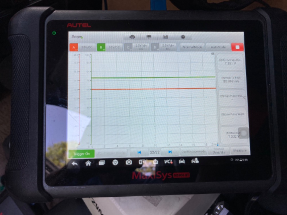

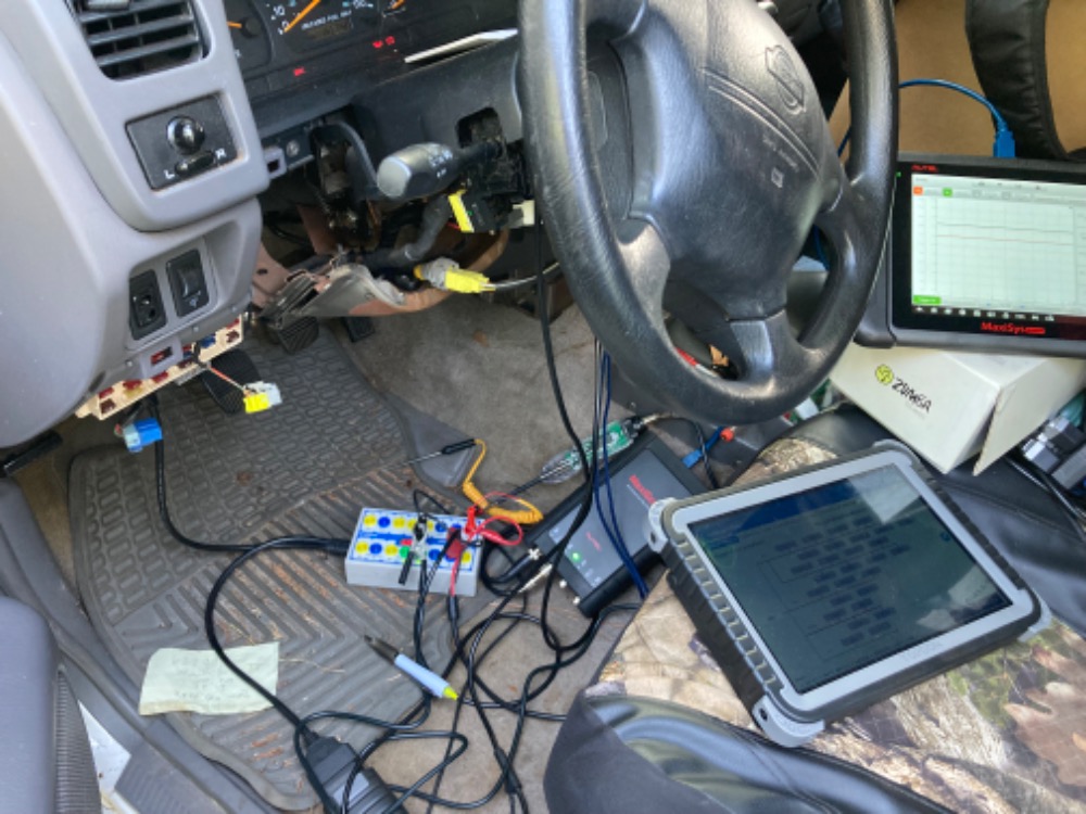

My update was that I hooked up a OBD2 breakout box with scanner and an oscilloscope on the line 7. When the scanner tried to ping all the modules, I was seeing about 7 volts on the line 7. I once saw the oscilloscope trace on line 7 go to about 12 volts and then back to 7 v. It also seemed to go to near 0 volts but that could have been a loose connection. I'll post some pics next

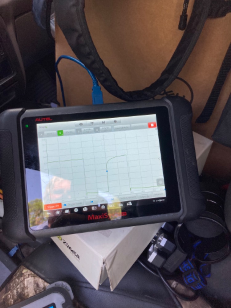

Some photos show oscilloscope readings on K line

I was not successful posting the oscilloscope pics but they show a steady 7 volts on the K line. Perhaps I had the trigger set wrong, but at one point I saw some square waves pulling down to zero in a set of several square waves, but it could be less than 12 volts at the top of the square. None of my scanners can read any modules on the OBD2 diagnostic port. Although the Topdon Phoenix plus seemed to connect but could not talk to any module.

In the pic the green trace is the K-line

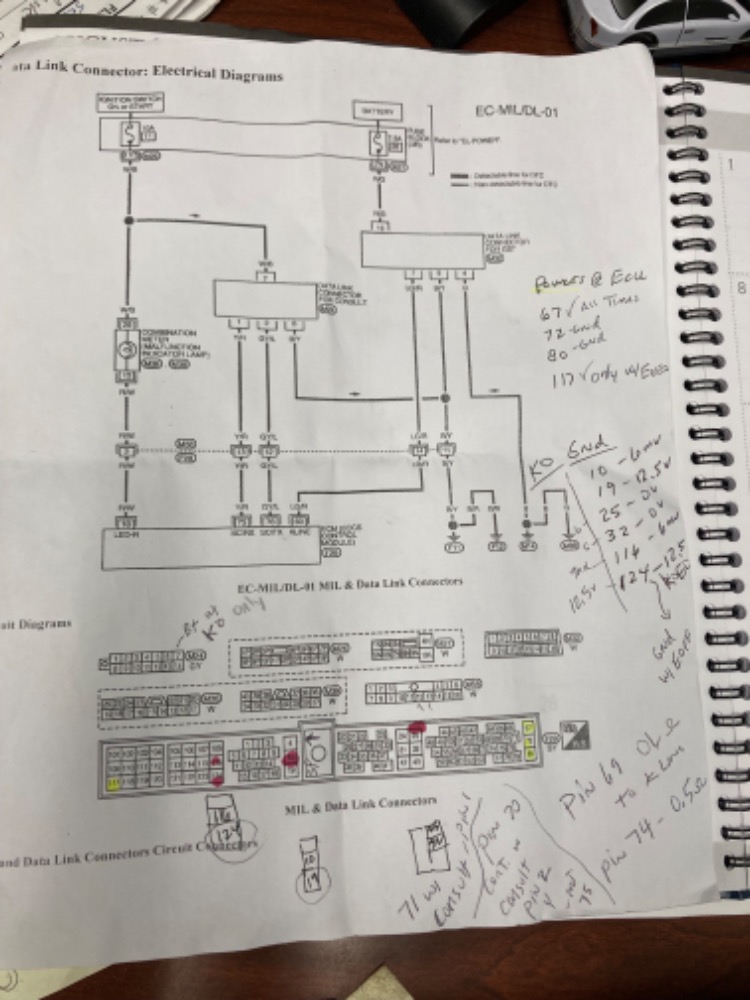

do you have pin outs on the ECU connector? I found no continuity on the K line with the ECU unplugged. The grounds on the OBD2 connectors both look good.

I would like to check continuity from the K-line on the OBD2 connector pin 7, to the connector at the ECU but I need the pin out diagram to determine which pin on the connector is to the K-line. Does anyone have this pinout?
2 years 2 months ago - 2 years 2 months ago #66386 by Monde
pin 69

Thanks for the pinout. I show 0.5 ohms from the diagnostic port pin 7 to the 69 pin on the ECU connector so that's a good circuit. Tomorrow I will reinstall the ECU and cut the light green/red K-line somewhere near the ECU and check that it puts out 12 volts.

with the ECM out of the car, I checked powers and ground on the ECM connector with Key on. I found problems, the following ground pins had 12.5 volts: pin 19 and pin 124. Other grounds were good, but pins 10 and 116 were just a few millivolts. Also, for power feeds, only pins 67 and 117 had battery volts. Pins 72 and 80 had no power.

I want to confirm that the given ECU pin out diagram is for my 1998 Frontier stick shift with 2.4 liter and air conditioning D22 version.  I rechecked continuity from the OBD2 connector pin 7 (k line) to pin 69 on ECU but show OL.  Actually ECU pin 74 showed continuity (0.5 ohm) to the k line pin 7.  Also saw wrong pins on the CONSULT connector to the ECU pins   See picture for readings of continuity
