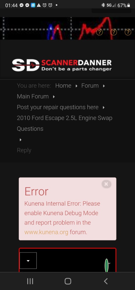

Now to try to add photos. May have to go act like I'm editing them all then save as it'll save to a different format vs the original file I've had issues previously mentioned.
Well it says my photos bring mime files aren't allowed. I'll post them up later today. Got other things such as good beverages, etc waiting on me.
Got this error... Whatever kunea is.... hmmm....

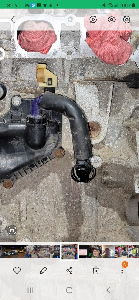

- Posts: 6146
5 years 1 month ago #51225
Replied by Tyler on topic 2010 Ford Escape 2.5L Engine Swap Questions
That's a PCV hose. They used to be rubber only, and failed pretty often - I just changed one in an '05 Mazda 6 2.3L. :lol: The 2.5's got updated to a solid pipe with quick connects. Never seen one of those leak. Unless the pipe is physically damaged, I'd leave it alone.
Kunena is the forum software we currently use.

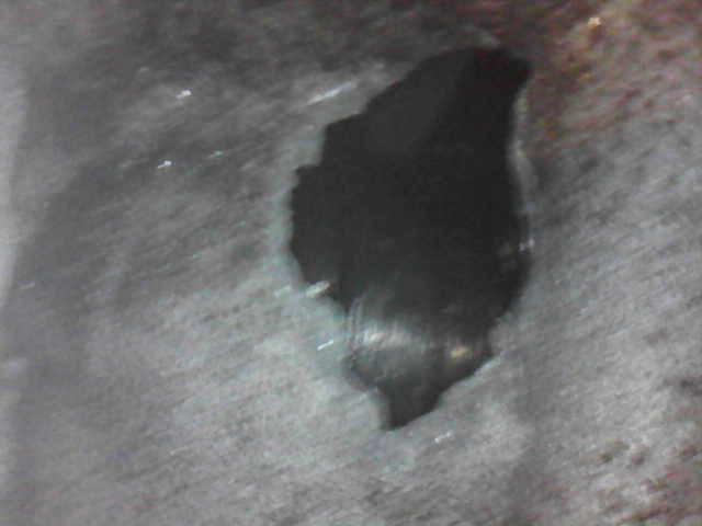

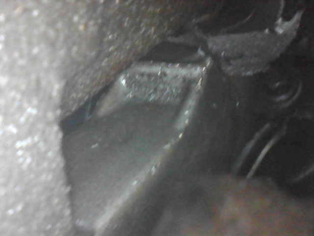

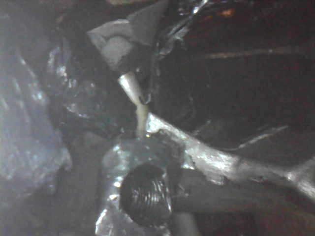

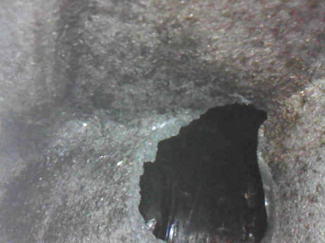

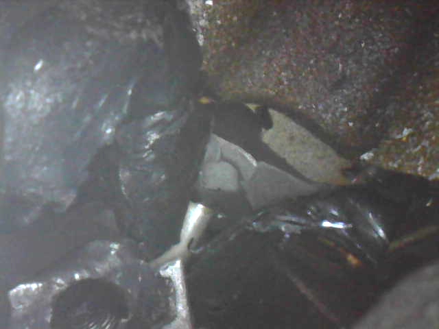

Had to make the video unavailable till this evening as have to edit it as I think I could get some flack so better be safe than sorry.
After I post this I'll drop some photos of the inside of the rear of the engine via the inspection hole custom made by the piston. Just a little bit bigger than the hole needed to get a endoscope thru the hole.
Photos would've been better but the Snap-On scope had a dead camera head when I went to check it early this morning before I left for a couple hours.
