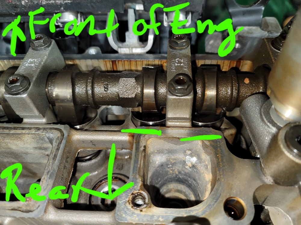

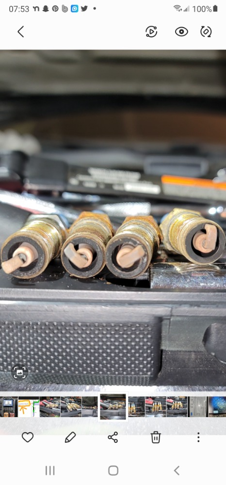

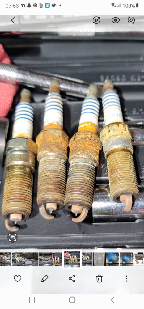

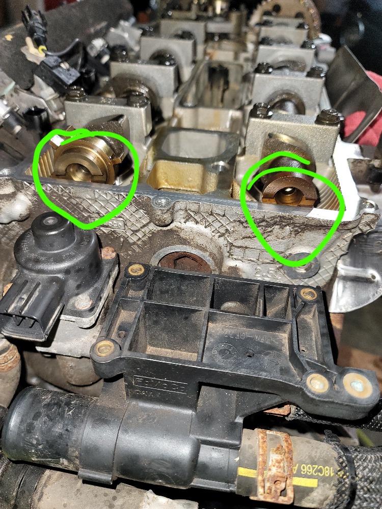

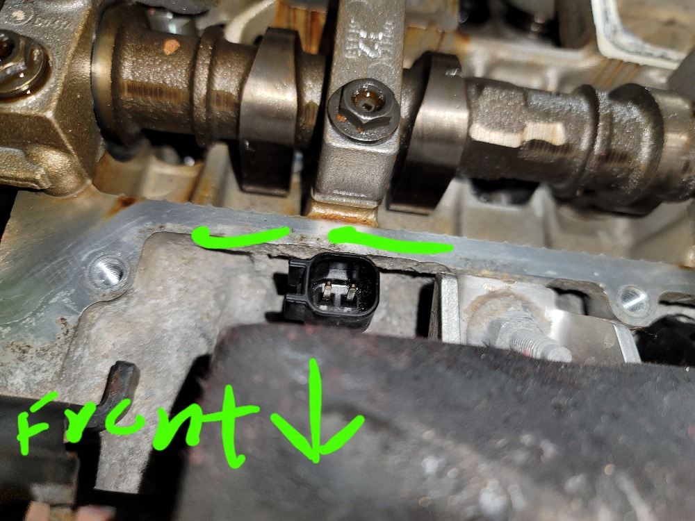

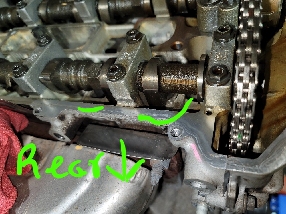

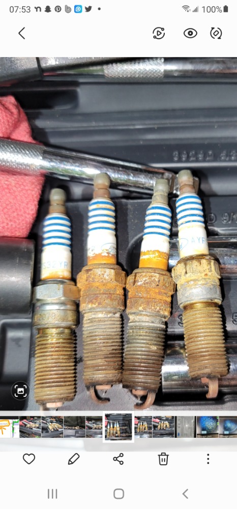

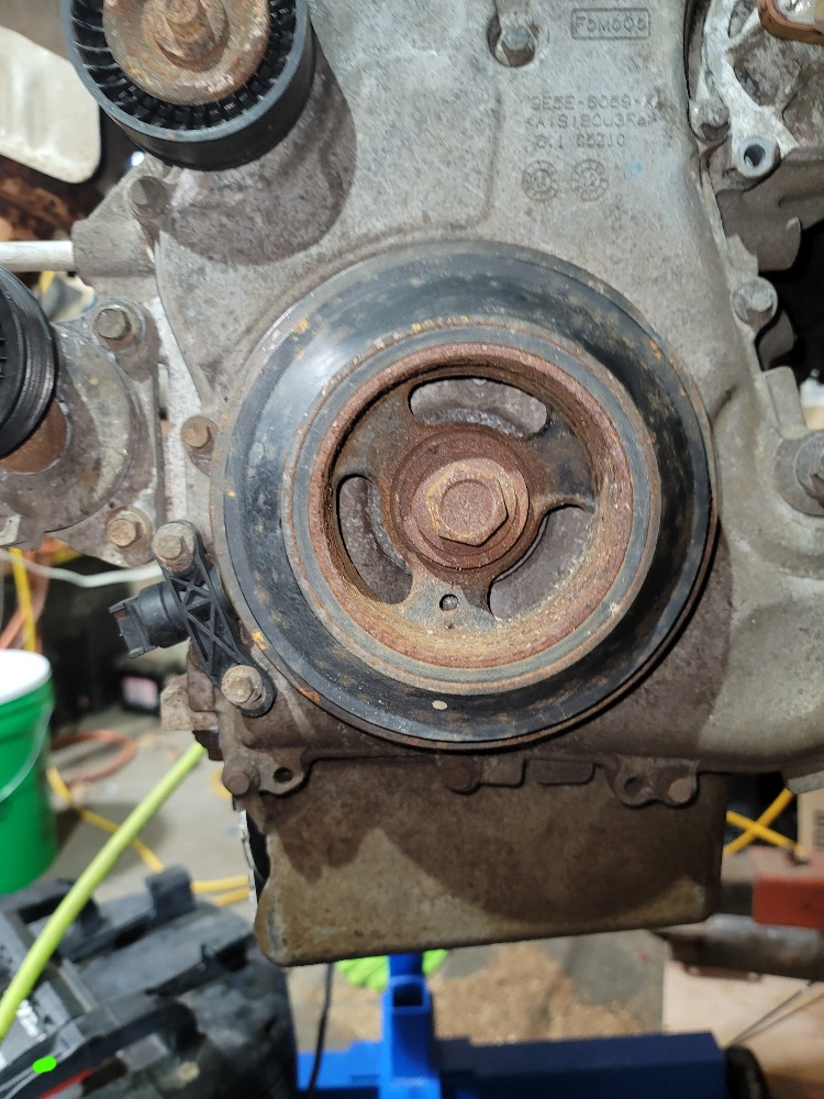

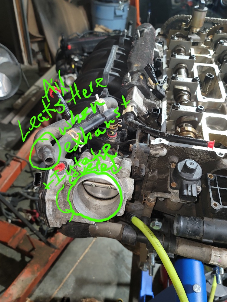

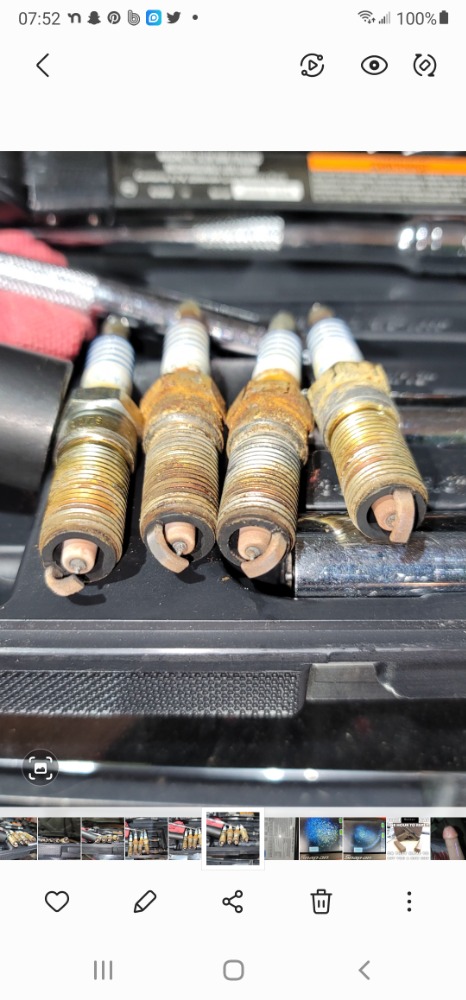

4 years 7 months ago #50604 by Dtnel
Well came up to put a hour or two in on the old and replacement engine.
Got the car jacked high enough safely, used my new stands to secure the front end in the air.
Got old engine on wheel dollies rolled out. Took good video and photos in case I run into a snag putting replacement engine together after testing, etc.
Got the replacement engine on the engine stand and secured. Hold the wiring harness off has the plugs were oily and it appears it was yanked in a couple areas well they were removing it I guess or maybe during an accident the vehicle the engine came from? Who knows.
Got to the coolant temp sensor as I'd removed everything else ahead of time. Pulled the rubber boot back and saw liquid. Decided to removed coils from cylinders so I knew the gravity of the situation.
Now I need to know how to address the issue with the salvage yard. How can they say this engine ran when there liquid in the engine coil areas, yes more than one.
I went and looked at the car-part listings and this yard still has the same engine listed on their listings for their engines.
I vaguely know the owner from when my daughter played slowpitch softball before going to fastpitch they also played in the league before leaving the league a year or two before us as they were a highly competitive team even for recreation ball.
I'm within the 90 day warranty they said the engine had when I got it for the lady I'm helping out who just lost her husband so I'm trying to keep costs down for her.
I have no documentation from them saying the engine ran when I went and purchased and picked it up for the lady.
Here's some photos I took this A.M. with a clean oil drain pan. Keep in mind they cracked the engine oil pan removing it from the vehicle but they got me a replacement.
Now that I've been able to location a engine cradle for her car as well things were going to get rolling along.
All the cradles have been outrageously expensive but when talking to the wife's cousins husband this past weekend as he works at another recycler he let me know that there's a network of recyclers that are partner yards, move parts between each other, buy the parts from each other to help get customers parts. The way he explained it they also review each other so it's in the yard shipping the part's best interest to provide a good part as the part can be refused and sent back. Keeps everyone honest if you ask me.
After finding that out I ordered the cradle and it'll be in Fri so was getting engine ready. Now this issue.
I'll show you the engine oil, what little there was that I drained from the oil pan before putting the engine on the stand.
Weird thing is not one time did I see any moisture around the top of the engine, coil pack areas where you would think you would see something moving the engine with a cherry picker until tonight this and that way using a load leveler.
I'll def be doing a leak down test but with the color of the coils should I even hassle with a leak down test because how would the water get in there unless it was there already. The engine has been in a garage since I got it, same day and it was shrink wrapped covered up when I got it from their yard. As a matter of fact they put the bag on top and wrapped it up good when I picked it up and I have photos of it then as well.
let me know why's you guys in the industry do in situations like this. MY gut tells me contact the yard and see if we can work something out or even get a refund and now we can use a partner yard as i've seen others that have engines that are part of this network. Just for a Fyi this yard isn't part of the network.
If I can't fit all the photos I'll add a link to my dropbox folder on this car. Something I do that allows files to be viewed without having to upload if a large file, video, etc.

4 years 7 months ago #50610 by Noah
Looks pretty typical for a junk yard engine in my opinion.
I've sold thousands of engines in my time in the salvage industry. Sometimes you just can't run them. It's pretty common to assume that if something looks like it hit a train then it must have been running. So you leave the one you have in inventory (so people know you have the engine) and yank one out of a wreck.
I would change the valve cover gasket and run it with no apprehension.

4 years 7 months ago #50624 by Dtnel
@Noah do you think the engine may have leaked internally into the engine coolant temp and #2 & 3 spark plug void? Nothing had been removed and as they said when motor was purchased they had to pull it.
No water/coolant or whatever mixture that was had leaked out moving it around in the garage before removing the engine harness so if nothing leaked put then nothing should've leaked in if you ask me.
What gets me is when they list the engine with 98k miles then have the same listing for the same mileage again. Don't think they have a bunch of 98k mileage cars imho.
Was busy today with other stuff so maybe run the leakdown test and go from there.
IF it passes leakdown then pull the pan and look at the bottom of the pan internally and see what it looks like then move forward.
I'll get ahold of the salvage yard once I do the leakdown test.
I did see there was a tsb on those engine coolant temp sensors to do with a sudden overheat issue related to not properly bleeding them. Saw a video Ford Tech Makuloco where he said a false heat and misfiring can be a symptom and showed how one sensor bled by if I understood him properly.

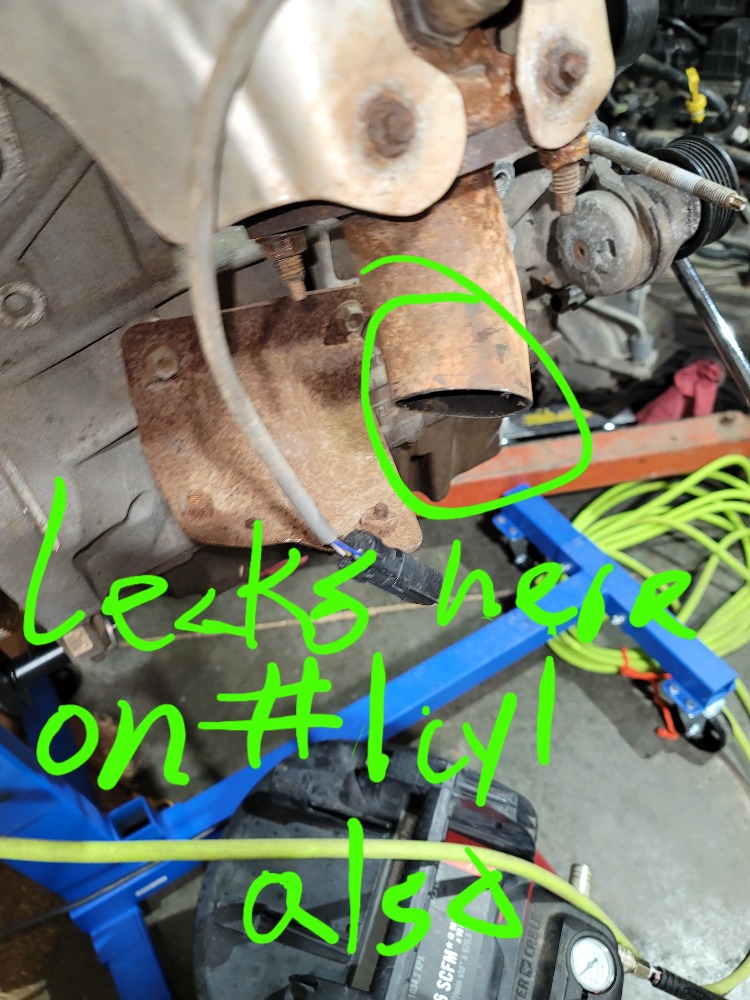

Getting air leaking back into the exhaust and into the intake. When I rotated the engine around the valves have no visual pressure on them from the cam lobes as far as I can tell.
Also looked at the rear of cams from rear of engine view and there's a horizontal line across back of cams where the timing alignment tool would go. I have it at home somewhere just need to find it and bring it as I know there's more than 1 piece besides the horizontal bar. There's a round pin rod that I recall drops or goes in somewhere. Have to look service information up again.

IF I put my hands over the intake and exhaust port it leaks out one of the line ports on intake side that eventually lead to the booster vacuum line if I'm naming it properly?(Photos Attached).

More photos of the cam lobes on the engine. Photo of crankshaft showing that the timing marks are lined up.

@Noah can you tell me what the deal is on the crankshaft pulley if I remove the pulley/dampner to remove the front cover. IS there a certain replacement part I have to get or something since they crankshaft isn't keyed as most engines are?

Also putting a picture of the plugs from the engine in this post. #1 thru 4 cylinder from right to left.
You can definitely tell the #2 & 3 as they have the iron from the water that had filled up in the cavity.
Being the ECT sensor and plug coils were in the engine what could've caused all the water, coolant or whatever it was to get into the area where it was?
The liquid had been there a long time as the coils are stained from sitting in the water and don't just rub off either.
4 years 7 months ago #50819 by Tyler
The 2/3 plug well always collects water/oil/junk. :lol: If the harness was not installed and the engine sat outside, that plug well would have been open to the elements. Or, the Cylinder Head Temperature grommet doesn't seal perfectly anymore. No big deal, IMO. Like Noah said, get a new valve cover gasket set, plugs and coil boots. They're maintenance items on that engine, anyway.
If you're really concerned about the timing, check it now while the engine is on the stand. The passenger side axle will be in your way later. If you use the timing set (flat bar, crank pin, M6 bolt for the balancer) and everything slides in, you're golden.
