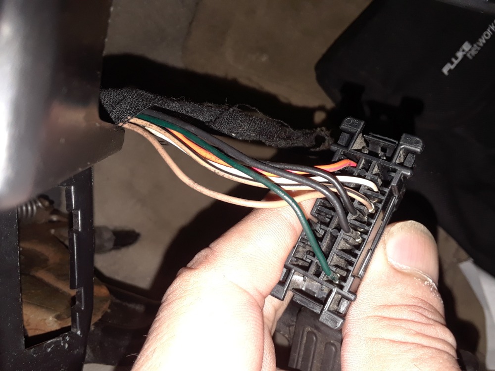

Hey, Cheryl. Okay, for starters, Boston weather will not cooperate, but I did pull my DLC and found something interesting...No pin 2. I have pin 1, 4, 5, 6, 7, 14, and 16. I'm searching for protocol and wiring color code as I write this, although I'm pretty sure this is major concerning the lack of communication between DLC and OBD2 scan. Jreardon sent diagrams, so I'm going to check those and go from there. In the pic below, that green line is in slot 1. The following four lines are 4, 5, 6, 7.

6 years 11 months ago #34990
by VegasJAK
Replied by VegasJAK on topic No crank/no start 06 Cadillac DTS
Does the check engine light come on when you turn the key to the on position?
What do you mean by 4 and 5 checked Ok... they are grounds, what test did you do and what results did you get. How did you get the starter to work with the relay removed?
As Cheryl said, check powers and grounds... look for the 5v reference to TPS, MAF ect… use the diagram jreardon supplied it shows which devices have a 5v reference. Being as you're in Boston, I'm betting on rust.

I just found out what was wrong with this 06 DTS I had at the garage. Car came in with a dead battery. After charge the speed in the display was three dashes no “0”. The light under the “P” in the display was not lit.. No crank, Scan showed only comm with the BCM. From the wiring diagram, all these modules under hood communicate with tan wires that run from one to the other. What I did to get this car started was to jump pins 3 & 4 and 18 & 19 on the ABS module. For some reason the communicate stopped at that module. Once I bypassed this module by jumping those wires it started. I am assuming the ABS module is junk. This car also had a leaking water pump which is right over that module.

Bill's garage, you completed this team. My ABS was the culprit. I had those very same symptoms. After using JR's references, searching the correct values through that nightmare of a harness solved my problem. As stated above, this is my little girl, and I was leary about jumping those pins, but the values were way off. Replaced the module, and brought her back to life.
