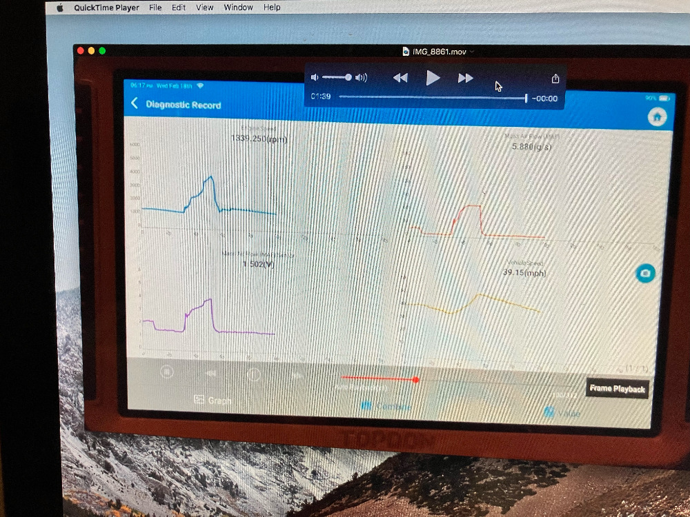

5 months 3 weeks ago - 5 months 3 weeks ago #92702 by Marti
I took a video showing a drive and the scanner PIDs, including MAF sensor values in gr/s, and also V.  The communication to the OBD port would cut out sometimes, and then work other times.
I don't know how to attach a 29 MB quick time video so I just posted the picture below.  From left to right it shows RPM,  grams/second    and then the bottom is MAF volts, and MPH.
Last edit: 5 months 3 weeks ago by Marti.
5 months 3 weeks ago #92707 by Noah
The best way to post a video is to upload to an external server like you tube or something and then post the link here.
Is the loss of comm a symptom or do you think it is a scan tool issue?

5 months 3 weeks ago #92714 by Marti
It's not the scanner, I've seen the comms drop from the OBD port from different scanners. The drop comes and goes, sometimes on the instrument panel of car, the MPH is off, or twice the normal speed values. Sometimes the tackometer and speedometer stay at zero, while other gages like fuel level work. Mostly it works and I can get PID values from a scanner connected to the OBD port. Should I put an oscilloscope on the OBD ports 2 and 10, the SAE 1850 ports?
