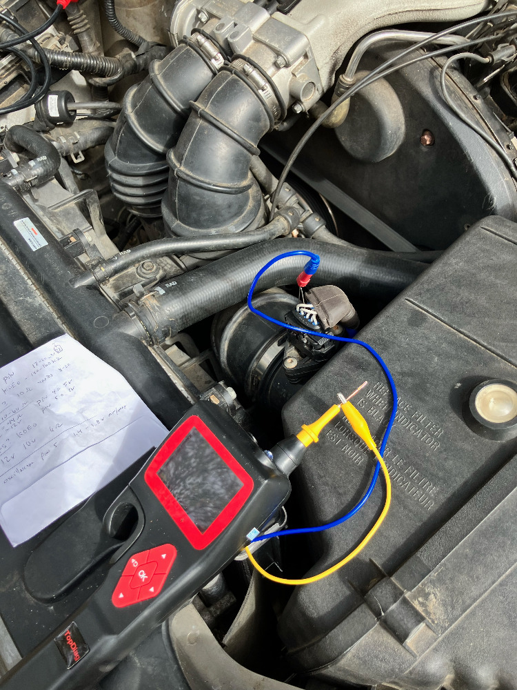

The car is running ok but there are wiring problems on the mass air flow sensor (MAF) and I am trying to verify the wiring integrity but need:
Pin-out for connector 1 (C1) at the Powertrain Control Module (PCM).  I need the circuit for pin 39 at this connector.  I also need to verify that MAF Pin 4 (labeled low reference on a wiring diagram I saw) is normally at 5 volts as I am measuring, and not supposed to be at ground voltage on this tan wire.
In 2022 I was on this forum and got this car running but I had to cut (near the PCM) the tan wire to C1, Pin 26 and ground it to the engine block in order for the car to start.  I want to fix the problems with the ground to the MAF and figure out the circuit for the tan wire I cut.

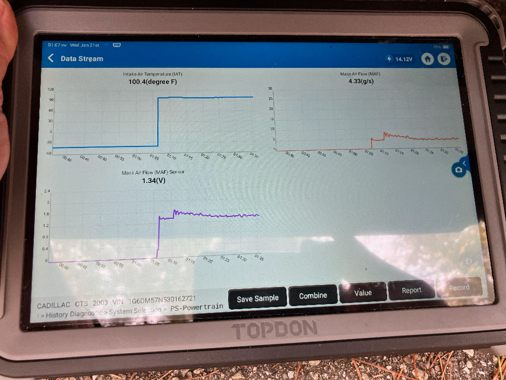

Attachments:  The second image shows the MAF/IAT sensor first unplugged (low readings), then plugged in and reads just over 4 g/s of air into the engine

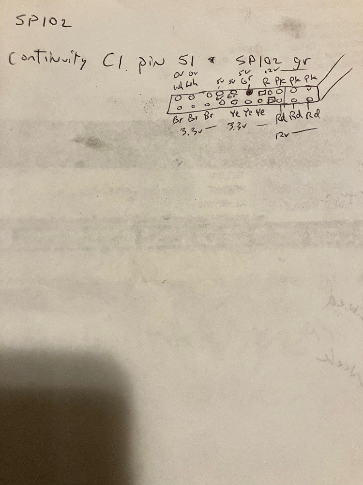

After measuring at C1 on the PCM I found two things. First, Pin 26 at the PCM is the line I had to cut to get the car to start when I worked a few year ago on it with the moderator that uses a picture of a card (Jack). I cut this line at the PCM and grounded the cut line that goes back to S111.  The other end of the line was left unconnected going back to the PCM.  This circuit goes to the Splice S111 which splices three tan wires going back to the PCM low reference on Pin 26. From S111, It goes to Pin 3 on the MAF and I think the IAT sensor uses this as a ground.
Second, I found on the MAF, Pin 4, tan line is always at 5V, either with MAF plugged in or out. That tan line goes to pin 51 on the PCM which is labeled low reference (measures 5 v at the PCM pin 51). I discovered that it has continuity with a grey line at the splice 102 in the fuse box near the battery. KOEO I measure 5 v at this grey line that somehow has continuity with the MAF pin 4 tan line.  See the pic below and the filled in grey line on SP102 is the particular grey line with continuity on the tan line Pin 4 MAF.
  • Marti
  • Marti's Avatar Topic Author
6 months 2 weeks ago #92590 by Marti

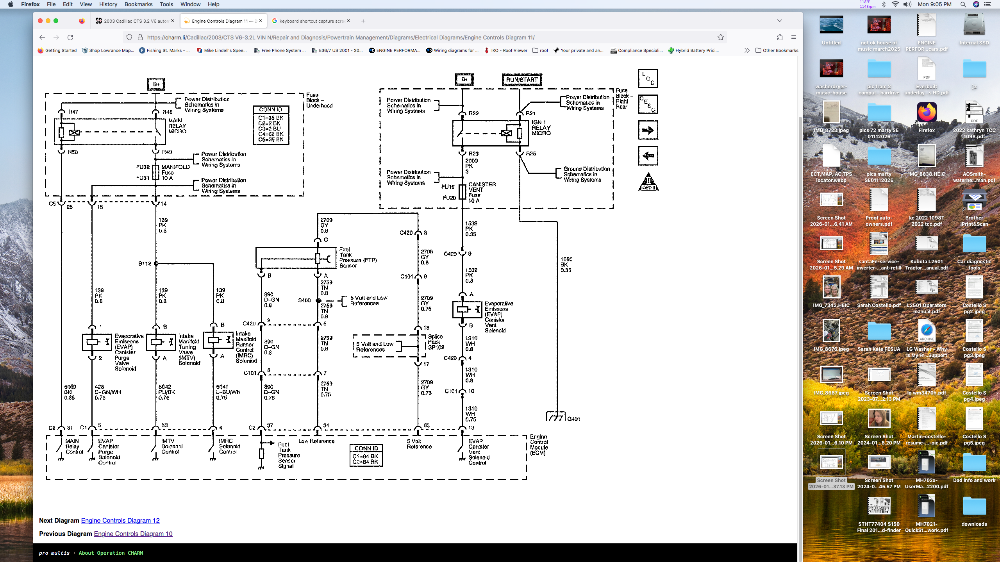

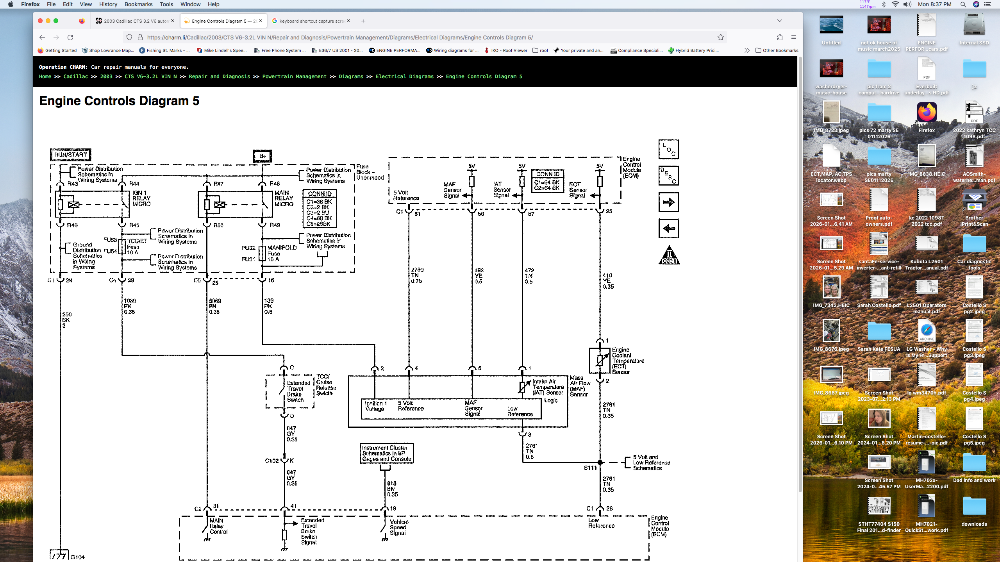

Apparently, the MAF Pin 4, labeled low reference, is a 5 volt ref line at ECM C1, pin 51 as seen in the skematic below from the Charm website.
Therefore I suspect my main issue is to fix the S111 line that connects the MAF Pin 3, and the ECT and CMP tan low ref lines to the ECM pin 26 (I cut that line to get the engine to start. The incoming line to the ECM which was cut was then grounded to a bolt on the ECM housing) I suspect a bad S111.....

6 months 2 weeks ago - 6 months 2 weeks ago #92591 by Marti
I found the circuit that shows the splice pack 102, gy line that had continuity with my ground line on the MAF pin 4 line. The gy line is a 5 volt ref line at ECM C2, pin 63. The circuit is below for that gy line.  I guess this makes sense if the 5 v ref circuits all have continuity through the EC--therefore the MAF Pin 4 line being a 5 v ref line (labeled low ref for some reason) has continuity with another 5 v ref line like the gy line from the other connector C2 on the ECM.  Note the gy line feeds 5 v to the fuel pressure sensor.

There is a discrepancy between wiring diagrams from the Charm.Li website and the one I paid for on Portal=diagnostic.com (Automotive Electricians Portal). It shows a 5 v reference on MAF pin 4 on the Charm site (PowerManagement/Diagrams/Electrical Diagrams/Engine Diagram5 ). On the Portal-Diagnostic.com site it shows Pin 4 as a Low Reference on C1, Pin 51 of the ECU. Which is correct? I read 5 volts on this pin when the key is on... I copied the Portal-Diagnostic diagram above, and the Charm diagram is also copied above...

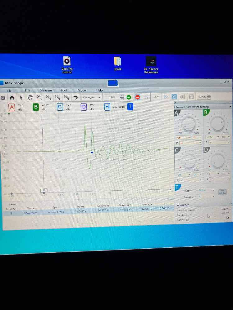

I have two images. First is scanner values with the MAF in various modes, key on, engine off·KOEO, and unplugged, and engine on. Next I used an oscilloscope and measured the MAF sensor line, pin 5.
6 months 2 days ago #92657 by Noah
I am also seeing, according to shop key, that pin 4 is 5v.
I don't think this is a frequency generating MAF based on your scope capture and the description of the MAF in shop key as well.
