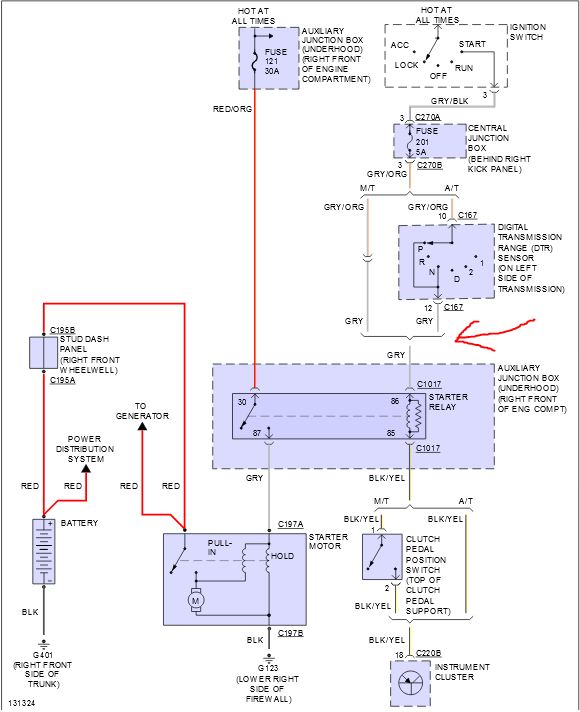

2000 Lincoln LS 3.9L V-8. No click crank or start. Everything powers up(dash, radio etc) Its not a PATS issue. The starter is fully functional. I have full power to battery terminal on starter, However I have no power to the solenoid terminal when I turn the key to crank position. Relays have all been tested fuses tested.. The relays are receiving power. Battery is new and all connections are clean and snug. I could really use some guidance on this issue. Really rough time for me right now and need the car to maintain employment. God Bless.

www.revbase.com/BBBMotor/Wd/DownloadPdf?id=69483 have you tried jumping the starter relays pin 30 & 87? to see if the gray wire from the relay to the starter is open.... also have you did a ground to ground voltage drop test??

8 years 4 months ago #15442 by Chad
Replied by Chad on topic No Click Crank or Start
swilson7674 wrote: Briefly explain "bypass test" please.
The ignition switch, when it is in the "START" position, supplies power to fuse 201. To by-pass the ignition switch and gear/range selector , use a powerprobe, or some other 12v source, to supply power to the GRY wire.

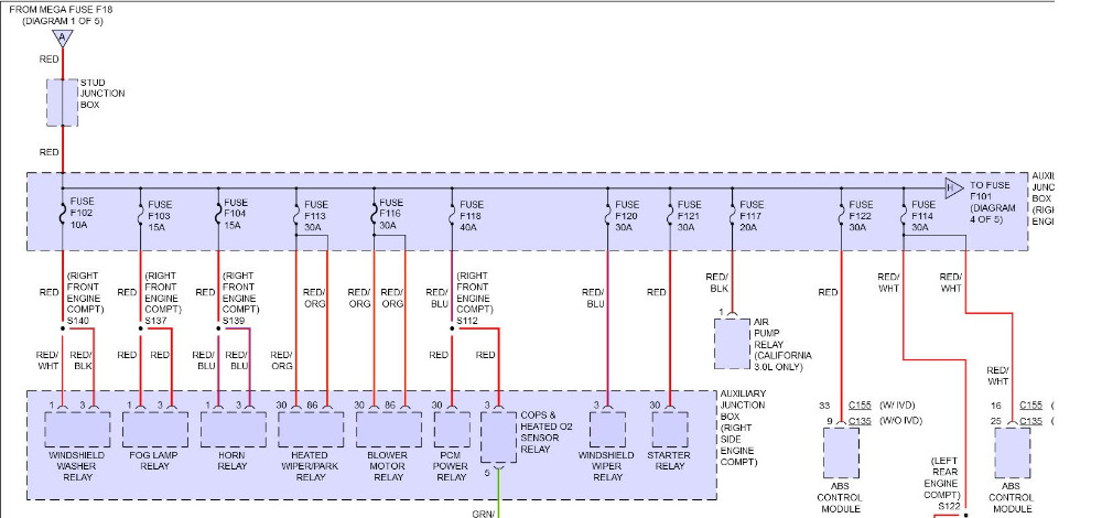

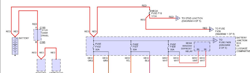

8 years 3 months ago #15521 by Chad
swilson7674 wrote: Also what do I do if fuse 121 is not hot at all times?
Fuse 121 gets its power from MEGA FUSE F18
  • swilson7674
  • swilson7674's Avatar Topic Author
8 years 3 months ago #15576 by swilson7674
Replied by swilson7674 on topic No Click Crank or Start
The car cranked when I applied power to the gray wire. What does that mean and what next?
8 years 3 months ago #15577 by Chad
It means that the relay, the starter, and fuse 121 are all good.
Next, verify FUSE 201 is good and has battery voltage when turning the key to the "START" position.
The following user(s) said Thank You: swilson7674

8 years 3 months ago #15635 by Chad
If it does NOT have power, it mean you need to check for power going INTO the ignition switch.
If it DOES have power, it means your ignition switch it OK. Move on to the DTR. With the key in the START/CRANK position, do you have power at the gry/org wire goin INTO the DTR on pin 10? Power coming OUT on the GRY wire on pin 12?
