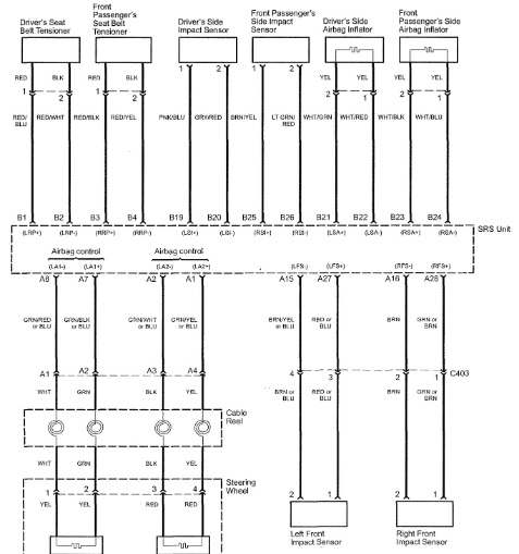

9 years 4 weeks ago #11552 by Tutti57
'05 Acura TSX DTC 54-50 was created by Tutti57
This one says "Internal failure of the SRS unit."
I feel like I remember that one means I need to replace the module. Is there a way to test these things?

9 years 4 weeks ago #11566 by Tyler
Replied by Tyler on topic '05 Acura TSX DTC 54-50
Yeah that sure sounds like a death code to me. :( Is this a hard failure? Or, does it come back intermittently?
If it comes back immediately, then I'd suggest testing module powers and grounds. I attached the ABS wiring diagram for reference. B+ on pins 1, 16 and 38. Ground on pins 32 and 47.

9 years 4 weeks ago #11571 by Tyler
Tutti57 wrote: How exactly do I test those pins?
Thank you. You are always super helpful!
I try! :lol: I'd go with a backprobe and an incandescent test light, KOEO. A DMM with work, too. Check the powers with the test light connected to B-, and the grounds with the light connected to B+. If they all shine bright, then it's module time.
I just noticed that you attached the ABS diagram and I am having trouble with the airbag light.
Is it throwing a specific code? I get these from the BBB Industries site , FYI.

9 years 6 days ago #12387 by Tutti57
Replied by Tutti57 on topic '05 Acura TSX DTC 54-50
So I just put in a used module and figured the srs light was still on because I haven't programmed it yet. I found 4 stored dtcs that I cannot delete. I'm guessing the car I got it from was in a crash and these are the codes from that car?
Now I think I'll have to send the module out to be cleared and then reinstall.
Doesn't all of that sound right?
61-10 open in the driver's seat belt buckle switch
31-10 open in the driver's side airbag inflater.
F1-11 Drivers airbag and/or drivers seat belt tensioner and seat belt buckle tensioner deployed.
F2-22 Front passengers airbag and/or front passengers seat belt tensioner and seat belt buckle tensioner deployed.

Man, I didn't think of this. The three codes I just posted about are now gone, but there are three new ones. 44-20, 45-20, 46-20 all stating - internal fairlure of the right side impact sensor (first), Internal failure of the right side impact sensor (second), internal fairlure of the left side impact sensor (second).
My best guess is that the bad module didn't detect the sensor issues and now the good one does. Does that make sense?
8 years 11 months ago #13438 by Tyler
Replied by Tyler on topic Re:'05 Acura TSX DTC 54-50
Never ends with this one, eh? :lol: No offense meant, but are you sure about those code numbers? I just did some quick Googling, and found this list:
honda-tech.com/forums/tech-misc-15/full-srs-code-list-3111979/
It doesn't show codes 45 or 46, but the list could be BS. Mostly, I found it interesting that the code list shows separate codes for signal interruptions to the side impact sensors, and codes for internal failures. :huh: This would suggest to me that the module and sensors are capable of checking their own wiring. I'd have to check Mitchell to be sure.
I'd suggest moving side impact sensors from one side of the vehicle to the other, but you've got codes for both sides! :lol: I had a look at the wiring diagram, too, and (supposedly) the two side impact sensors don't share any connectors:
I just have trouble understanding why BOTH sensors are coding. :blink: One or the other, I understand, but both seems suspicious.

Yeah, I was wondering why that would be the case too. This one is my personal car. I bought it out of state and there were no warning lights on during the test drive but on my way home the srs light came on. I also noticed a couple of small pieces of glass on the passenger seat. It made me wonder if it has been crashed or just a broken window. I was trying to figure out if these were the front sensors or side, thinking that it just meant right-side, meaning the right side of the car in the front. The parts diagrams seem to call them front and rear. If both fronts deployed that would make more sense than both sides.
8 years 11 months ago #13466 by Tyler
Tutti57 wrote: I bought it out of state and there were no warning lights on during the test drive but on my way home the srs light came on. I also noticed a couple of small pieces of glass on the passenger seat. It made me wonder if it has been crashed or just a broken window.
I've been wondering about this, too. :lol: I couldn't figure why all the components would suddenly decide to fail while driving down the road. If they were damaged in an accident, then the SRS module should figure it out within seconds of turning the key on. :blink:
That really sucks this happened to your new (to you) car. :-( Private seller?
I had the same thoughts while looking at the diagram. Both side impact sensors going bad makes almost no sense to me. :unsure:
Just thinking out loud here, but are you confident in the people that fixed the airbag module? I'm mostly wondering if that same module is used in multiple vehicles, and there's some kind of programmed configuration inside that determines what sensor signals it looks for on which pins. i.e. the impact sensors may be working on your '05, but the module is setup as an '07, which used different sensors.
That's just an example, and I may be way off. :silly:

I've never used the place before but they seem to be a popular source for the repair. Supposedly it's the same module I sent them.
I saw that there was a opds initialization option in my scan tool but it looks like that's for an occupancy sensor or something. I couldn't find anywhere that the module had to be programmed and didn't see an option in my tool like I usually do.
I'm not sure if measuring the resistance of the sensors would help in this case? I found some specs but don't know if that is a valid test for these "internal" faults.
I'm tempted to replace one sensor and see if one of the codes drops off.
