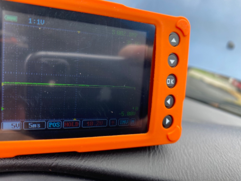

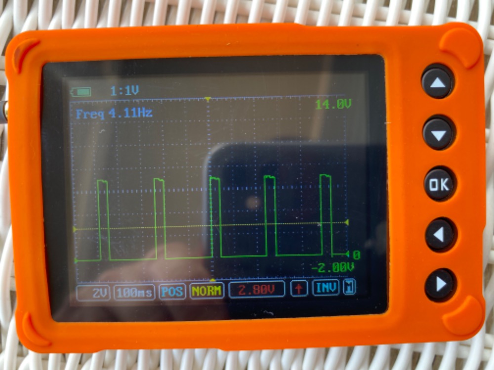

Ok, this morning I attached the Uscope to both coil signal inputs. Both of Them read the same thing.  Them read the same thing.
2 years 2 months ago - 2 years 2 months ago #66403 by Monde
Replied by Monde on topic Turns over, no start, no spark, no dtc’s
The controls look fine. We just now need to see if the controls are maintained when the vehicle stalls. If they do, we do the same for power and ground. If power and ground are maintained , we put a coil in it.

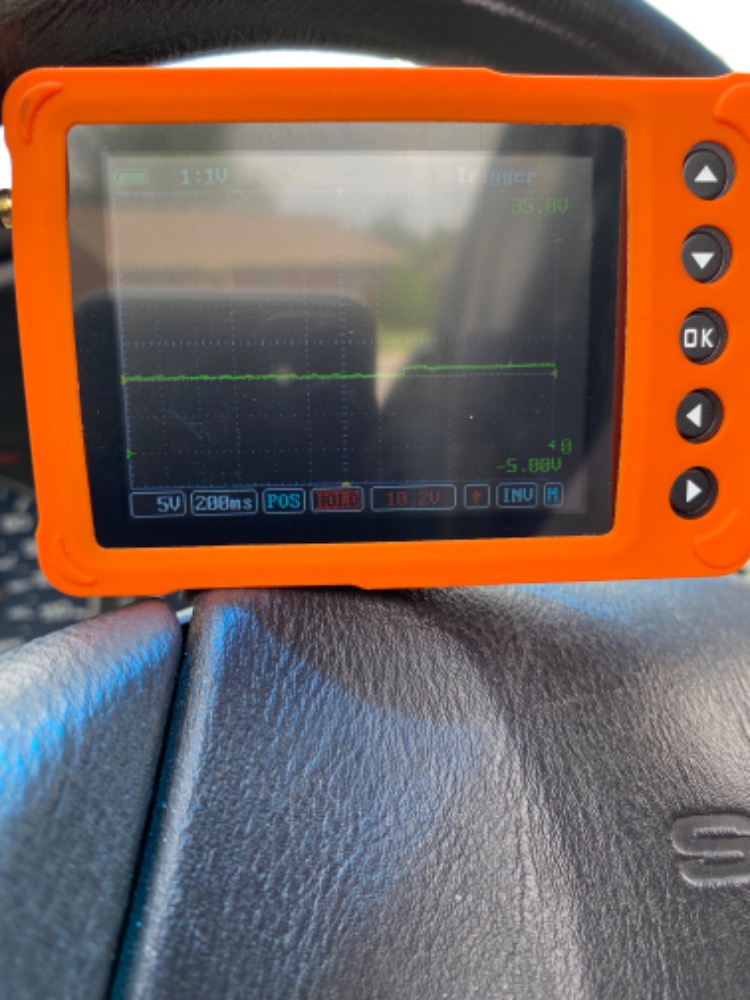

I left out a few things. The engine cranked but no start and no spark. Power to coil dropped to 10.8 VDC at start.
  • Buckeye57
  • Buckeye57's Avatar Topic Author
2 years 2 months ago #66405 by Buckeye57
Replied by Buckeye57 on topic Turns over, no start, no spark, no dtc’s
What is the setup to read power and ground.
2 years 2 months ago #66407 by Monde
The same way you check the signals/controls wires. One lead to ground and the other lead to power and repeat the same for the ground wire.

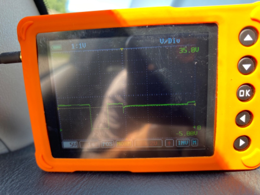

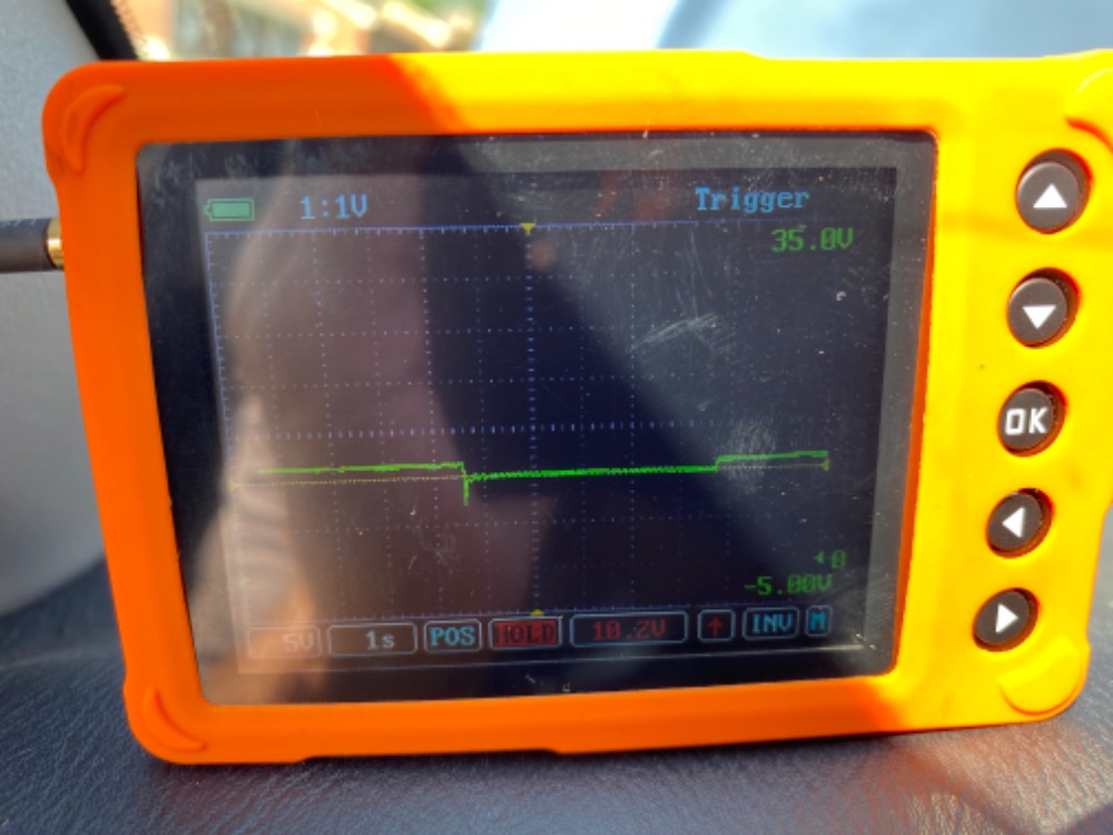

2 years 2 months ago #66408 by Buckeye57
2 years 2 months ago - 2 years 2 months ago #66409 by Monde
It looks as though you took the measurement on a 5v scale and not a 20v scale.
Are you sure that the coil is OEM? Can you get the shop to return it and get a new one?

The 10v setting doesn’t show anything. The 5v per graduation works.
2 years 2 months ago #66416 by Monde
I am not too familiar with Uscope. As long as you don't have any glitches when checking the control wires, power and ground, it may be time for you to try another coil.

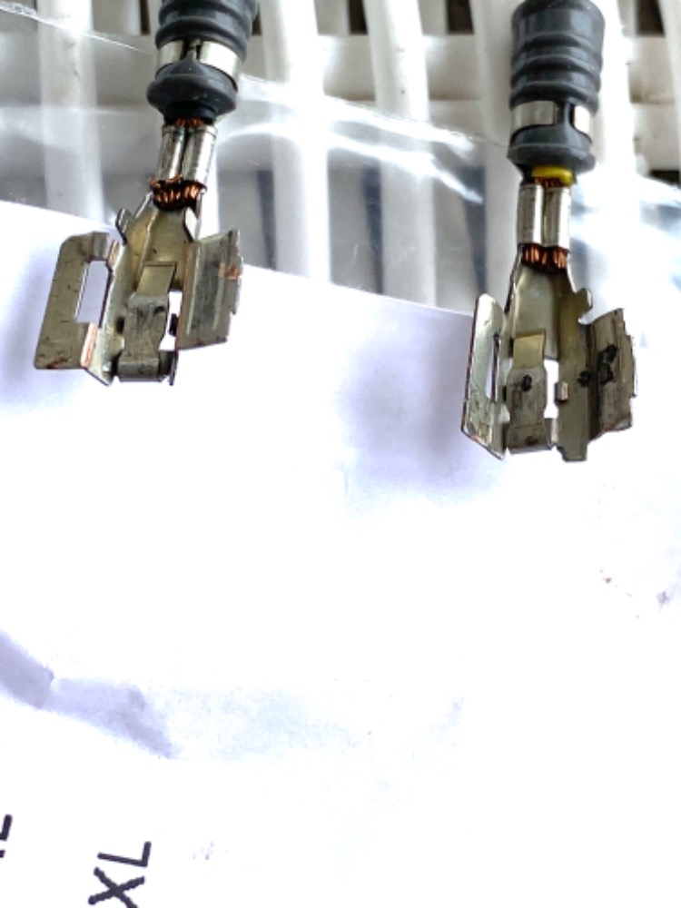

2 years 2 months ago #66552 by Buckeye57
The connector pigtail arrived yesterday and this morning I installed it.
I performed an autopsy on the old connector. Being the no start and not a misfire, the power and ground was what I removed and splayed open . As you can see in the picture, the black ground connection was good, but check out the yellow power. Looks like burn marks on the top and bottom contact surface.
I feel confident that this was the culprit.
I will run errands today and will keep you posted.
I want to thank you for your help. It is always better with more heads involved.
Tom
2 years 2 months ago #66563 by Monde
Thank you for the update. It looks like the connector was the issue. If the car has been running fine since the last time you posted, I would call that a fix.
