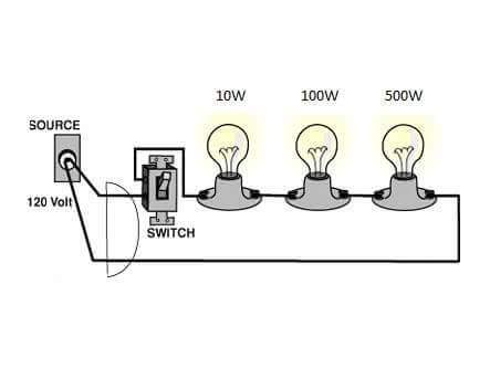

Ok here's another one, saw it on FB .... Just thought I'd share it here :)
In the diagram below which bulb(s) glows brightest and why?
10W, 100W, 500W, equally....

Ummmmm, the 10W? :dry: :huh: I have no idea at all. :lol:

I will go with Tyler on this one, the 10w will be the brightest. The why would be it has the most resistance and the other two would have less current flow. (crosses fingers)

Thx for answering guys and of course you are correct :)
The 10W has the highest resistance and so it will have the biggest voltagedrop and shine brightest. Current is the same in the whole circuit since it's in series. Some ohm's law will tell us that. When I saw this on FB I scratched my head at first :blush: :)

First of all, LET'S POINT OUT THE OBVIOUS MISTAKES that Technically make this impossible to solve without certain Assumptions
1. We do not know the polarity of the Voltage Source
Meaning we don't known if it's AC or DC
2. We do not know the direction of the current
Meaning we don't know if we are using ELECTRON FLOW THEORY or CONVENTIONAL CURRENT FLOW THEORY
3. also since we don't know the direction of the current.
WHY ARE YOU ALL ASSUMING THAT IT'S RUNNING TO THE SWITCH FIRST.
Why can't you assume that it's running to the 500 W Globe first and therefore
the answer is the 500 Watt Globe (Technically , based on the lack of detail in the diagram
you cannot disprove this answer) but, it is Facebook.. so.. yeah.. ok
Let's just assume that it does go to the Switch first
4. We are not given the resistance of the switch
5. We do not know the resistance of the wire itself
SO LET'S MAKE THESE ASSUMPTIONS so no one has a heart attack
we are dealing with a 120 V DC (Direct Current) Voltage Source
We are using CONVENTIONAL FLOW THEORY (meaning, we are going from a High Energy level to a Low Energy Level) because it's easier to understand
We are making the assumption that the wire from Source to Switch is Positive (+)
We will assume that the switch has 0 ohms Resistance
We will assume that the wire has 0 Ohms Resistance
OK
THIS IS WHAT WE KNOW
We have 120 V DC
we have 4 Globes 10 Watt 100 Watt 500 Watt
Now,
STEP 1. Identify the circuit as Series or Parallel
ANSWER : this is a Series Circuit, because there is only 1 path that the globes / Resistors are located on
and there are no Nodes in the Circuit
GUYS, from here on i'm going to call the LIGHT BULBS "Resistors" OK
because Electrically speaking, they are

so when you deal with Series Circuits
- EACH Component in series has the MAXIMUM Current Running through it and the circuit
- EACH Componen will have a REDUCED VOLTAGE
Meaning
the series Circuit starts with 120 Volts
we assume no resistance in the switch
we assume the switch is in the CLOSED CIRCUIT POSITION
as the Current Enters the First Resistor, Voltage is 120 V DC
as the Current Leaves the First Resistor there will be less Voltage
if we call the first resistsor (R1) and the second Resistor (R2) and the last one (R3)

VS = S - R1-R2-R3
or you could say
VS = S - (R1+R2+R3)
THIS IS CALLED SIMPLIFYING A CIRCUIT
if you have 3 Resistors in Series
you can add the sum of the resistors to create what is called an "Equivalent Resistance"
(ER)
so by the same token you can add up the total wattage in a series circuit to create EQUIVALENT WATTAGE
(EQ)
hence we can say that we have EQ = 10+100+500
hence EQ = 610 Watts

we have
120 Volts DC
610 Watts
so if we have 2 Values , we can solve for the third
SINCE CURRENT IS CONSTANT THROUGH A SERIES CIRCUIT
let's find the current
The formula according to Ohm's law is
Watts = Volts x Amps
W = VA
or
W = V x A
but we want amps
so it's
Amps = Watts / Amps
Amps = 610 / 120
Amps = 5.083 Amps
