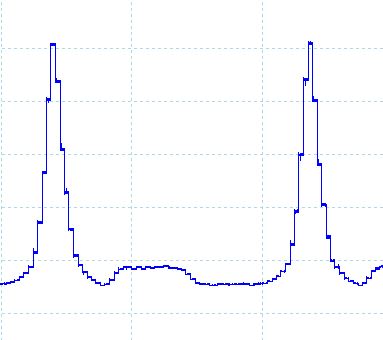

7 years 10 months ago #24314 by Sooknanan
Replied by Sooknanan on topic Re:DIY Pressure Transducer
I calibrated it with a fluke pressure tester.
Accuracy is good I believe the transducer output signal is maybe too slow as previously discussed.

7 years 9 months ago #24368 by Sooknanan
(null)
Your waveform had the same issues as mine.

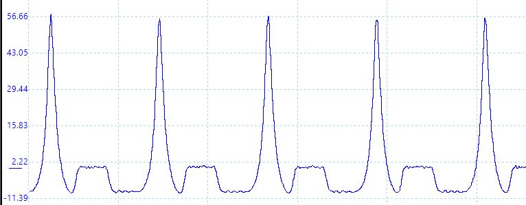

7 years 8 months ago #25196 by Sooknanan
Just an update with this PT dilemma. I bought the transducer posted on page 1 from ebay. It was worst than my original, it couldn't read anything under -3 psi so basically there was a flat line at the bottom of the waveform. The problem with the pic I posted before was, I didn't set the look up table to read vacuum pressures. I messaged a youtuber about the transducer he used and he said most new transducers having this same issue. You would have had a better chance of a quality one a few years ago.
So I tried a 0-100psi on running compression to compare to the 0-300 and it was similar.
After some filtering with the 0-300psi I got this. I will settle with this for now since the waveform is still readable.

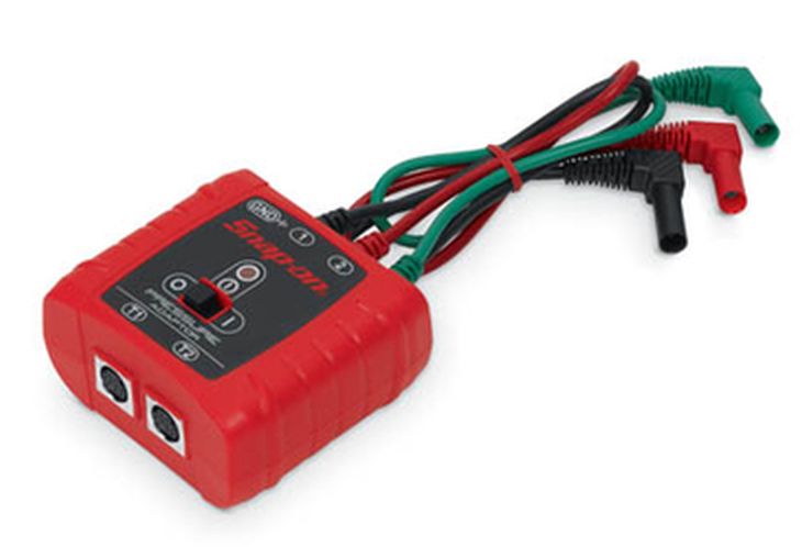

7 years 5 months ago - 7 years 5 months ago #28171 by tloftis
Replied by tloftis on topic DIY Pressure Transducer
I guess for my Snapon Modis I will have to build this:
Description
• Adapts standard meter jacks to EEPV302AL, EEPV302AT and EEPV302AH pressure transducers (not included)
• Provides connection of transducer plug to standard meter jacks, and provides power to the pressure transducers
• Use up to two transducers simultaneously
• View results on VERDICT®/MODIS® Ultra/MODIS® Edge/VANTAGE® Ultra/M2 Meter
I am too cheap to buy one LOL Will have to sourse everything. see attached image
