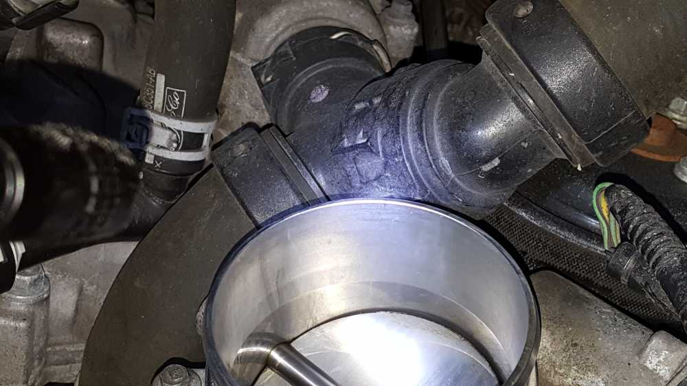

9 years 2 months ago #4609 by nick.elias
Replied by nick.elias on topic Finding a blown head gasket
Bad head gasket... this morning i found a coolant leak at the junction above the coolant pump. Mustve leaked out on the last guy and overheated
  • nick.elias
  • nick.elias's Avatar Topic Author
9 years 2 months ago #4610 by nick.elias
  • nick.elias
9 years 2 months ago #4612 by nick.elias
Ar first i thought it was coming from my pump but the belt and tensioner were also wet. No coolant in my reservoir. Bringing it into the dealer thurs

  • nick.elias
9 years 2 months ago #4615 by nick.elias
Looks like this tool works though!!!
Luckily i shelled out big money for the ford power train warranty. Well see if they do it willingly or if i have to be a dick about now.

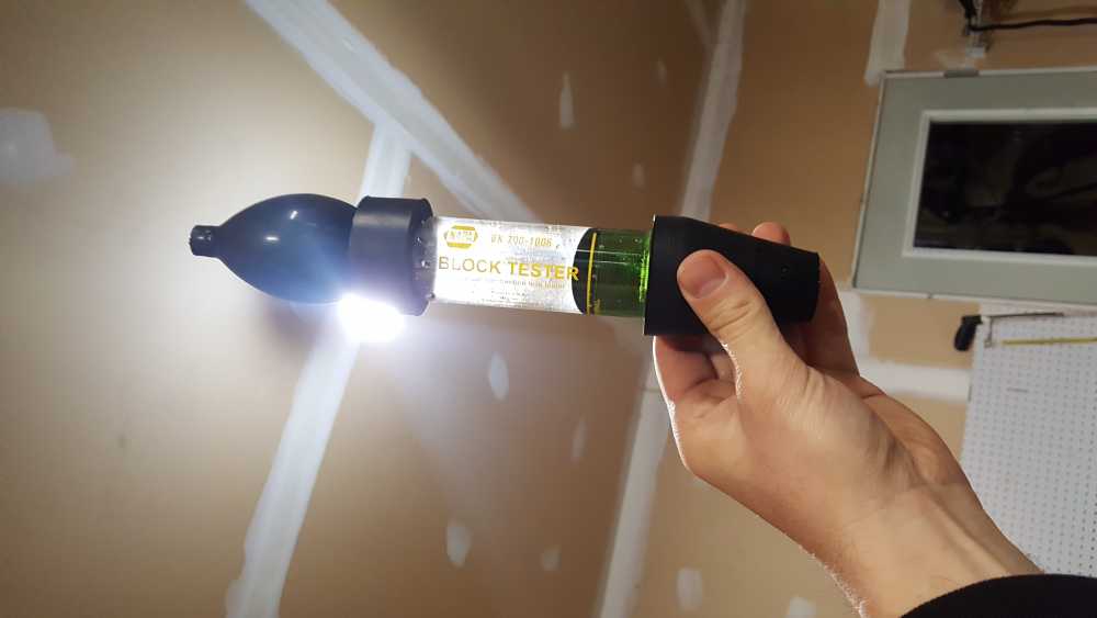

  • nick.elias
9 years 2 months ago #4635 by nick.elias
Guys like paul says, he tries to find as many paths as he can that lead him back to the same destination, so i stopped in at the nearest NAPA and got a block tester as well. And results were positive as well! Im convinced this tool works now. Im going to keep both on my arsenal just in case. Also my neighbor has the same truck and he had the same results!!!! I wonder of FORD moght have a big recall in the future
