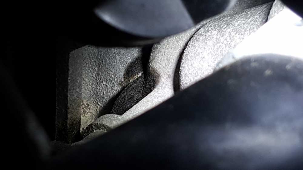

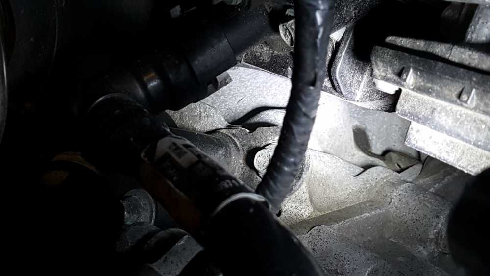

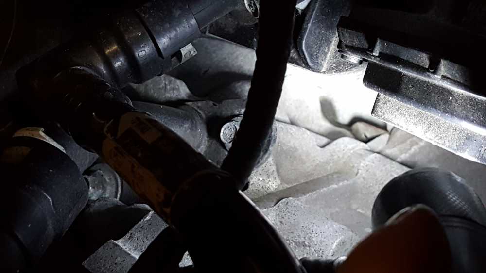

9 years 10 months ago #4910 by nick.elias
Replied by nick.elias on topic 2014 F150 5.0L misfire
Hey everyone.... so i havent gotten all my materials for the pressure transducer yet but i made an interesting visual diacovery on my truck. Check out these pics.
If you look carefully you can see soot at the head gasket mating surface. Looks like a blown head gasket to me. It might be time to be an asshole to dealership
