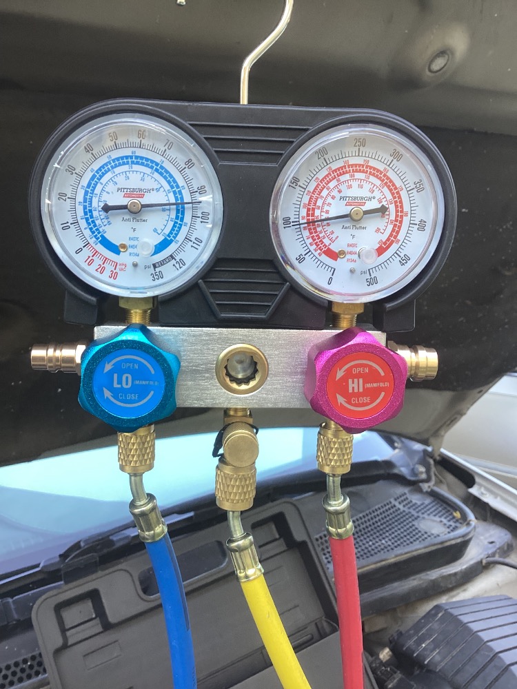

2007 Honda odyssey 3.5 v6.. wife did take it to the shop to service the ac.they evacuate the air and moisture for about 50. Minutes then proceded to recharge it.
Only to find out that the rear ac only works when you are driving,and when slowing down and stop
only blows warm air
the front ac only blows warm air too
question,can I reset it with a scan tool ? Have an auteul scanner
or perhaps is the expansion valve or the evaporator,because the ac clutch kicks in when you activated the ac control
thanks and God Bless you all ,,,

Hey Chad,how are you ? Sorry if I am slow ..I am no mechanic,I am a truck driver for the past 23 years over the road for 5 to 7 days,3500 miles a weeck
But I have to step in,when the so call mechanics in this town are lazy or not wanting to do the job.

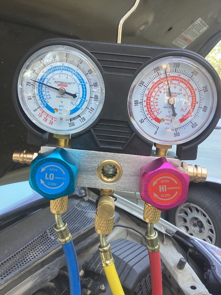

the first readin is w/ engineer off the second reading is w / engineer on and ac on, and the ther reading when I turned the rear ac
- Aprendiendo369
- Posts: 12
2 months 3 weeks ago #93181
by Aprendiendo369
Replied by Aprendiendo369 on topic Bad expansion valve or evaporator ?

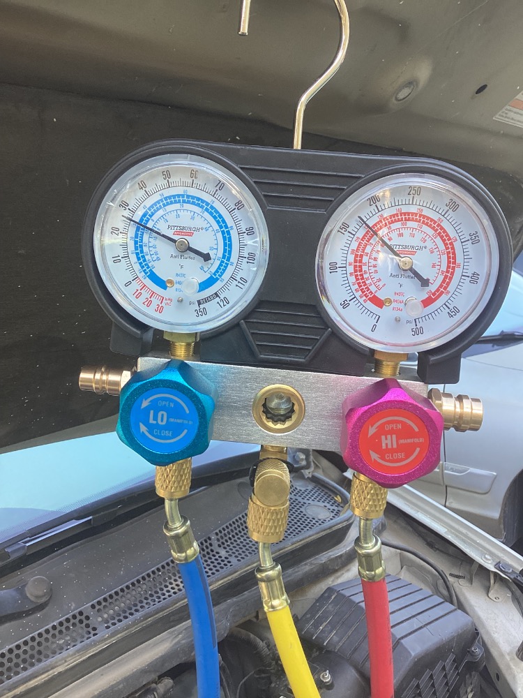

The second reading is W/ engine on and the ac at max
The third is when I activated the rear ac full blast
I really thank you for your help

2 months 3 weeks ago #93182
Replied by Chad on topic Bad expansion valve or evaporator ?
With those pressures, you should have plenty of cold air.
Is the 'warm' air warmer or cooler than the ambient air temperature? Do you have any control of the temperature coming from the vent, at all? Does adjusting the temperature control to full heat give you HOT air? Or, is the temperature a constant "warm", no matter what position the temperature control is set at?About the front ac ? Is blowing only warm air
