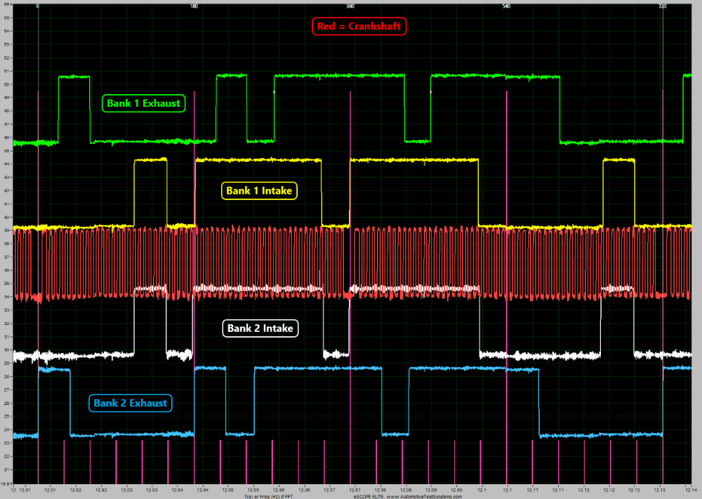

anyone have a known good wave form for a 2016 Chevy Colorado with a 3.6
3 months 3 weeks ago #92770 by Chad
Replied by Chad on topic 2016 cam and crank wave form known good
