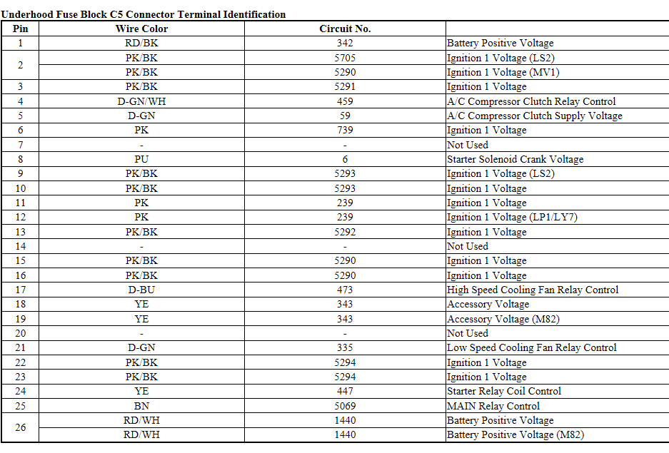

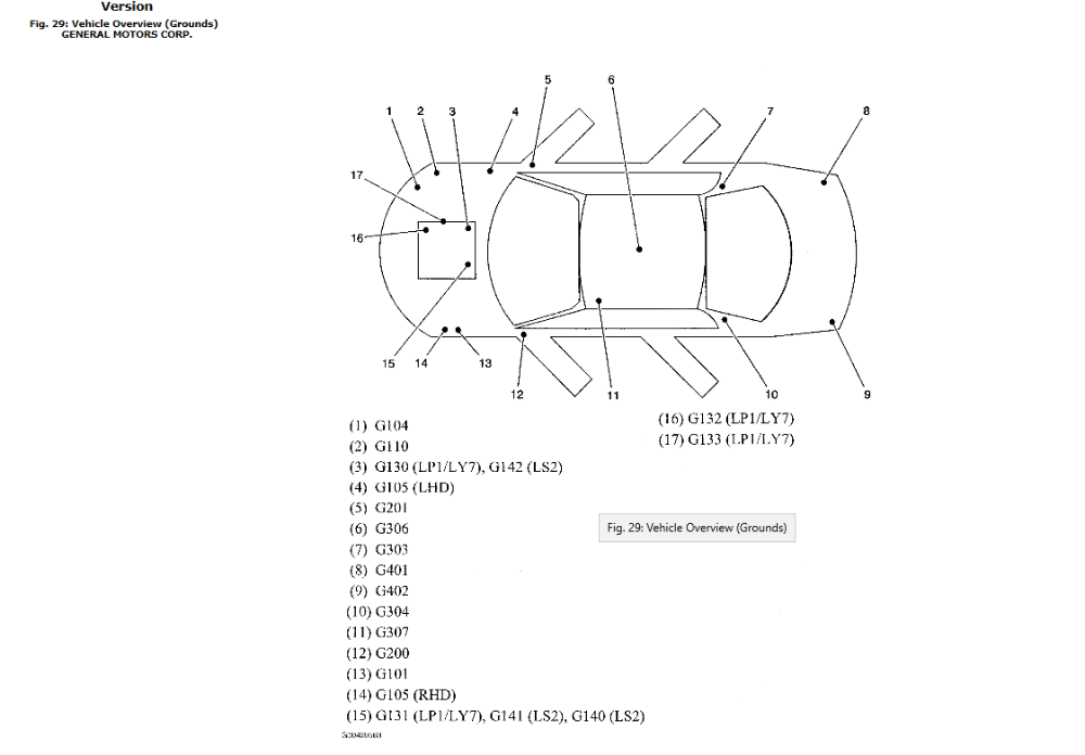

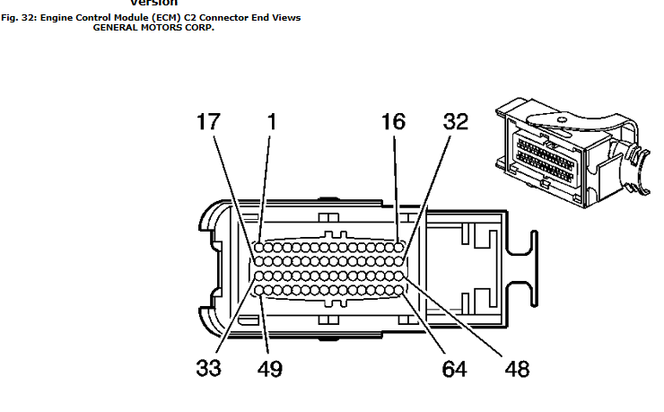

7 years 9 months ago #27370 by Marti
Ok , here are some screen shots from Mitchell1 to show if it's the same service as the one you use.
I think the information is great on this site but It's difficult to keep track of where things are located. Perhaps there precautions for not letting people copy large portions of the site and selling the info... but there are a few things that would improve the continuity of using the site for different sessions. I hate when you let it sit idle too long and it automatically times out, then you are spending time trying to get back where you were....

7 years 9 months ago #27402 by Marti
I also posted a problem that I have been unable to resolve in about a month of trying, on my 2007 CTS base with 2.8 liter. The data system is set up in what they call a hybrid star type, having both the single line GM Class 2 data line to most of the modules, and the high speed GMLAN (twisted wires) for the ECM and TCM. The resistance is 60 ohms on that system. I lost some of the IPC's gage info (gas level and ECT) and began having more difficulty with the key not being recognized so I replaced the ECM with a junkyard ECM that I pulled myself (similar VIN and setup as my car). Now my gages are back but still I can't reprogram for key recognition although my scanner is a two way communication type and I have input VIN info before. My scanner can obtain some data from the ECM but when I look at the ECM's ID info I get an error "no communication". The advise I got from the repair forum was to take it to someone with a Tech2 and an active subscription in order to reflash and change the VIN. My problem is that with no communication to the ECM I'm likely to be charged a lot of money to troubleshoot the no communication issue before I can get the VIN changed on the junkyard ECM. I've looked at the Class 2 data line with a scope and it shows communication with square waves at about 6 volts peak. I've pulled the 3 splice packs on the Class 2 data line with no success on getting the ECM to show ID using my scanner. Perhaps you could give me a short call to discuss?
