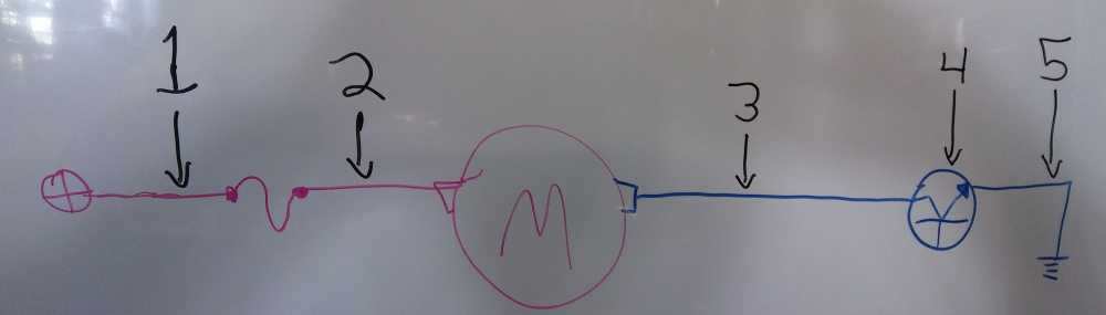

9 years 8 months ago - 9 years 8 months ago #6956
by SniperDan
To better illustrate this, we can look at this crude, kindergarten level drawing I made. This is a simple series circuit, with a motor in place as the load. This load is controlled by a transistor (driver).
A short to ground at point 1 would melt through the wiring as it is not fuse protected.
A short to ground at point 2 would blow the fuse, as current flow would overload it and blow it.
A short to ground at point 3 would energize the load without blowing the fuse ( a motor in this case)
A shorted driver at point 4 would also energize the load (if the emitter and collector were shorted together anyways)
A shorted driver at point 5 would have no effect on the circuit, as everything to this point is grounded all of the time.

9 years 8 months ago #6979
by GeekDIYMechanic
Replied by GeekDIYMechanic on topic Short to voltage and short to ground / fuse
A fuse will blow if it experiences current flow greater than its rating. So, if a short occurs causing excessive current to be experienced by fuse it will blow.
Let us assume a simple switched load circuit (ground side switched/pull down circuit),
power source -1> fuse -2> load -3> switch -4> ground
Some scenarios:
If somewhere in 1 there is a short to ground, you got big problems since there is no protection for the battery and wires. This will have full battery current to flow to ground, really, really bad.... The wires would melt and maybe cause a fire due to the amount of heat caused by this condition. This is why fuses are usually very close to the battery/power source.
If somewhere in 2 there is a short to ground, you will blow the fuse. Why? There is no load between power source and ground. Therefore max battery current will flow to ground causing the fuse to blow, but in a safe manner. No fires. Just that the fuse would keep blowing when replaced.
If somewhere in 3 there is a short, the load will stay on, regardless of switch state(on/off). And the fuse would not blow. What?? Why? Because there is a load between voltage source and ground. Think of it this way. Is there a difference between this ground/short and the switch providing ground? Nope.
If somewhere in 4 there is a short, you might not notice anything unless the ground isn't very good. The switch would control the load, and the circuit behavior would probably be good.
I have simply explained this so with simple explanations some details are left out. But the moral of the story is that you need exceeding current flow of the fuse to cause it to blow. So, it depends where the short to ground is, before or after the load.
In addition, some of your confusion is caused by the type of circuit you are dealing with, ground side switched or power side switch. Again, these circuit only differ on the location of the switch/control (before or after the load).
And yes, when debugging a circuit, I always verify common components that fail before assuming the world has ended, resulting in me having to take the car apart. LOL. So, I check fuses, relays, switches, loads, .... first.
I hope this helped.
