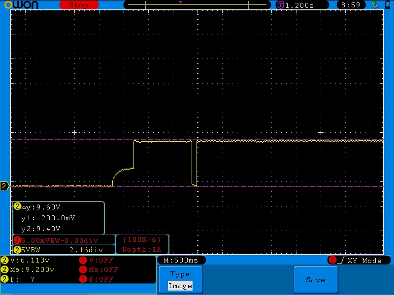

I don't anything about the internals of the actual modules except not to turnover or jar the modules when they are powered up.
On all the euro cars I have worked the airbag module puts a 12v pull up voltage to the instrument pack cluster to extingish the dash light
Side and front impact sensor are prone to corrosion damage, I have no idea about the internals of these units (I really should cut one open) except they are smart sensor and the airbag module looks for a very distinct self-test response from the sensor Paul did a video on a corrosion damaged front impact sensor on a GM pick-up.
This is a known good I caputered from a 2003 MG ZT/Rover 75 it has the same SRS MRS system as the BMW e46
www.scannerdanner.com/media/kunena/attac...450/sideimpactlh.jpg
GM Taho Front Impact Sensor
