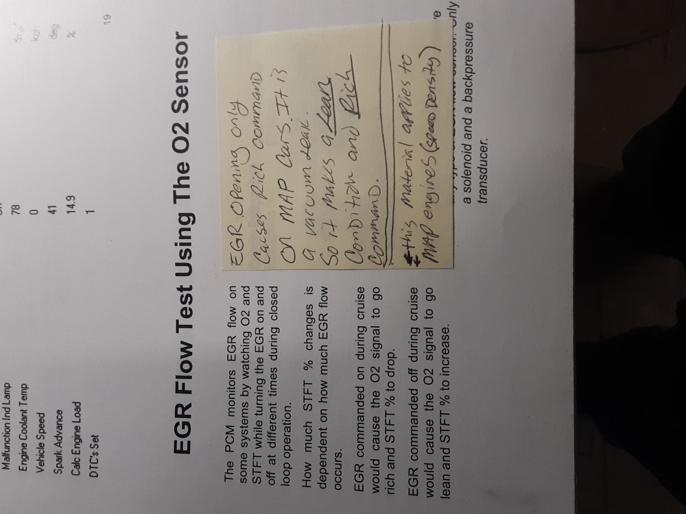

Section 4 page 10. It says that EGR command during cruising would make O2 Rich.
I'm pretty sure opening the EGR at idle kills the engine, I thought from leaning it out. Does it make a difference if it's opened during idle vs cruising?

Gotcha. Increased manifold pressure making ECM think it's a load?

ExactlyTutti57 wrote: Gotcha. Increased manifold pressure making ECM think it's a load?
