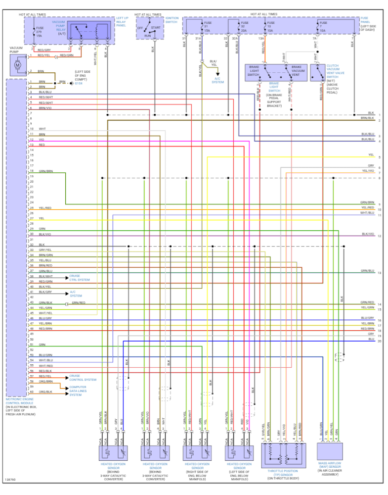

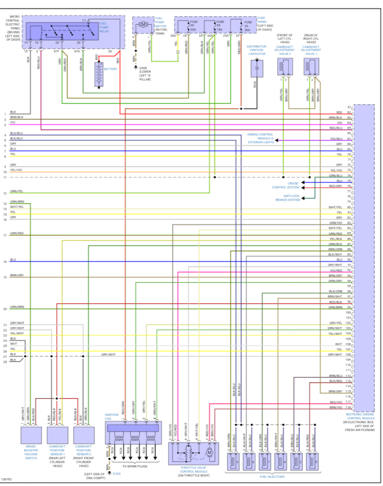

Also, watching “WASTE SPARK IGNITION TESTING - PRIMARY CURRENT (AUDI A6) PART 1“
Time 22:58 test light illuminates on 2x wires, one back path return to ground thro fuel pump. A schematic is briefly shown but it’s not fully displayed. I was wanting to ask if someone could share the schematic again to visually study and learn the ignition system and how the wire is tied to fuel pump.

I'm having trouble finding that video. If you would please post the link will be happy to look for the diagram for you.

www.scannerdanner.com/scannerdanner-prem...d2FzdGUtc3BhcmsiXQ==
I believe it's a 2001 audi a6 2.8L V6 30V as these use the waste spark system

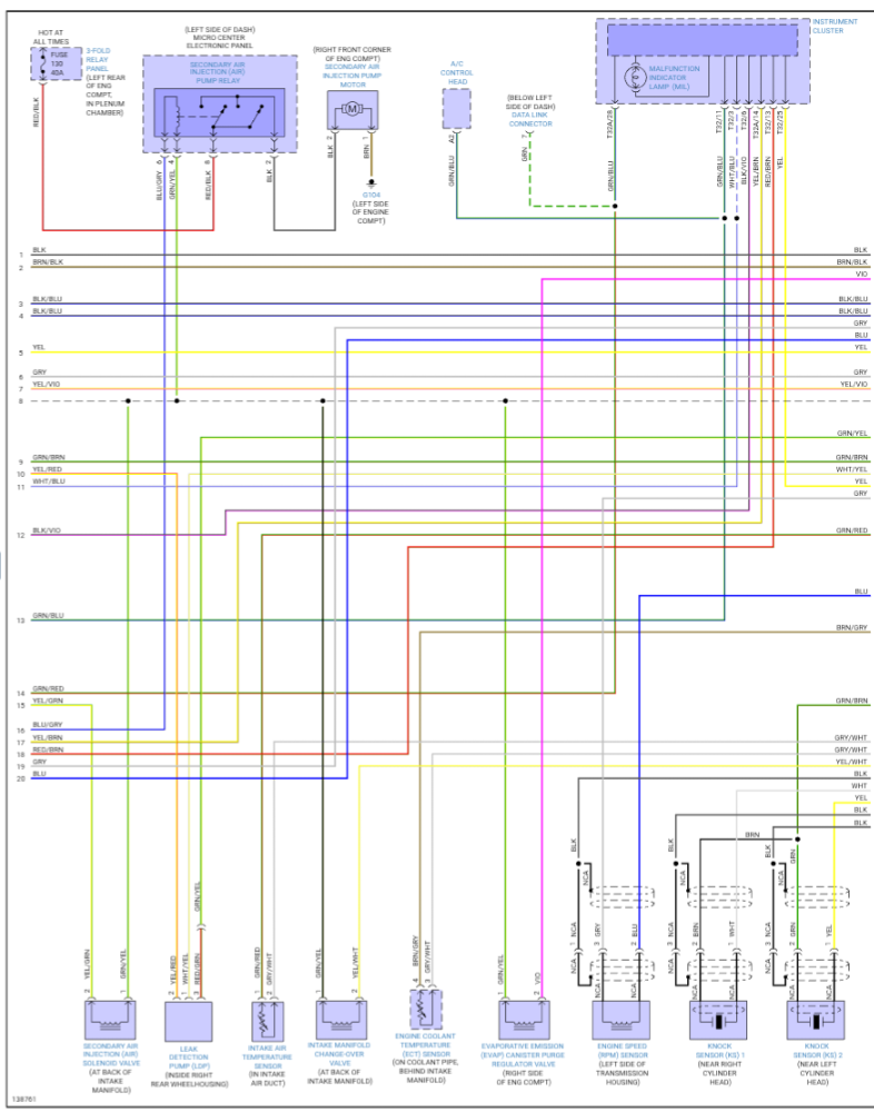

1 year 3 months ago #92125
Replied by Noah on topic Using test light to visually see spark from secondary ignition
The following user(s) said Thank You: CMat10

1 year 3 months ago #92127
by CMat10
Replied by CMat10 on topic Using test light to visually see spark from secondary ignition
Thank-you ! I appreciate it. You have no idea how helpful this was for me to grasp what was going on!
