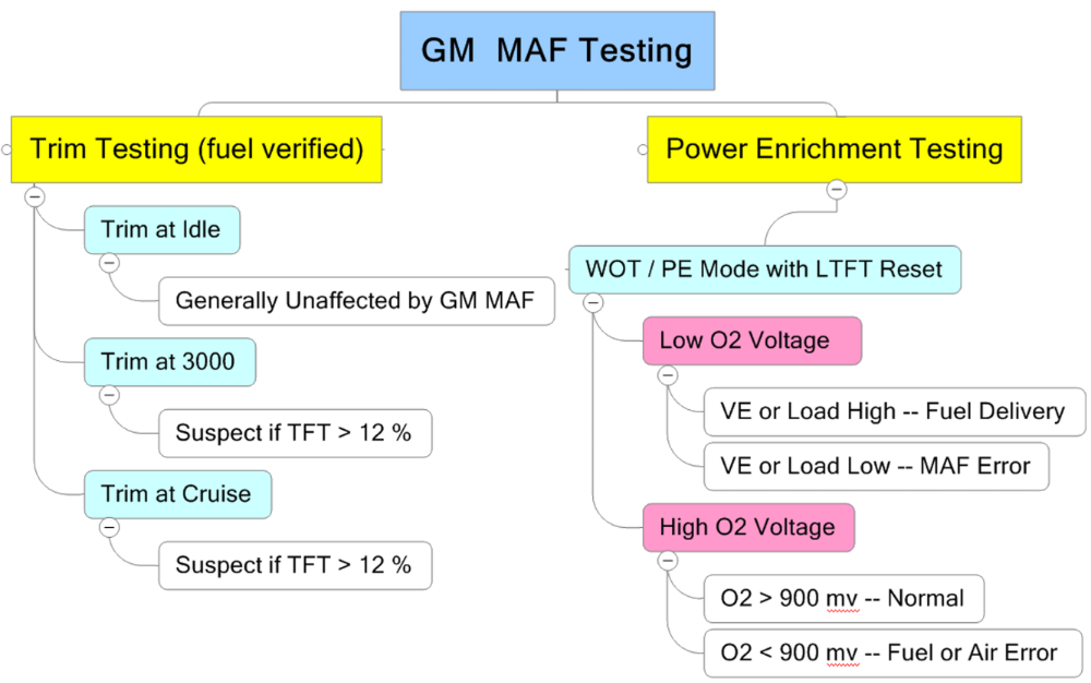

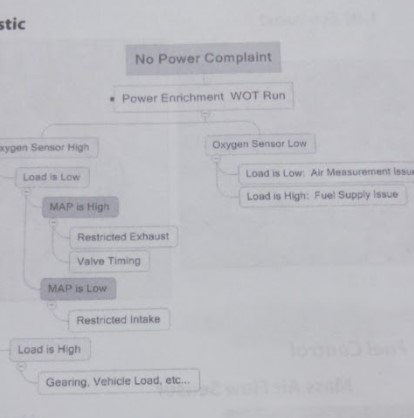

7 years 10 months ago #26030 by Tyler
Replied by Tyler on topic VE Calculations and Lean Codes
Wood, I have a flow chart I found in a training class manual several years ago that might help. I find that it very neatly explains ScannerDanner's approach, while also integrating Calculated Load.
Hopefully that helps! As far as my diagnostic approach is concerned, Load and VE are the same thing. Both are based primarily on the MAF, and both be low in the case of a underreporting MAF or a engine breathing issue. Both will show high if the engine is breathing correctly and the MAF is reporting correctly. Neither can distinguish between a misreporting sensor and a breathing issue on their own.

Awesome, thanks Tyler. I've been diggin through that thread you sent me and there is a lot of good information in there and that flow chart really helps me organize my thought process during these faults.
7 years 10 months ago #26091 by Tyler
No problem! There's another thread that Noah started that may make for interesting reading:
www.scannerdanner.com/forum/scannerdanne...8-low-power.html#933
Short story, I installed a intake restriction in a Chevy truck, and that flow chart pinned it down. B)

Yep, I made that with Mind Manager back in... 2004? I was a speaker at the first CAN conference in Chicago and made it for that.
Sharing it is fine, but I only see part of it in your post.
7 years 6 months ago #29489 by Flatrater
Replied by Flatrater on topic VE Calculations and Lean Codes
I massaged this quite a bit later. That was a while ago and now there are lots of systems that stay in CL for quite some time at WOT. But the principles are the same. There were half a dozen slides that went with it for context as well.
You might see this in an SMP class as well. I use Mind Manager for mapping out classes and diagnostic procedures.
It seems that a lot of technicians have been steered towards VE testing etc. when a 40,000 foot view would serve them better. As a flatrate drive tech, time was everything if I wanted to pay the bills :)

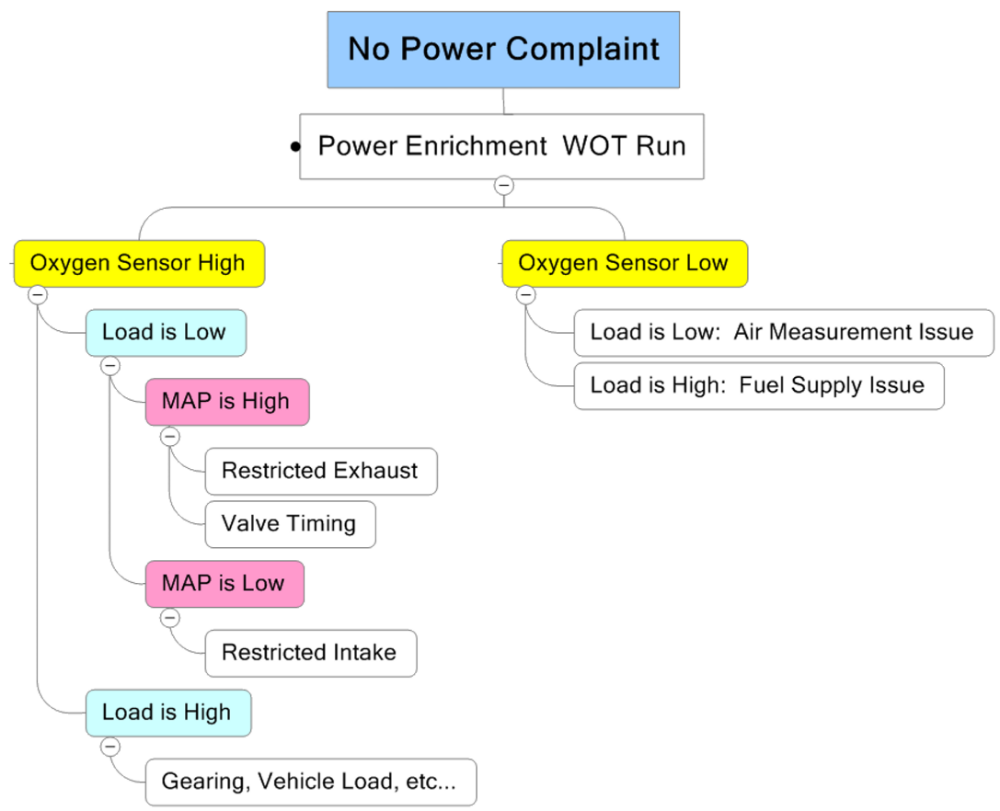

7 years 6 months ago #29490 by Flatrater
Here is another one. Remember, these are about 15 years old and I've refined things. My hope here is that technicians would create maps like this to help them think through problems.
