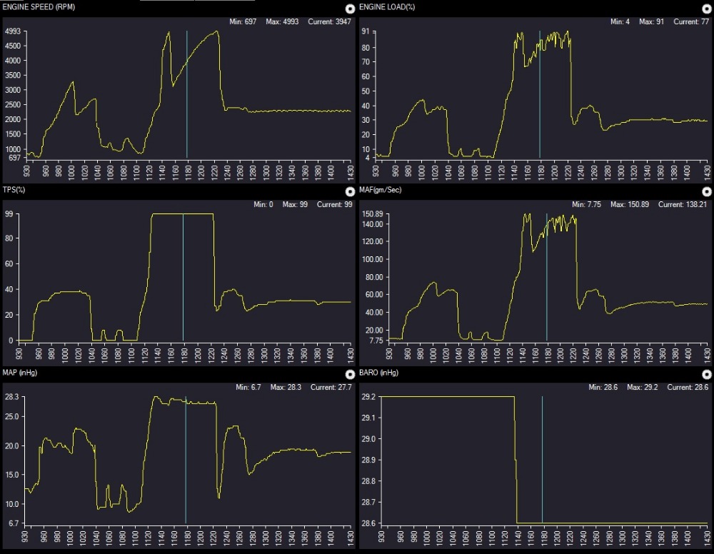

I'm still finding interpreting the MAP pid a bit confusing. When it's up on the screen, the scale is inHg, which looks like a vacuum reading on my handheld vacuum gauge. However, it seems like you have to do some math to get the actual reading, like everything is inverted or something.
Anyone have a good explanation of how to read this?

Your MAP pid is in inHg? What scantool do you use. Maybe you can change that. I agree on the gauge. I also have gauges with this unit and sometimes I have to use a converter. Hell we don't even use psi here. It's all metric

Replied by Tyler on topic 2003 Chevy Avalanche 5 3 Misfire, Restricted Exhaust (Part 2)
If I remember correctly, you subtract the MAP reading from the BARO reading to get the manifold vacuum reading. I've got data from an '03 Blazer for comparison.
www.scanshare.io/share/heEVuXVVWkiYjDa8EEhdSQ
At WOT, the BARO is 28.6 inHg, and the MAP is around 27 inHg. That'd translate to around 1 inHg vacuum, pretty normal for a WOT run. Earlier in the capture, the engine is idling with a BARO of 29.2 and a MAP of 13.2. That works out to 16 inHg, which isn't surprising considering this Blazer had a dead misfire. :lol:
