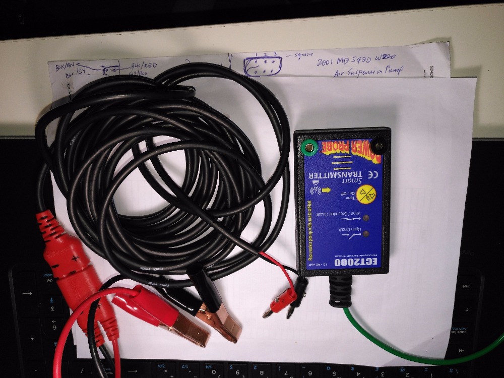

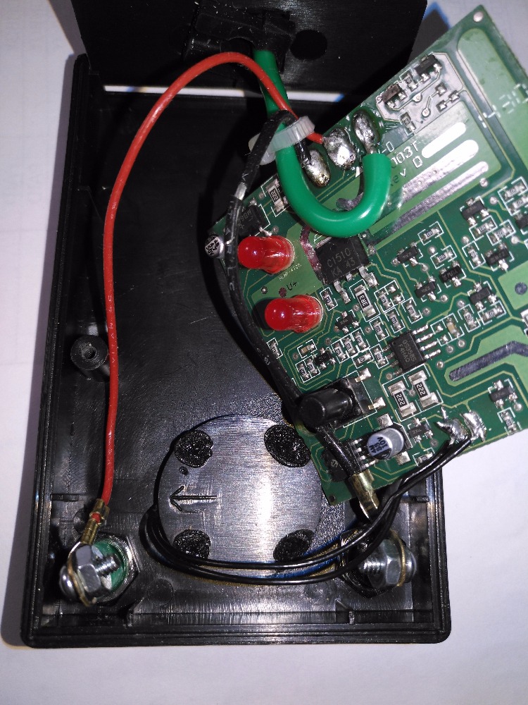

9 years 3 weeks ago #14359 by robert.lesaca
Replied by robert.lesaca on topic Re:Power Probe ECT 2000
For what its worth
in as much as my ECT 2000 is sitting idly in my toolbox, I decided to make the 12 ft long cable as an 12V extension cord of sort...(straight forward)...refer to attached picture
1. unsrew the back cover of transmitter; desolder the black and red wire from the inside the transmitter's circuit board ;
2. from the tip of the desoldered red and black wire, I soldered a red male plug into the red wire and a black male plug to the black wire; this will serve as your extension cord;
3. in place of the desoldered red and black wire in the circuit board, solder in its place a a short red and black wire respectively;
4. drill a hole big enough to fit in a female plug for the red and black tip of your converted extension cord; solder in the red short to the red female plug and black wire to the black female plug. The purpose of doing this is to make your transmitter still a functional one in case you decide to use it.
