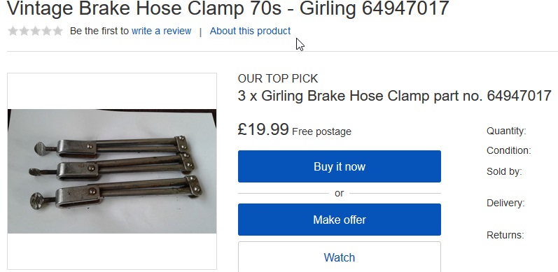

9 years 2 months ago #12464 by Andy.MacFadyen
Replied by Andy.MacFadyen on topic Brake bleeding
Clamping a brake hose with the proper tool without excessive force won't cause any problem the first company to sell brake hose clamps (at least in Europe) was major brake brake manufacturers Girling ( the same company who along with Dunlop invented the hydraulic disc brake.) among the manufacturers currently making brake hose pinches are Snap-on who are unlikely to risk there reputation on an iffy product. Clamping with vise grips is common practice BUT pad the jaws and be extra careful not to use excessive force.
Here is the original 1960's style of Girling brake hose clamp on eBay --- Laser Tools make an almost identical tool today, very gentle on the hose but the size makes it a bit awkward to use.

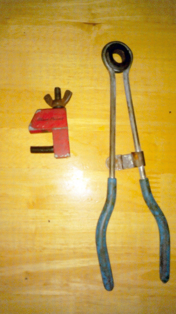

9 years 2 months ago - 9 years 2 months ago #12476 by Andy.MacFadyen
The Snap-on Blue Point part number is YA2850a on the left in the photo. The tool on the right is Draper equivalent --- which I don't recomend as it is too easily knocked off the hose.

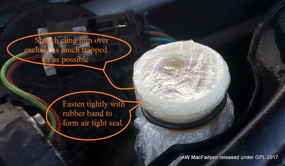

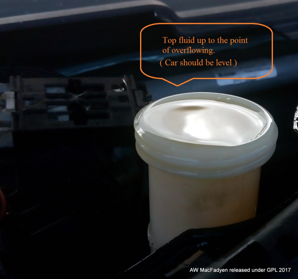

The other method to stem fluid loss is the Cling Film method which is simply filling the fluid resevoir up until it is on the point of overflowing and stretching cling flim across the top excluding any air . Then securing it with a rubber band or two round the neck to form an air tight seal. If the resevoir cap is a plain cap without a level switch then screwing the cap on tight over the cling also works.

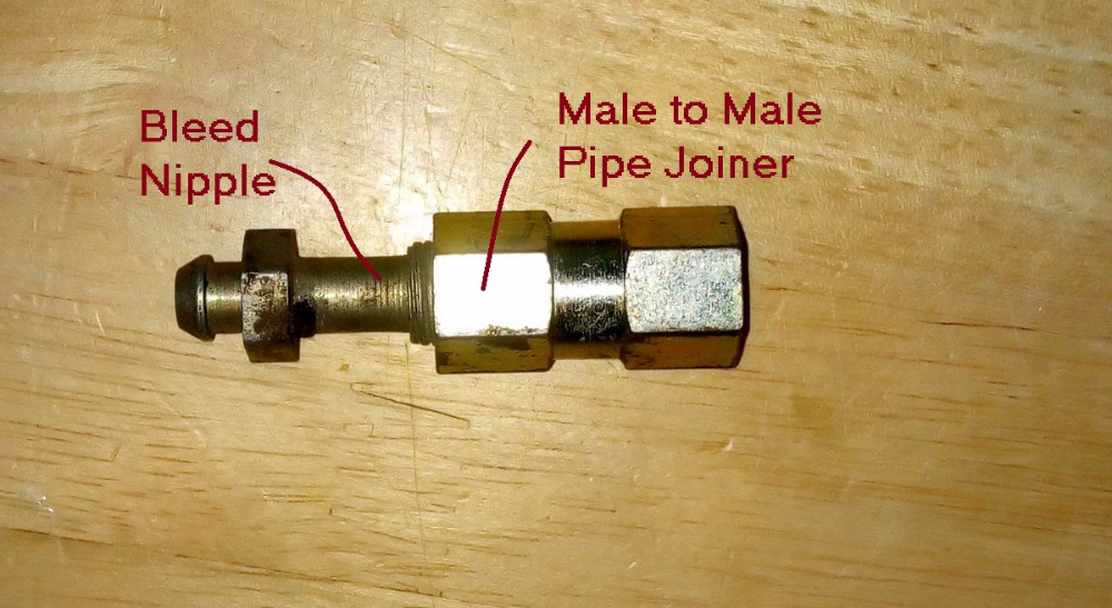

This is home made gizmo for stopping fluid loss from male pipe and hose ends.

9 years 2 months ago - 9 years 2 months ago #12484 by Andy.MacFadyen
The cling film method
Rember to lower the fluid level back to normal "High" to allow for heat expansion of the fluid before putting vehicle back in service.

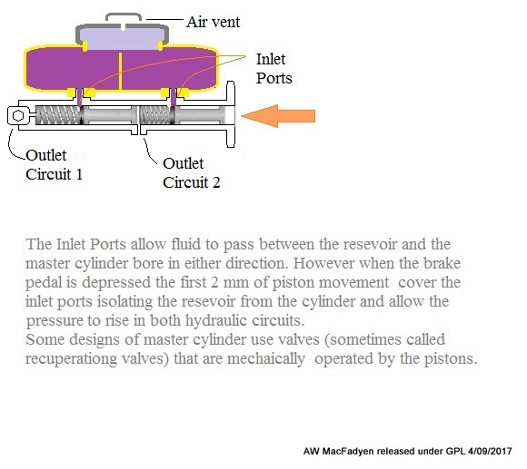

9 years 2 months ago - 9 years 2 months ago #12614 by Andy.MacFadyen
Noah wrote: I read somewhere that pushing the pedal just off it's rest position and holding it there (with a broom stick and the driver's seat or something) will keep an open line from draining.
I haven't had to try it yet...
Yeah that works it only takes about 2 or 3 mm movement at the master cyclinder (probably translates to about 18mm/1.5" at the pedal) to close the inlet ports off but it is probably easier to prop the pedal all the way down.
This picture kind of explains whats going on
