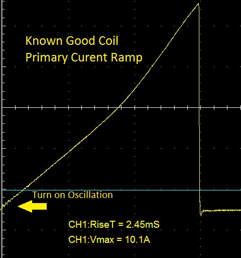

9 years 5 months ago #10351 by Andy.MacFadyen
A coil with a good secondary should show turn-on oscillations they might be small but they should be seen, the ramp will also be astraight line rather than a convex curve.

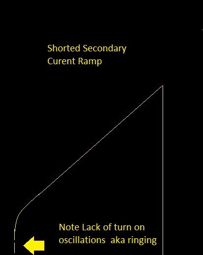

The primary is a reflection of the secondary and vice versa but the real give away for a shorted secondary in the turn on oscillation, if the secondary is shorted the turn on oscillation in the primary gets instantly snuffed out.

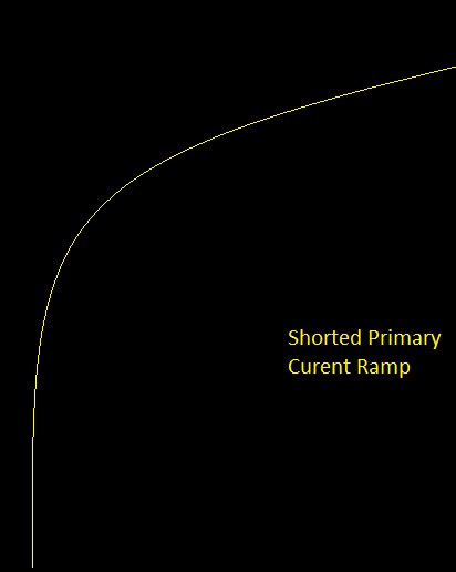

But if you see a vertical or very near vertical rise at coil turn on then the coil primary is shorted
Thisillustrates a shorted secondary

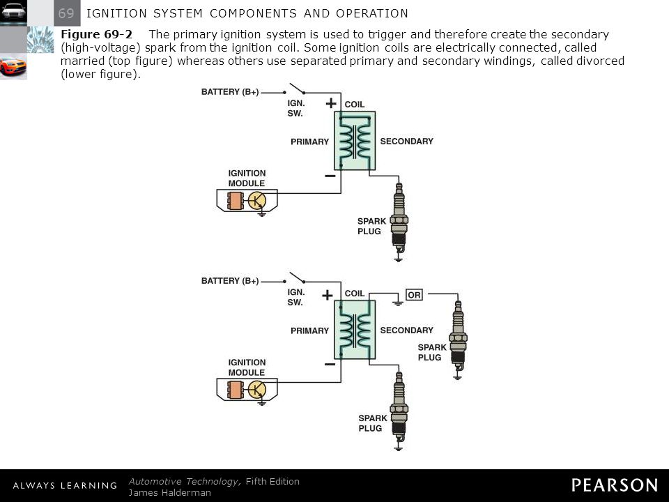

9 years 5 months ago - 9 years 5 months ago #10369 by ecwurban
Hmm. I wonder if that's just for coils that have a connection between the primary and secondary windings? As in:
If that diagram is correct then you should have continuity between the high tension side and the positive terminal of the primary. Electricity has to go back to its source. So I would think a simple COP design should have to be that top married style. Whereas a waste spark or a system that has two plugs per cylinder could use the separated style. Or if one uses an extra ground wire for completing the secondary circuit. Although I'm not sure I've seen that..? I haven't seen any coils that were case grounded and if it had a separate wire then that wire would have crazy high EMI so I don't imagine it would be placed with the regular harness..?
If the secondary winding is electrically separate from the primary I wouldn't think a shorted secondary would have much effect on the primary current during saturation. Other than details like turn on oscillations. You wouldn't have the secondary pumping counter voltage back into the primary via mutual induction but the primary would still have its own counter voltage from self induction. I would have thought that, if they are non connected windings, that it should still have a ramp just like a fuel injector or any other solenoid that only has a primary winding. Going by this line of thinking that would mean that a shorted secondary would show a similar current pattern to an open secondary. Which would be very easy to test. I think I'm off to the junk yard to grab some spare parts for my car to do some captures of introducing known faults...

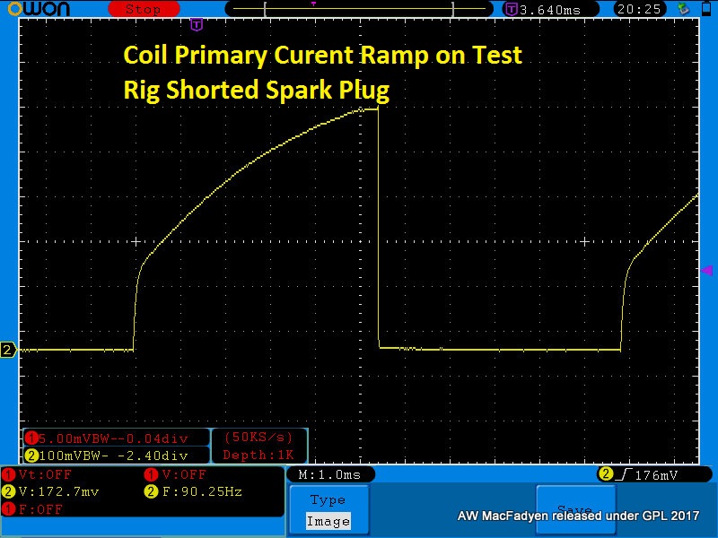

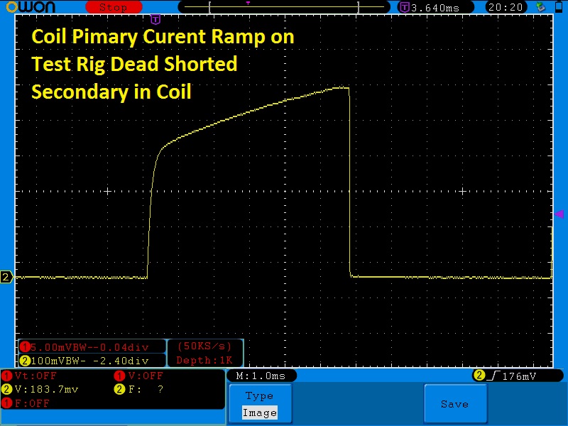

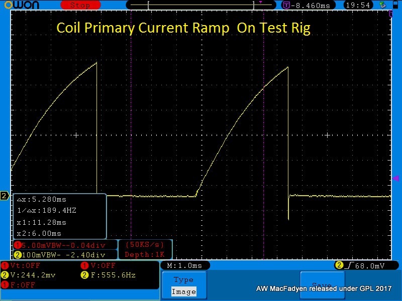

9 years 5 months ago - 9 years 5 months ago #10400 by Andy.MacFadyen
This one made me dust off my coil test rig and do some captures..
The results were very clear cut and very interesting.
Last edit: 9 years 5 months ago by Andy.MacFadyen.

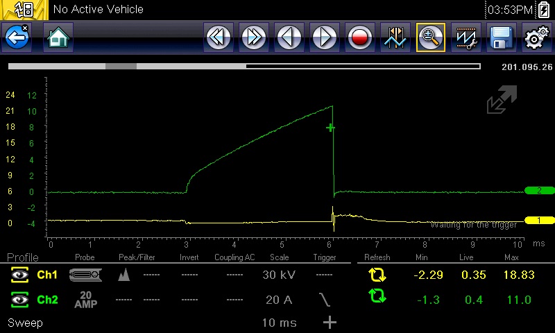

9 years 5 months ago #10401 by Tyler
Just ran into a Suzuki this week with a secondary problem, reminded me of this thread. :cheer:
Four cylinder, waste spark system. One coil has weak spark out of both towers, shorted secondary:
The other coil looking good:

9 years 5 months ago #10402 by ecwurban
Wow, that is interesting. I didn't think a secondary issue would show so much in primary current. Especially in the beginning when it's just starting to build a magnetic field.

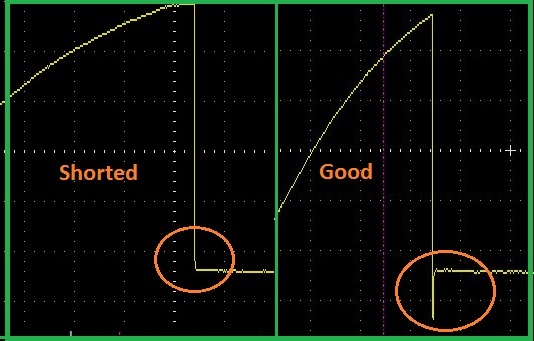

9 years 5 months ago - 9 years 5 months ago #10404 by Andy.MacFadyen
Comparing the the ringing or lack of at coil swtch off looks like a good indiactor.

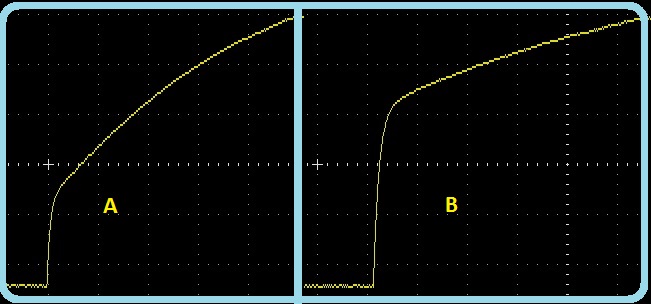

9 years 5 months ago - 9 years 5 months ago #10428 by Andy.MacFadyen
After another couple test runs I have couple of riders to add to this.
(1) It will only show a fail if there is a dead short, not an arcing short.
(2) It won't work on a shared coil if only one the half of the secondary circuit is shorted.
(3) On a DIS system because of spark gap between the rotor arm and the segment in the cap it will only produce a result if the coil has an internal short, any shorts outside the coil (eg a smashed spark plug) won't show up.
(4) For shorts outside the coil (trace A) eg. a smashed plug the resistance of the plug lead reduces height of the signature vertical rise compared to an internal short in the coil (trace B )

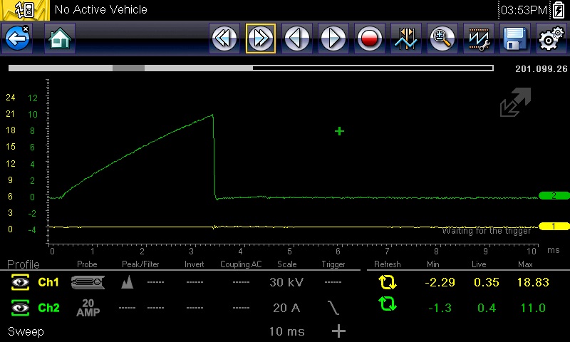

9 years 5 months ago - 9 years 5 months ago #10704 by ScannerDanner
Here is one where I thought the primary was shorted and it ended up being the secondary
Don't be a parts changer!
