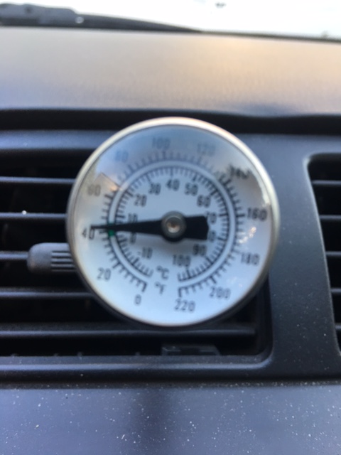

  • Charles Acosta
  • Charles Acosta's Avatar Topic Author
9 years 5 months ago - 9 years 5 months ago #10278 by Charles Acosta
Replied by Charles Acosta on topic [Fixed] A/C Repair
Final result with the car idling! The weather was 88 degrees in Long Island, NY
Last edit: 9 years 5 months ago by Charles Acosta.
