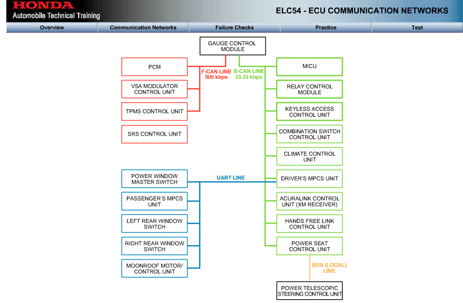

From what I have learned is that pretty much the core standard of CAN networks used is typically the same for all manufacturers as it was designed by the same guy, Robert Bosch. Although certain network layouts, names etc may vary slightly.
Although not a VW, here is a little diagram from earlier Honda/Acura vehicles with the gateway built into the instrument cluster.
The newer models started using a standalone gateway which basically acts as a translator between different CAN languages. F-CAN may speak "english" where as B-CAN speaks "spanish". Gateway speaks all the languages on the network and can convert messages between all types of CAN which are routed through it.
Cool little fact: Mercedes was the first vehicle to introduce CAN based network on their S-class in 1991.

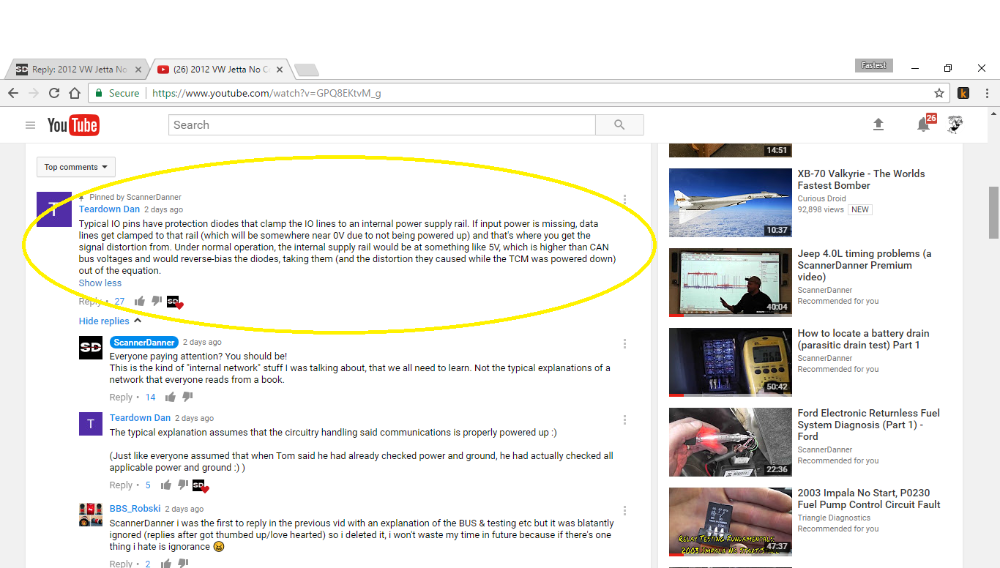

A few months ago I posted a question about CAN signals on a Ford ABS module 2013 FORD F150 5.OL ABS NO COMM, CAN BUS I eventually fixed the issue but never changed the topic to [FIXED] because I was unsure of what I had done when I fixed it. After watching part 2 and reading a comment from Teardown Dan that it clicked in my head what I had done.
When I had originally looked it the Truck, the connector for the ABS module had obvious signs of damage. And when I had tested all my powers and grounds I thought they were making good contact with the pins on the module. I had originally called a bad module but was then told that it had already been replaced twice before I looked at it.
So I then decided to replace the connector with a dealer part. I purposely only wired in the powers, grounds and CAN lines and left out the sensor wires to see what the results would be. And to my surprise the ABS unit came back on line and all my CAN signals were text book perfect.
It wasn't until I read Teardown Dans comment where he basically says that if from what I understand is that if you have missing powers feeds to some of the module then you can get feedback thru the CAN lines. I don't know if I am correct on what he said but it could make sense on the poor signal from the CAN lines.
Last edit: 9 years 6 months ago by Ro-longo.
9 years 6 months ago - 9 years 6 months ago #9167 by Noah
Cool, so you're talking about this recent video:
And this comment:
I was having a hard time remembering a user on the forum that goes by "Teardown Dan", lol!
I'm glad that you brought this up, I gotta start reading the YouTube comments.
