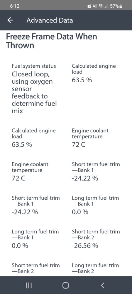

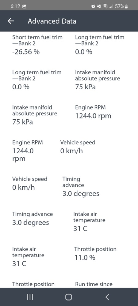

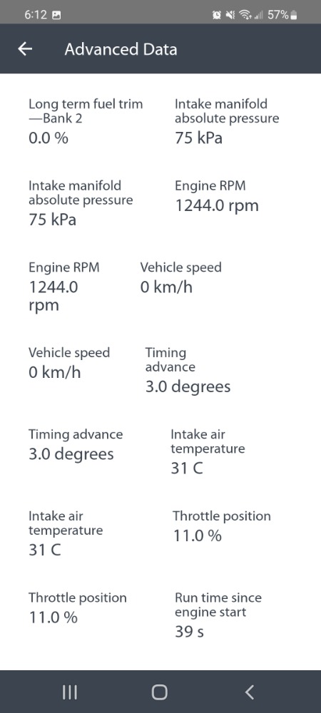

Here's the advanced data from the most recent P0300. The van started, idled roughly for 30 seconds and died. It won't start anymore. Fuel injectors?

The pcm is seeing the engine under considerable load, indicated by the map reading as well. Both banks' O2 seem not to agree with the corresponding fueling as the STFT reveals.
