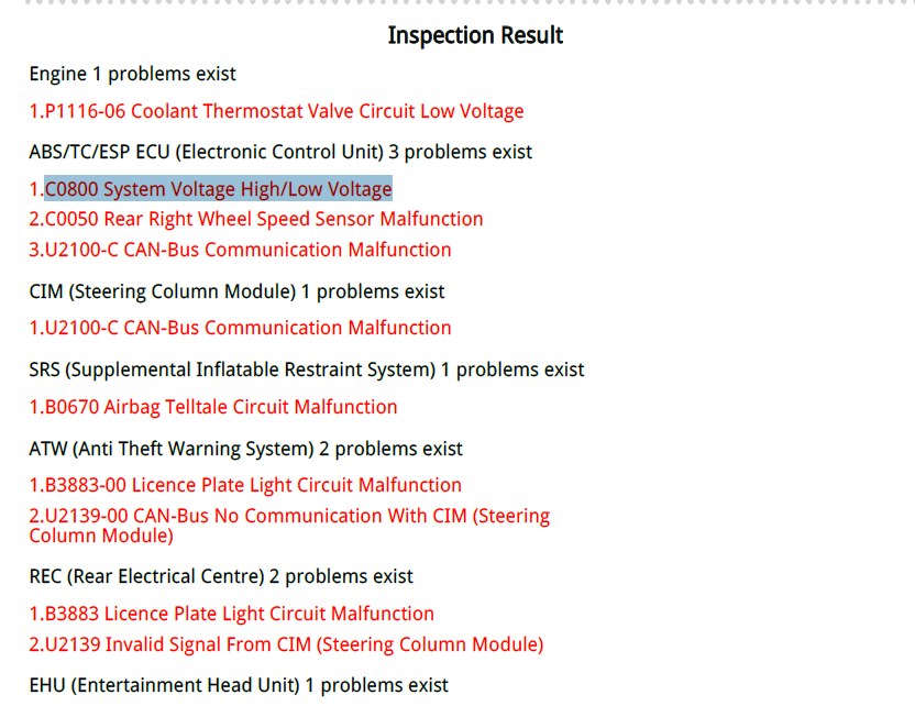

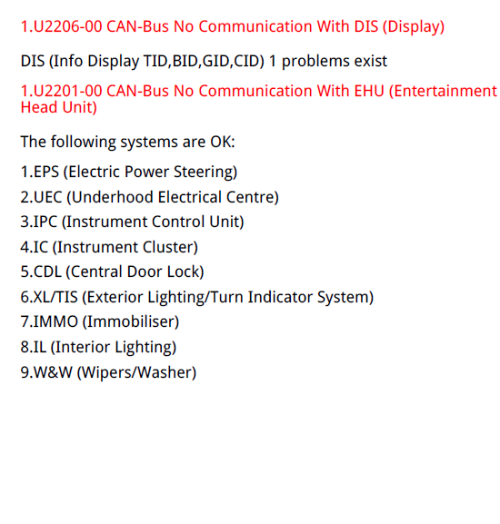

Opel Astra 2005 engine xep16 Radio not working I guess I start there to test power and grounds but what do you think with this fault codes

I would first clear all the codes and see which ones come back.
If you got a scope and break out box, check the Can Bus communications high, low.
Identify how many modules the car has and how the they are connected wiring wise.
