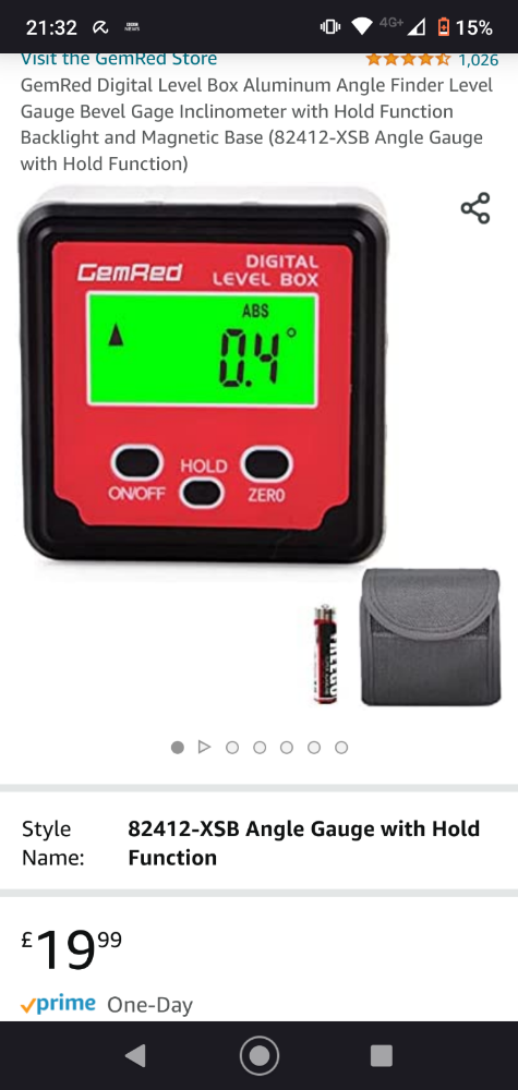

You can measure and set camber accurately with very basic tools. Also of the three main suspension setting camber is the least critical.
Camber is simply the angle the tyre makes to the road surface.
(1) You will need access to smooth level floor -- if it isn't absolutely perfectly level you can mesure how far it is off and apply that as correction to add or subtract from your camber measurement.
(2) A cheap digital level - you could use an old style spirit level but you would need to do some maths.
(3) Some planed straight timber --- 2"x4" is ideal. --- or if you are happier working with metal could rectangular section steel.
Cut the timber to slightly longer than the wheel rim diameter, mark end top.
Blow the tyres up to 40 psi.
Steering in straight ahead postion.
Drive the car forward and reverse a few feet to settle the suspension.
Chalkmark the top (12 O'clock) of the tyre.
Hold the wooden batten close to the vertical hard against wheel rim and use the digital level to measure the angle from the vertical
Wheel leaning outward at the top is positive camber, out at the bottom is negative camber.
Next measure the camber on the opposite wheel of the axle.
Repeat the measurements with the chalk mark in the 3 o'clock, 6 o'clock and 9 o;clock positions.
Unlike toe setting you are unlikely to get the camber exactly to specification on a road car.
Camber tends to negative camber as the ride height decreases as the springs settle with age.
Toe setting (within reason) has only a tiny effect on camber.
Modern front drive cars usually speced to run around 0 to -0.5 of camber
High performance cars can often use more negative camber at the expense of tyre wear in a straight line.
see

Wow. Thanks for that.
I just ordered a digital level for next time.
