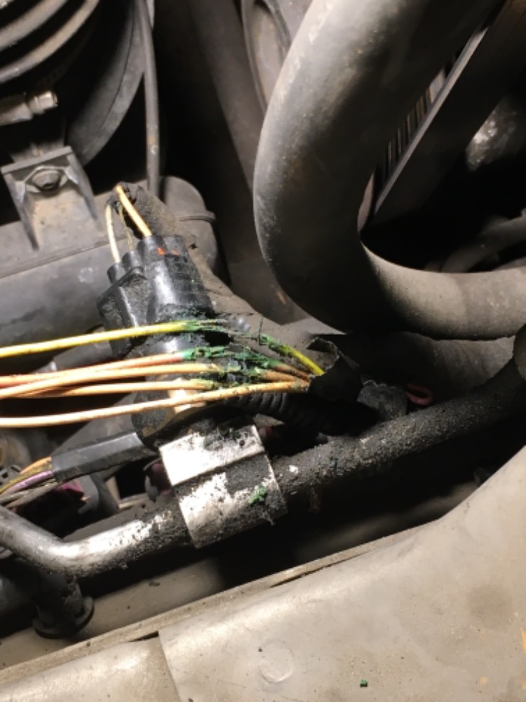

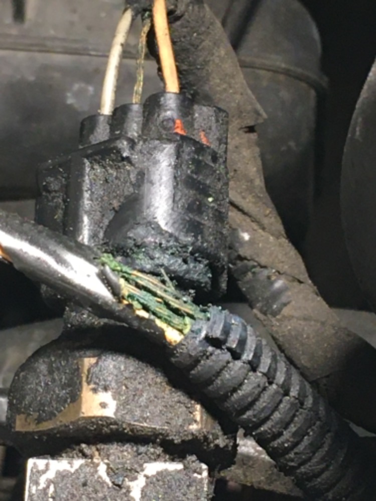

CTS cranks but no start and the several codes showing high voltage on sensors (MAF, Camshaft position sensor (CMP), APP, ECT ). I did find the 5 lines going to the MAF were rubbing on the frame and shorting so I fixed them. I replaced the MAF, CMP and ECT sensors and replaced the MAF connector. I got some help for JustAnswers.com here www.google.com/url?sa=t&rct=j&q=&esrc=s&...qp9ckOu9QLdo6IEFR4hv

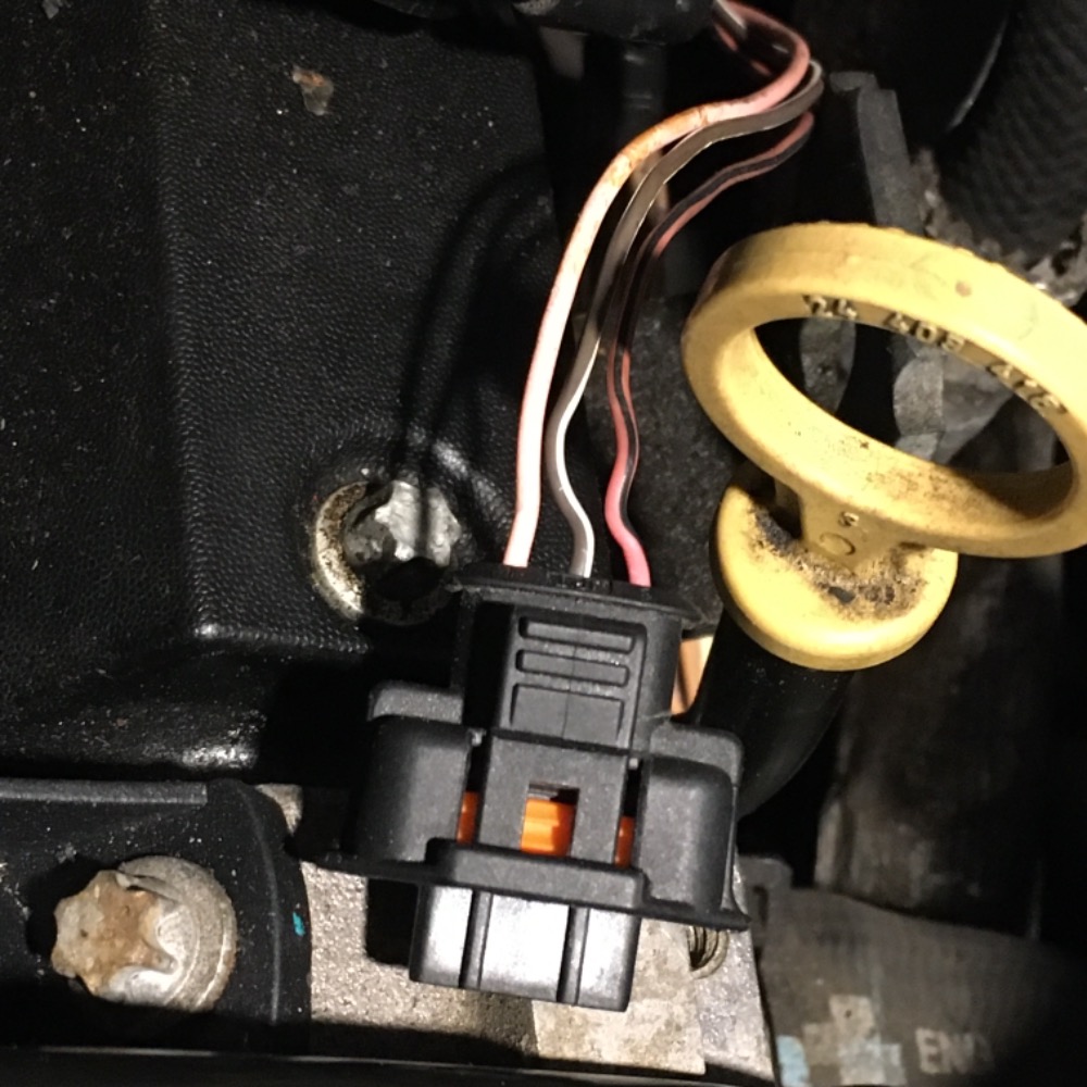

I switched the 3and 4 lines to the MAF and could not find any short to power on the CMP sensor. Even depinned the connector there but it looks good as there is no shorting in the connector (see photo). I had traced the MAF tan lines to their pins on the ECU, and now the shared ground is on MAF pin 4 instead of the middle pin. Should I switch them back?

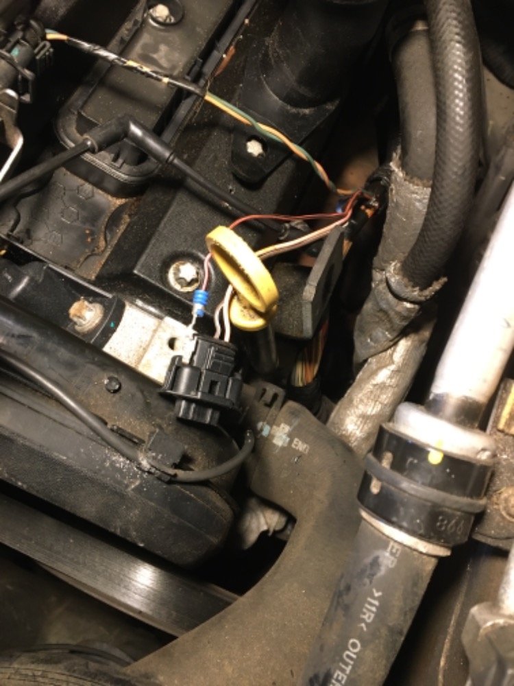

Tha cam position sensor wire colors on the wiring diagram are different than those in my car and I pulled back the tape on the harness they go all the way and are not spliced. See pic. I don’t think we can use the colors but trace which is the ground by continuity to the right pin on the ECM

4 years 7 months ago #54705 by VegasJAK
For sure, the center Brn/wht is your signal wire. The wire on the left in photo looks white but further back it's pink. I have found ground wires red with a black tracer before. Trace the pink back it should go to a fuse source.

I did find a photo of the MAF that you cut off. Are the wiring positions original?
Which CMP photo is the original wiring positions?

4 years 7 months ago #54713 by Marti
The CMP original wiring has red/bk on pin 1 where the diagram has a tan shared sensor ground. The other wires are similar to the diagram colored lines as seen in my picture. I now have it connected as originally seen before my radiator replacement when the car ran. I’ll use a brake light bulb to power each ground line and the 12 volt B+ lines after work. Also, because I hit the ABS module connector putting the radiator in I’ll visually inspect it. I also removed and ohm tested the ACellerator pedal position module so must I calibrate this before it will start?

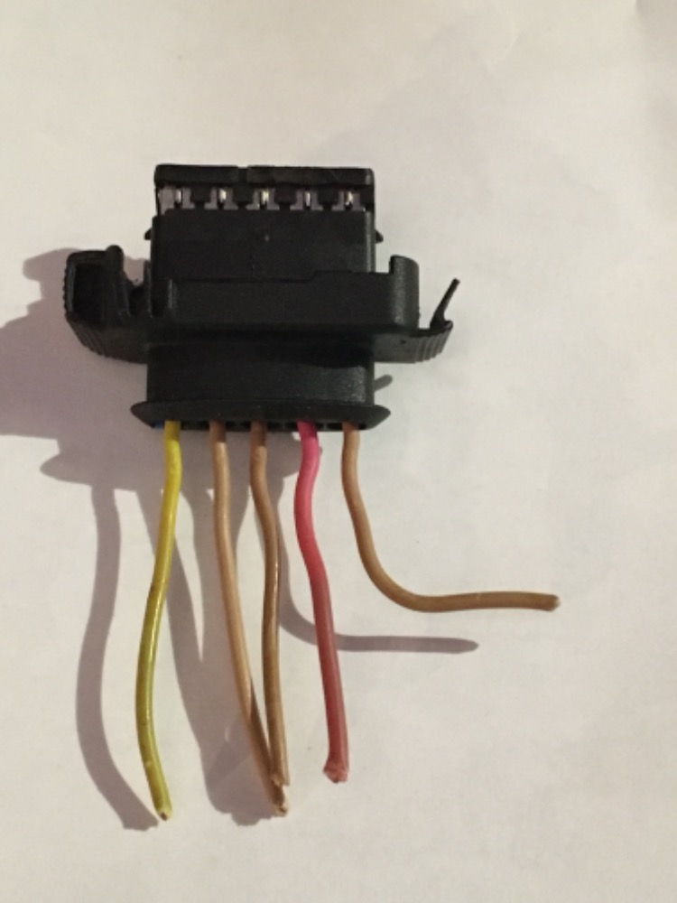

Connect the MAF wiring back to it's original positions. We know now that the wiring diagram is not color or position matched to your caddie. Take care reattaching those tan wires. To bad they did not have a tracer color to identify each circuit.

When reconnecting the wires to the MAF pigtail, the yellow and pink wires on the connector pigtail go to their respective yellow and pink wires from the harness. As the pigtail wires are in their original positions this is where they belong, its the three tan wires which have to be identified. I would unplug the C1 connector at the ECM. Using a nine volt battery, connect the black lead of your volt meter to the neg post of the 9 volt battery. Back probe the tan wire at the disconnected C1 connector, should be the 7th wire position back from the end of the C1 connector between a gray wire and a yellow wire. With a jumper wire, connect one end to the positive post of the 9 volt battery, the other end to the tan wire you back probed. Set your volt meter to dc volts. Using the red lead, touch each of the three tan wires you're trying to reconnect one at a time and note the one that has 9 volts on it. That will be the AIT signal wire that attaches to the outside tan wire on the MAF connector. Do the same process to identify the MAF ground. Jumper wire from battery positive to the tan wire in the C1 connector 13 wire positions back from the end of the connector between a light blue/black and light blue wire. Touch the red lead to the remaining two tan wires and note which one has 9 volts. That will be the MAF single ground which attaches to tan wire next to the yellow wire on the MAF connector. The remaining tan wire on the harness connects to the remaining tan wire on the MAF pigtail. From left to right on the pigtail you should have yellow, tan, tan, pink, tan.
If I over simplified this, sorry, just wanted to be clear. Do the above with the key off. If you're nervous about the 9v test, you can disconnect the car battery. Using the Ohm meter can give you a false reading so do not use it. Use the volt meter instead.
