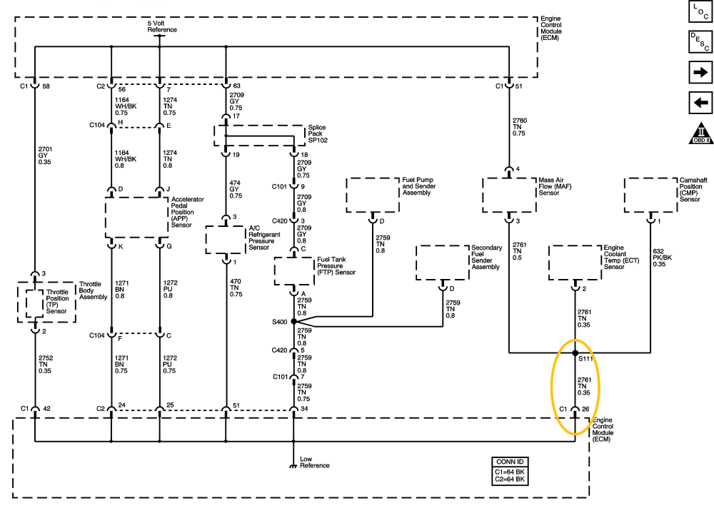

4 years 7 months ago #55114 by jreardon
I don't know anything about this immobilizer system but no com to computer so check power and ground I guess. Gotta start somewhere.
When I made the suggestion to check for a IMRC control wire short to ground I might be incorrect assuming a short to voltage on the ground because I don't have enough evidence.
I neeed a loaded circuit voltage reading so when you get the MAF connected again and you have high voltage on the ground, does the TPS ground also show high voltage. I'm only picking on the TPS because I think it's easy to get to and it's on the other side of the ground tree in this diagram.
i.imgur.com/r1sQSb7.png

4 years 7 months ago #55195 by jreardon
Each of these sensors share the 12 volt power feed and there is continuity between these lines. I also found a donor car (2003 CTS with 3.2 liter) at the junk yard and found the same continuity with all the 12 v lines to these sensors.
Do you mean the ground (low reference) has continuity ?
I don't think the ECT sensor has anything in common with the MAF or CMP, besides the shared ground (low reference).
I'm glad the immobilizer issue is sorted :) Now back to the main course lol. Plug in the MAF again and get the high voltage on the grounds again, and take a voltage reading at the TPS ground. You can unplug the TPS for this.

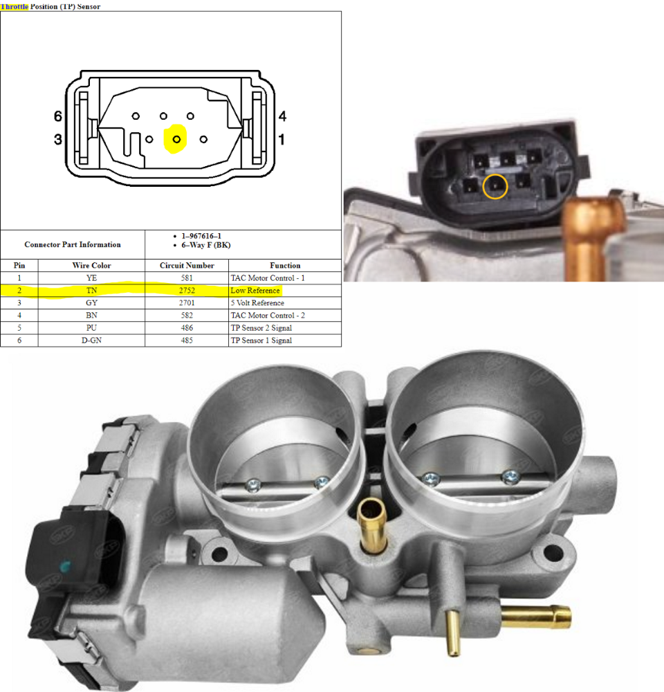

4 years 7 months ago #55205 by jreardon
Is this the one you have 10 or 28 mV on? Tan wire?
If yes then this justifies taking a voltage reading on this wire at the computer. If the ground's good at the TPS, but bad at the MAF, then this is the area I'm most interested in:
If the voltage is low at pin 26 connector 1, but high at the MAF then it's time to start tugging on wires because it's looking like a bad wire or splice.
