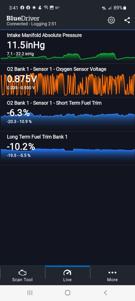

4 years 8 months ago #54312 by abbottjames712
P0172 was created by abbottjames712

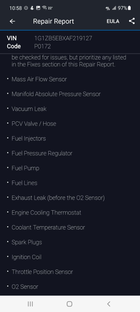

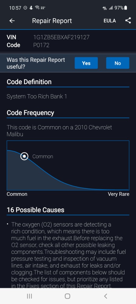

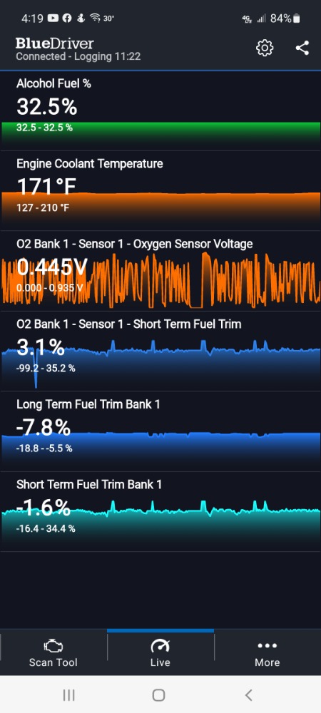

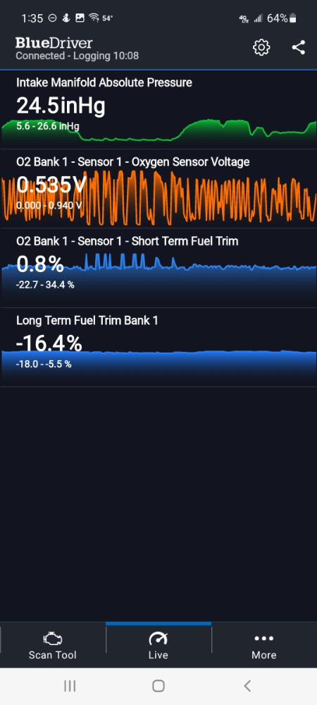

2010 Malibu 2.4L P0172: New MAF, O2 sensors, ECT sensor, thermostat.

abbottjames712, I moved your thread to the Repair section. ;) More likely to get assistance there.
Have you tried resetting your Fuel Alcohol Content %? That's a common source of rich conditions on that engine. Your scan data indicated 32%, which is enough to cause issues *IF* you haven't been buying E85.
If you reset the Fuel Alcohol Content and your fuel trims immediately improve, then you're on the right track. Check out TSB 10-06-04-004B for more info:
nanopdf.com/download/intermittent-illumi...dicator-lamp-mil_pdf
