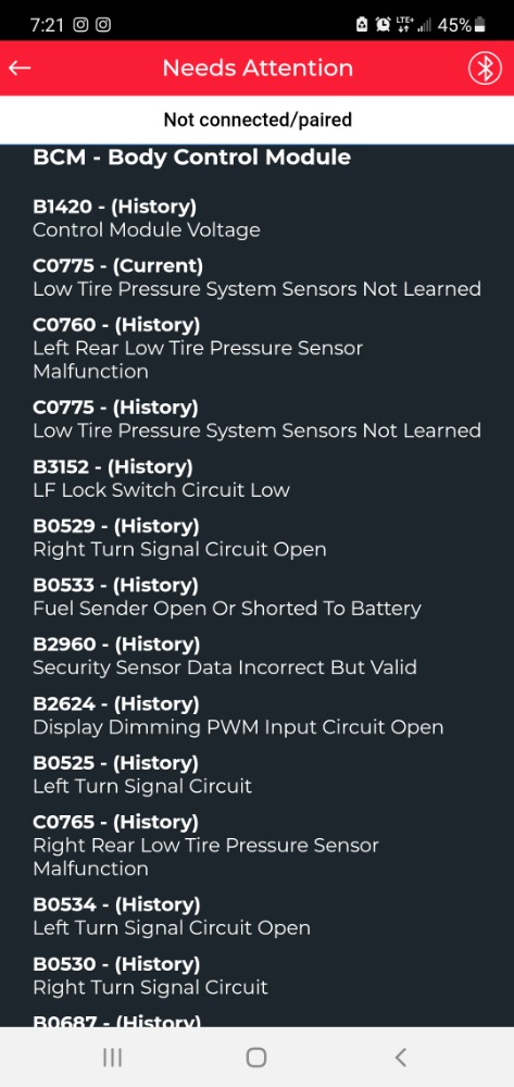

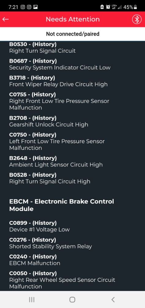

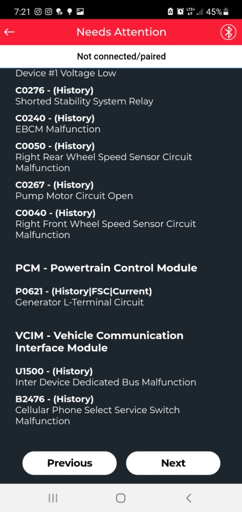

Hello everyone. Newbie here. I have a 2006 H3 3.5l with tons of codes. I'm a bit mechanically savy but know 0 to non about electronics. Hummer won't start without jumpers. I've replaced battery and alternator. A few corroded relays and fuses as well. Hummer will stay on until I put it in drive then it shuts off. I have a scanner. I've attached pics of codes. Any help will be greatly appreciated. Thnx a bunch

So it doesn’t do anything until you jump it? What’s the alternator putting out at the battery terminals? Do you have Power at the alternator stud??
4 years 8 months ago #53918 by Omarb
Replied by Omarb on topic H3 electrical issues
Yes it does have power to post. It reads 11-12v. Hummer stays on until I press brake to shift.
4 years 8 months ago - 4 years 8 months ago #53920 by ksat22
Replied by ksat22 on topic H3 electrical issues
Does anything happen when you try to start the vehicle prior to jumping (starter engagement, relay-solenoid noises/clicking, etc)? 11-12V running sounds pretty low. Don't know if that has a smart alternator, but put a load on her (headlights+blower+rear defrost) and take another V reading. If it stays the same (or goes lower) something's amiss.
Why was there corrosion on the fuses and relays, you mentioned?
