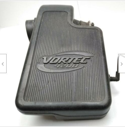

ok so I took the cover thats by the throttle body off. Should that thing have oil in it? I don't feel real confident enuff to take the t.body off. You think its ok to clean it with it on PLUS I cannot get the damm plugs off. What say you?
- Posts: 6146
4 years 9 months ago #53804
Replied by Tyler on topic 2002 trailblazer throttle body clean

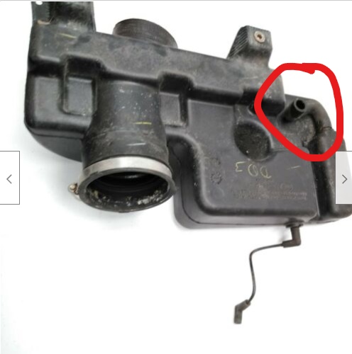

You mean the intake resonator has oil in it?
Not unusual, IMO. The fresh air side of the PCV system runs through that box. That's the rubber hose on the bottom side:
Make sure that hose goes back on the valve cover when you put it all back together.
It's easy to miss.
It'd be better to have the throttle disconnected during cleaning, but it's not a deal breaker. Just make sure the key is off. It's also going to have a high idle when you get done. Give it plenty of time to adjust.

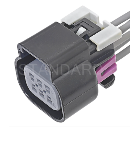

- Posts: 6146
4 years 9 months ago #53809
You mean the main connector for the throttle body? There's a weatherpack seal inside that you may be fighting. Are you sure you got the CPA disengaged? That's the white part of the connector:
The CPA needs to be as pictured above to get the connector to unlatch.
