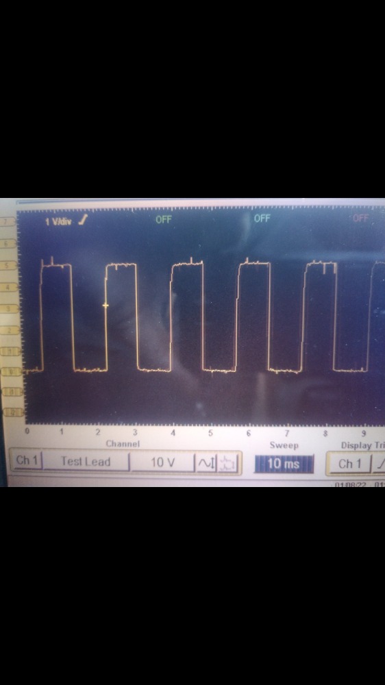

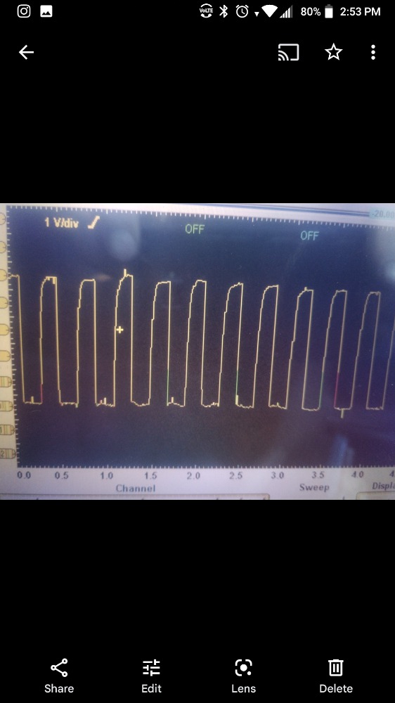

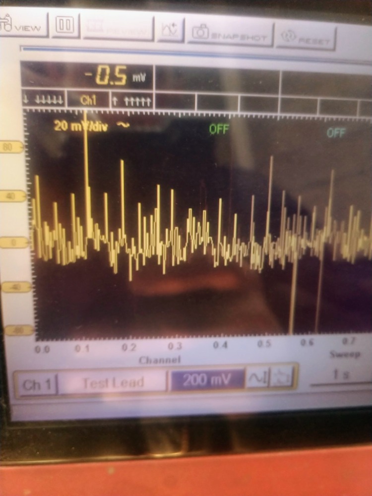

I think I've discovered something today. As I said before, voltage on this car is rough... Even with the alternator disconnected. This crank signal looked rough to me, so I checked for ac voltage on the 5v ref. Think this ac voltage might be the problem?

Not yet. I think my problem is too much ac voltage on my crank 5v ref. We've been really busy so I haven't been messing with it. I'm thinking about putting a bridge rectifier on the reference wires to the crank sensor. Unless I can figure out where this stray voltage is coming from.

This vehicle is fixed. Replaced the ecm and all is good. Something inside this module was creating excessive and hashy looking AC voltage throughout the car. With the new (used) module installed my 5v references look cleaner on the scope and my crank signal looks slightly sharper, but not noticeable unless the before and after are compared side by side. Thanks to all who took the time to respond.
