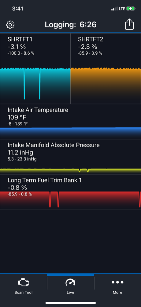

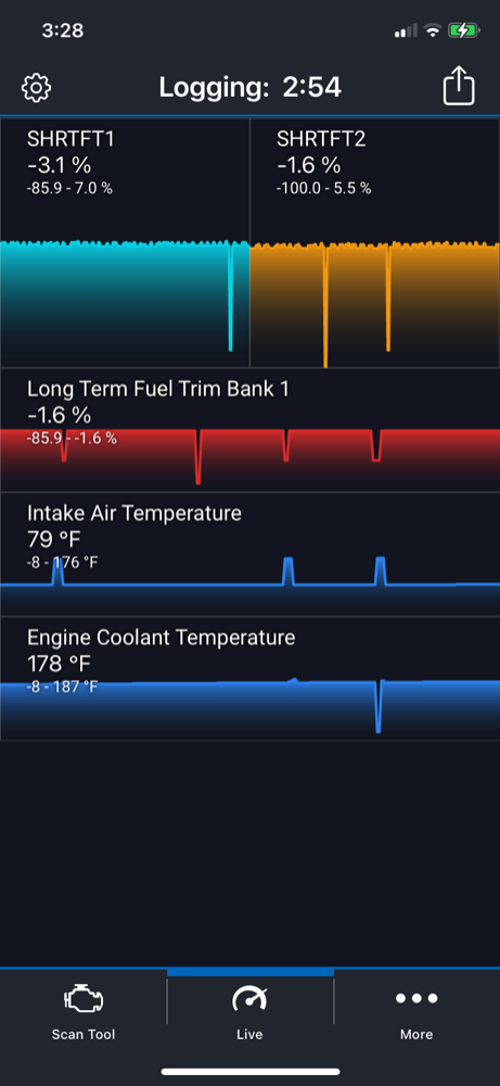

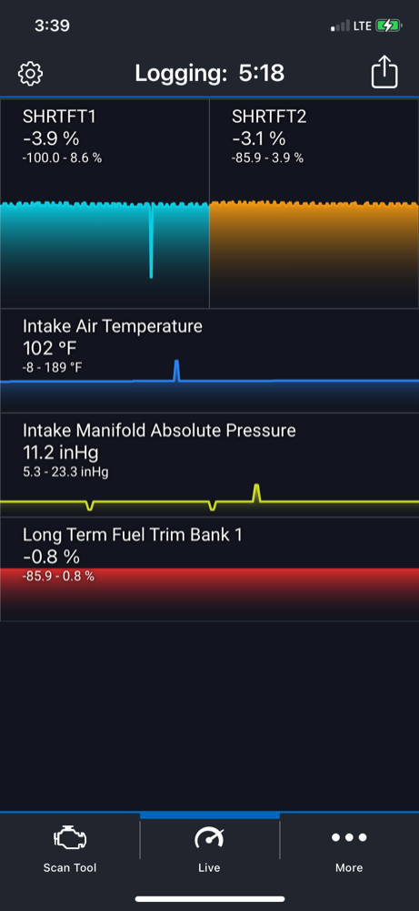

I will check the coils and injectors with an Ohmmeter in a few days. I do not have access to an oscilloscope so I might have to go to a shop to get that done but would rather not have to. I have attached an image of the readings from my BlueDriver OBD that shows some data. It includes Short Term Fuel Trim, Intake Air, Manifold Pressure, Long Term Fuel Trim data. As you can see AT IDLE or coasting I get severe negative spikes on the Short and Long Term Fuel Banks, Also at idle I see spikes in Engine Temp, Intake Air Temps as well as Intake Manifold Absolute Pressure. All of these 3 images are at idle once the engine was warmed up. I’m not sure if you can figure out a direction for me to go but take a look at these. I tested the Intake Air Temps via voltmeter back pinning the wiring and it read at 3.75 volts. Based upon SD vids it said the reading for a VW should have been at 5 volts. How can I find the voltage for this Dodge? I also disconnected the Air Temp and ran a jumper between the two inputs for this and it pegged the Air Temp at 375 degrees.
My guess it that I am having bigger issues with the computer but I am just a shade tree guy. Thanks for your input as always!

I wouldn't sweat those spikes in the fuel trim graphs. I'm willing to bet those are caused by the BlueDriver software, and not an actual fuel trim concern.
What SD said about 5V is true if the temp sensor is disconnected, as a way to check the computer and signal wire integrity. With the sensor connected, the voltage will be lower than 5V because the temp sensor is doing its job as a resistive short to ground.

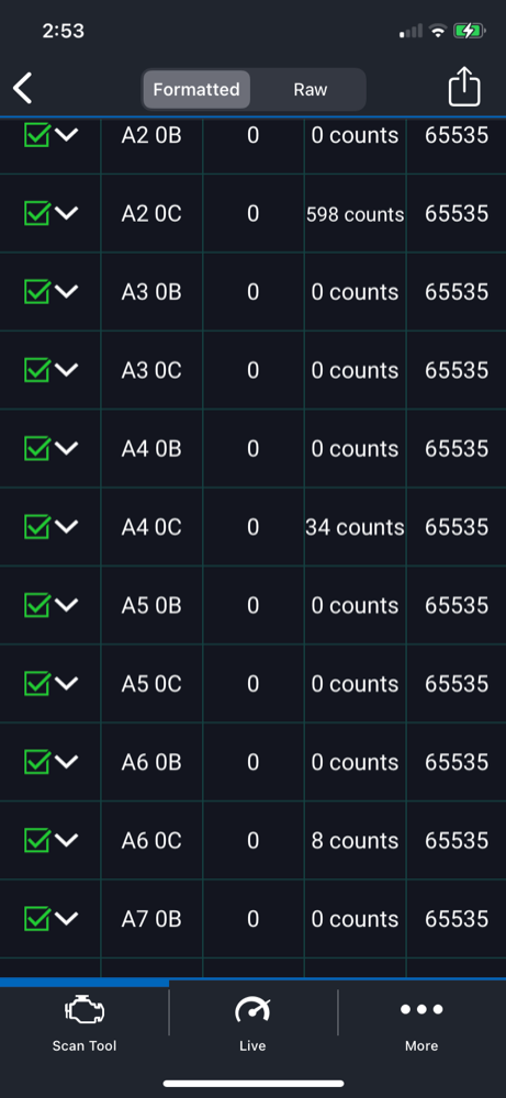

Here is the data from the Code 6 readings on the Blue Driver during a cold start/ warmup. The CEL came on and identified a P0300 misfire. As you will see on the data I have misfires all on the right bank with the biggest problem being cylinder #5.
FYI I have all new Coils and new Champion plugs on all cylinders. I also had the Cats replaced a month ago along with the 02 sensors on both sides of the Cats. Also I had run a leak down test on ALL cylinders and there is virtually no difference on all 6 cylinders. Here were the readings.

If there is any other tests I can run and share on the BlueDriver let me know. See the attached image of the last scan.
A2 = Cylinder 1
A4 = Cylinder 3
A6 = Cylinder 5

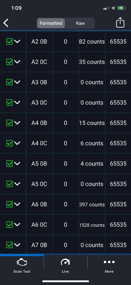

A quick update. It now looks like all of the cylinders are missing based upon this last scan. See attached!

Thanks for the Mode $06 shots. :cheer: Makes the picture a bit clearer.
I definitely agree that #5 is the biggest offender. Higher current drive cycle and EWMA counts than anyone else. I know you're getting multiple codes and multiple misfire counts, but I'd still suggest attacking #5 directly. It's going to be the easiest misfire to reproduce, and isn't obscured by the intake in this application.

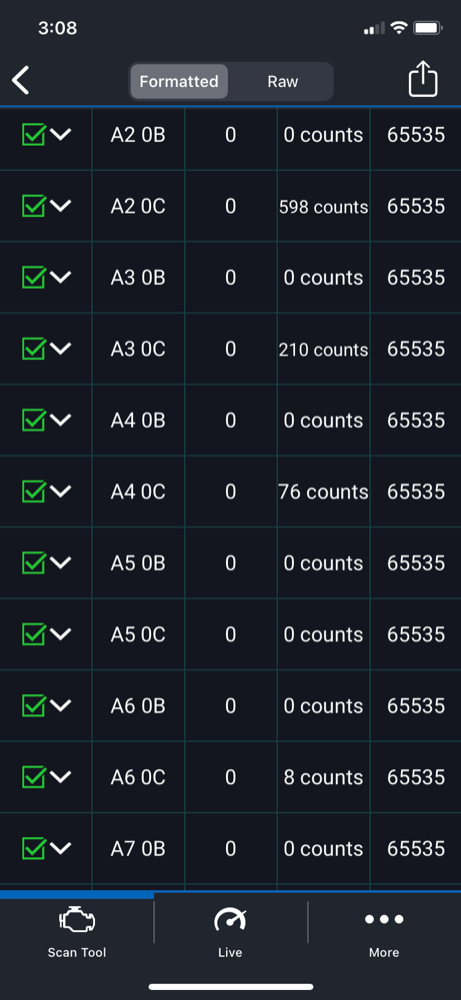

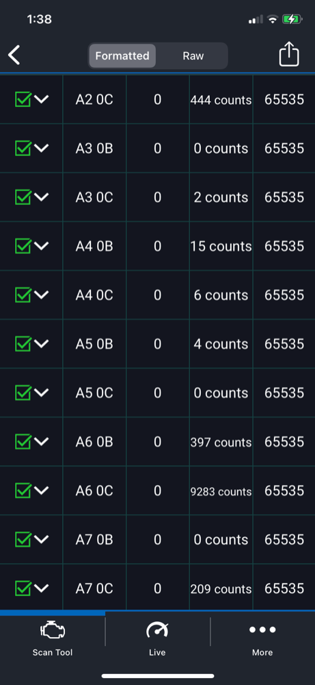

On the attached image check the Mode 6 info. As a reminder I switched the coil 5. I kept the same plugs in 1,3 and 5 and left coils in 1 & 3 alone.
The new data has issues with cylinders 1,2 and 3 now. I also cleared all codes to get rid of the CEL. The confusion continues!

Sorry ignore that last image. Here is the correct one.
4 years 9 months ago #53894 by Matt T
Replied by Matt T on topic 2011 Dodge 3.6 Pentastar Idle Issues
It's actually kinda interesting. A2 0C and A6 0C are unchanged between it and the later image. And A4 0C has only gone up a bit.
