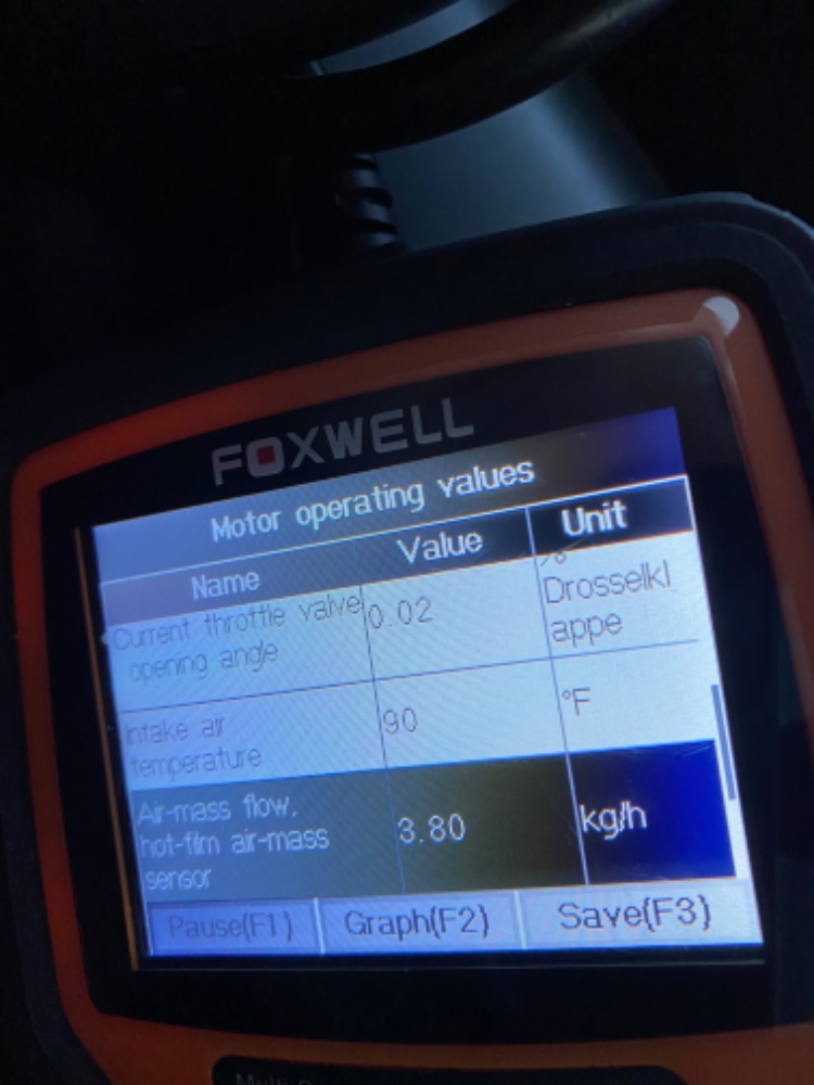

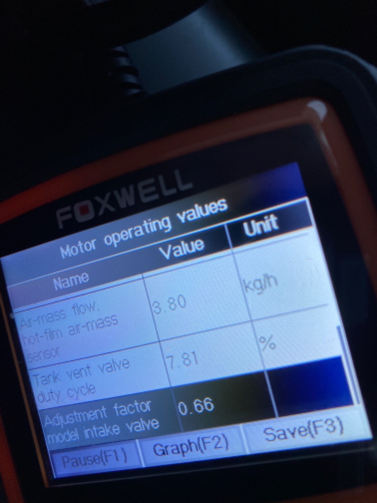

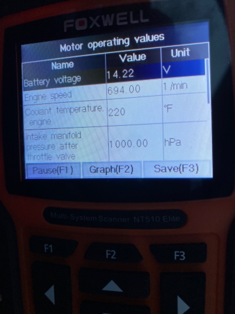

After resetting fuel adaptations in was surging on idle for a while. As it warmed up it ran better. Shut down clear codes and restarted and went for 10 mile drive in highway and local roads. No codes yet but not all obd codes are ready. Going down hill of the throttle O2 voltage precast was over 2 but dropped to 1.4 when on throttle. Fuel adaptations are now between 4 and 5 instead of close to 8. I took some pictures of my scanner but do r know if this data means anything. It has intake manifold pressure but not crankcase pressure. Any thoughts or is this useless data. Need a launch or autel scanner but not sure what to buy. Thanks.
  • SamM
  • SamM's Avatar Topic Author
4 years 10 months ago #53223 by SamM
4 years 10 months ago #53228 by Tyler
Actually, that data isn't terrible? This engine doesn't have a crankcase pressure sensor, so you're not missing anything. :silly:
The airflow rate *could* be indicative of an issue? The general rule-of-thumb is that the MAF should read the same in grams/second as the displacement of the engine in liters. So, if you had a 3.0L engine, your MAF should indicate 3.0 g/s at hot idle with no loads on.
I put your 3.8 kg/h reading into a converter and got around 1 g/s. Technically, that's low, and suggests unmetered air. That'd agree with the 2789 code you retrieved earlier. BUT, things also get more complicated with this engine due to it's low displacement and variable valve lift system.
If you're intent on getting another scanner, I'd suggest going with Autel. I own one of both, but still find myself reaching for the Autel more.

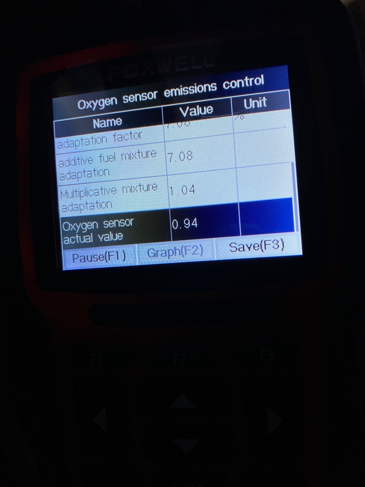

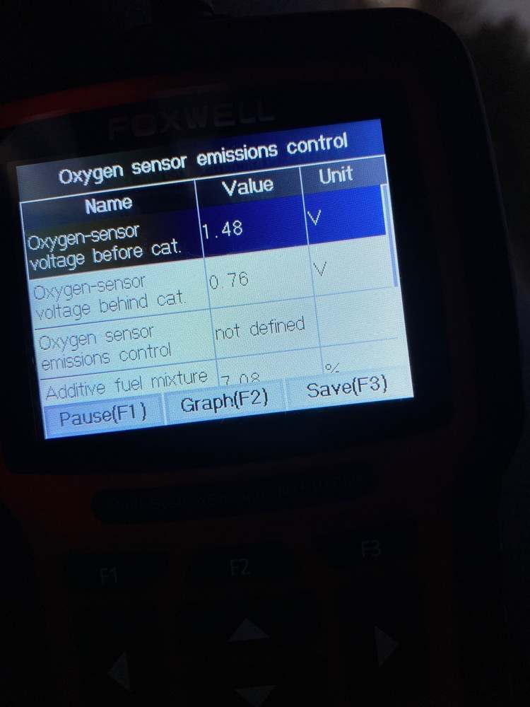

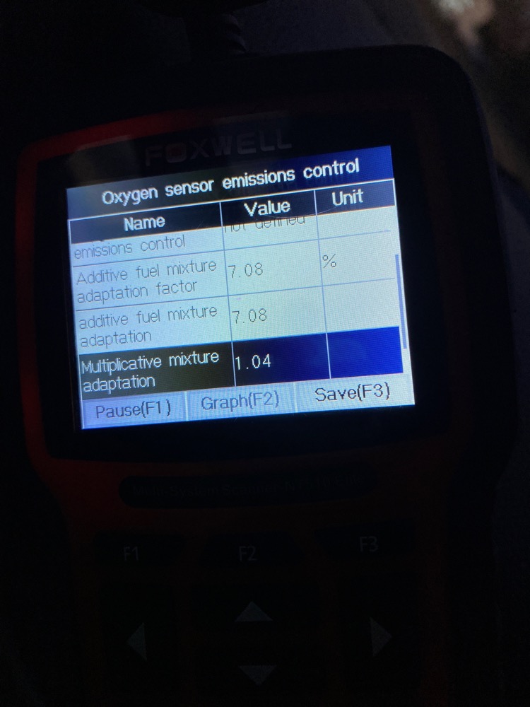

4 years 10 months ago - 4 years 10 months ago #53231 by juergen.scholl
Quick tip: divide the kg/h by 3.6 to get your g/sec without calculator ( or, - roughly - ÷7*2).
You will see your scan data refers to an adaptive correction and another one called multiplicative, in your case the latter one being lower. German cars use these terms to distinguish between idling/low rpm and off idling condition. Adaptive correction describes idle/low load( below 1200rpm/ at least on VAG products, BMW/MINI might be≤1000rpm,not sure) where as multiplicative reflects higher rpm/loads. The scan data shows more ft correction at idle, supporting the idea of possibly unmetered air as Tyler already mentioned.
In combination with the input from other sensors like ckp, tps and like ones the control unit looks for to be expected values for the maf reading as well. The plausibility code will be flagged when the comparative data doesn't jive. In your case it could be a vacuum leak but there are more possibilities like an out of calibration mat sensor. The smoke machine will take a good step ahead n your diagnostic journey.

4 years 9 months ago - 4 years 9 months ago #53271 by SamM
Still waiting on my smoke machine but can you confirm that these short and long term fuel trims are inductive of a vacuum leak? This is what I gather from some of the scanner Danner videos I watched but I know there is much more to this. Fuel trims are very high on idle and go down as engine speed increases as shown on the attached video. When I am cruising on the highway it drives great and both long and short term fuel trims hover positive and negative right around zero.
