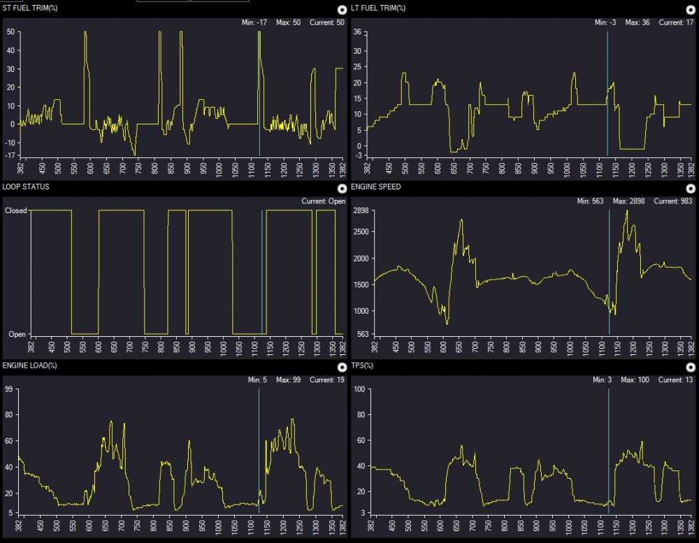

Hi guys , i have this chevrolet sonic 2015 with a lean code p0171 i found intake hose was broken , but i went to live data and for my surprise i found fuel trims but no like i used to see -10 or +10 number , it was more like number going all the way for example 50 54 etc. I try to find some info how to read this but unfortunately didn't find anything. Appreciate the info guys thanks a lot !
9 years 6 months ago - 9 years 6 months ago #7524 by Tyler
Replied by Tyler on topic Chevrolet sonic 2015 fuel trim
Short term showed you 50+%? Was it something you saw momentarily while driving, or was it a steady reading?

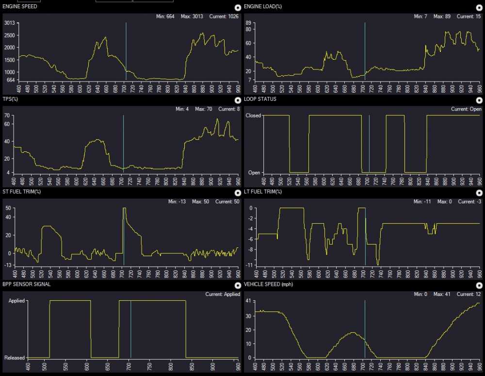

I ask because it's not unusual to see brief spikes of 50% or more on short term while driving, as the PCM moves back and forth between open and closed loop. Here's an example off a 2012 Cruze:
The first picture definitely has a fuel control problem (failed intake one-way valve), but the second is after the repair. Both show the unusually high short term spikes.
Anyway, if it's just something you're seeing briefly and fuel trims look good otherwise, then I wouldn't sweat it. ;) If the trims are still high during closed loop, then there's probably another issue.

9 years 6 months ago - 9 years 6 months ago #7588 by Tyler
GeekDIYMechanic wrote: Likewise looking at your graphs, it appears upon deceleration it also drops out of closed loop as well. I'm guessing for the same reason as the WOT status with an O2.
Did I just answer my own question? LOL
Yep! :lol: During fuel cut decel is when I see this behavior the most often, at least on the Chevy Cruze and Sonic. Just to be sure I was telling you right, I went back to the post-repair capture and added a couple more PIDs.
With a couple exceptions, the open loop events are always associated with the vehicle slowing down. :blink:

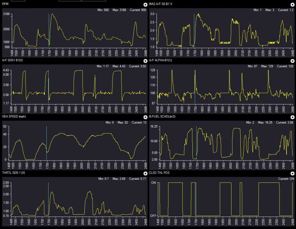

That's what I thought, too! :silly: But it seems like the PCM is actually eager to get OUT of closed loop? I've noticed similar behavior on other newer model vehicles, not just GM's. Here's a shot from a 2012 Nissan Rogue. It took any excuse it could find to go into fuel cut (high voltage on the A/F sensor). It even has the same kind of short term spikes as the Cruze.
