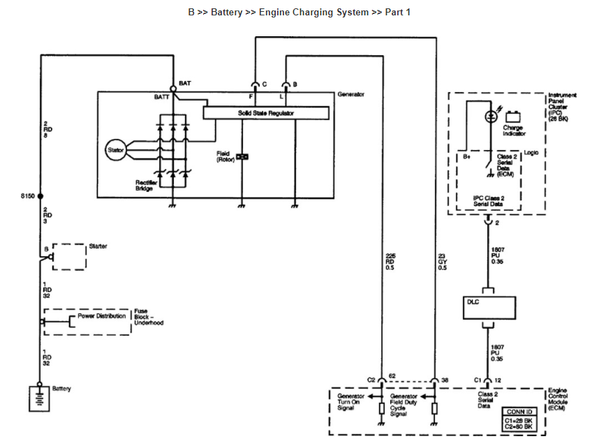

The engine size is 2.2L. The alternator has only 2 pins F and L. I have an schematic of the charging system I want to upload but for some reason it wont let me upload it for you.

4 years 11 months ago - 4 years 11 months ago #52302 by juergen.scholl
Replied by juergen.scholl on topic 2005 Saturn Ion 3, not charging while on drive
Is it this one?

4 years 11 months ago - 4 years 11 months ago #52303 by ksat22
Okay, right. The PCM supplies a 5Vdc PWM square wave to that "L" terminal. How long that 5V stays "on" as compared to "off" (duty cycle) controls how high the voltage of the alternator goes. The PCM determines what that duty cycle should be based on a bunch of factors including what that current clamp i mentioned to you earlier reads and what the "F" terminal is reporting back to it (F provides alternator feedback).
The following video (and the one that comes after it) provides comprehensive info on how the system works and how to diagnose.
I'm not sure what you're using to measure that 5V on the "L" terminal, but, as the video alludes to, a scope would give you the clearest picture of what's going on there. Using a regular volt meter probably isn't going to cut it. The same goes true for reading the return signal on the "F," The video does show how you how to use a multimeter's frequency setting to do a cursory test on the pin terminals if you don't have a scope, however.
