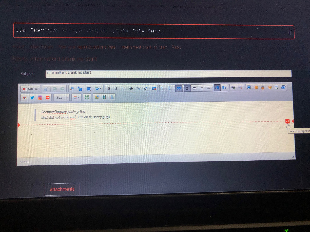

Clicking the red Enter symbol has been working for me. Far right in the picture with the mouse hand over it.that did not work smh, I'm on it, sorry guys
