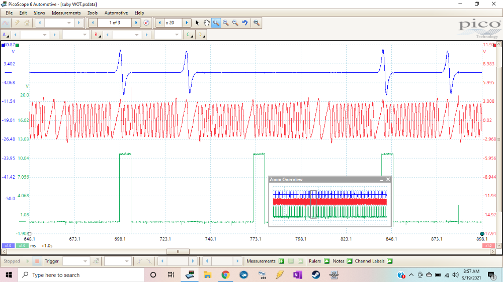

Update with more waveforms. Thanks to everyone that's replied so far! :cheer:

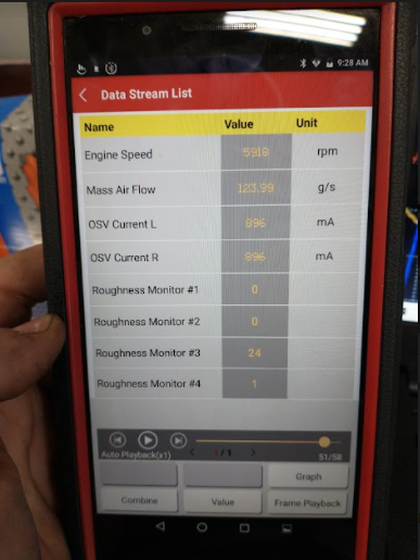

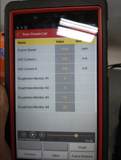

Before going down the scope path, I still wanted to get a scan tool with better data. Thought about Evoscan? :huh: But I'd have to get a special cable. Tried the Autel Ultra - wouldn't even attempt to talk to it. Got desperate and tried the Launch Pro Mini... Success! I couldn't transfer the data or the screenshot, but this is a shot of the data during a WOT run with the MIL flashing:
So the codes say #3 and #4, but the Roughness Monitor favors #3. :huh: While free revving in the bay, I can get both #3 and #4 to count up:

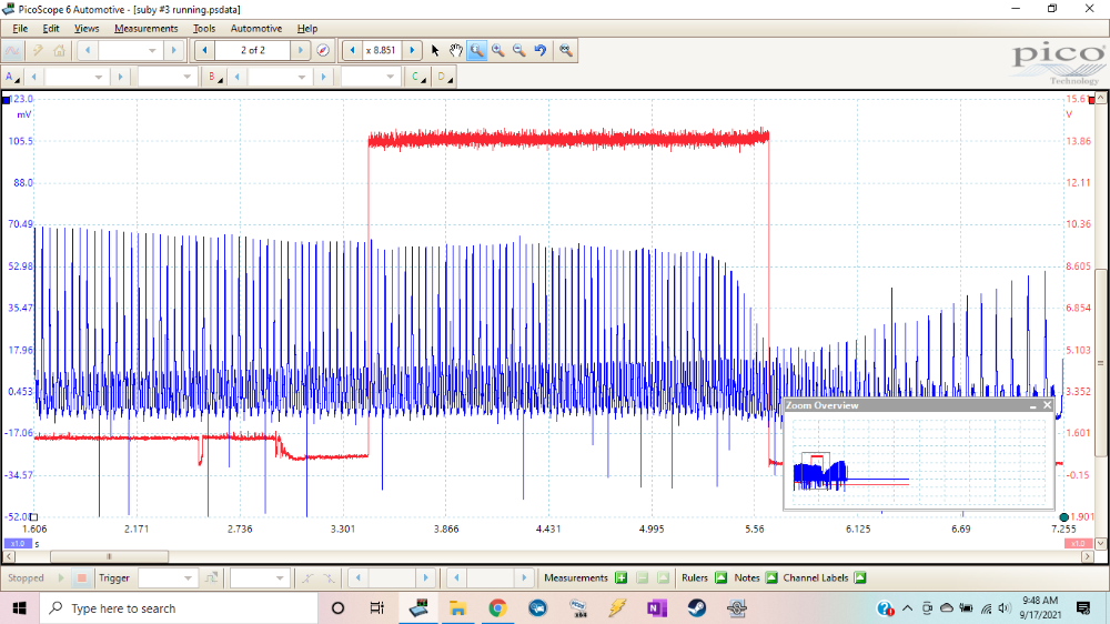

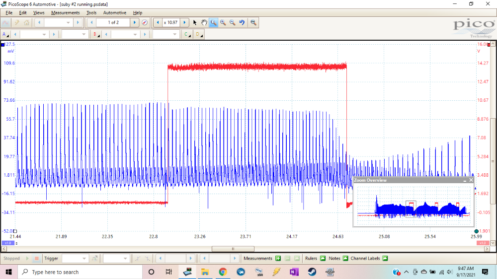

So I start thinking about the VVL system, since it's programmed to engage above 3500 RPM. I went in-cylinder on each cylinder to see if I could identify an issue. Here'a shot of #2 (theoretically known good). The red trace is the oil pressure switch for the VVL solenoid on the same bank. Short version, the oil pressure switch changes state when the solenoid is activated.
I generally take the slight dip in compression after engagement to be a good indicator of VVL operation. I also see a slight difference in the intake pocket. Here's #3:
It looks similar enough to #2? I'd appreciate your thoughts. As always, e-mail me at wrenchturnsyou@gmail.com for the original captures.

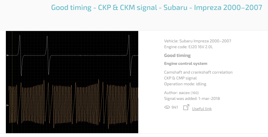

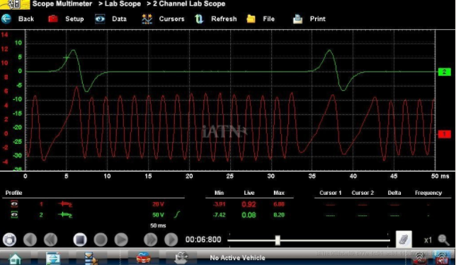

I also had a look at the cam, crank and an ignition trigger signal. One, to recheck the cam/crank sync, two, to check up on ignition advance, and three, to see if I could ID the true misfiring cylinder. To be honest, I couldn't make heads or tails of it. :silly: Again, I'd welcome anyone to have a second look.
Finding known good waveforms for this is a little challenging. :unsure: I found two that looked similar to mine, but they had different relationships.
My cam/crank at idle:
Known good from Harvey Chan at iATN:
Known good from some guy at Rotkee:
Last edit: 5 years 1 month ago by Tyler. Reason: Clarification
5 years 1 month ago #51551 by stevieturbo
Replied by stevieturbo on topic Re:2006 Subaru Forester 2.5L hesitation/misfire
Your crank/cam look the same, albeit your scope with the black screen just seems a pretty low resolution or capture speed ?
On the second red trace, why is there a dip at the bottom before it goes high ?
On the Quad cam motors, it is not uncommon for the mesh screen for the VVT solenoids to gather dirt causing issues, and/or the dirt getting into the solenoids. But as said, naver worked on any n/a single OHC motors, only turbo cars.
Time to create page: 0.496 seconds
