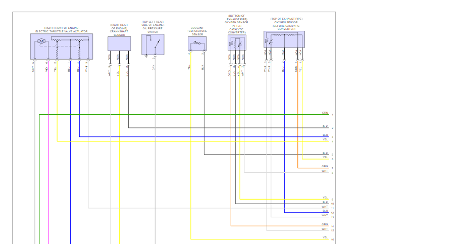

5 years 1 month ago #51150 by guafa
Replied by guafa on topic 2011 Mini Countryman
OK, there you have.
I´m confused, since you mentioned sensor 1 is a 4 wire. Drawings are suggesting sensor 1 is a 5 wire one. Is it at top of exhaust pipe?

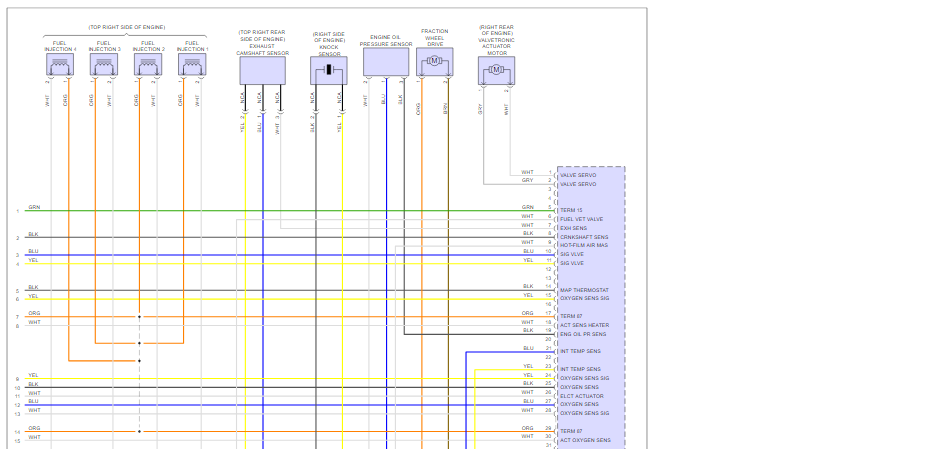

5 years 1 month ago - 5 years 1 month ago #51155 by guafa
OK, according to drawing you have an internal sensor voltage divider.
My first interpretation is that sensor signal (gray) has a voltage reference (blue) and a ground reference (yellow). They are reference voltage PCM expects to read (sense) and depend on values of internal sensor voltage divider (internal resistance).
So my first shoot would be to compare those resistance with oem sensor (i know you trashed it). We need to find some kind of test procedure which let us know those resistance values.
Why did you change oem sensor by the way?
Last edit: 5 years 1 month ago by guafa.

5 years 1 month ago #51242 by guafa
Ok Richard1.
P3016 is related to a calibration resistance inside pcm, which determines heater temperature (not related to signal circuit).
It is set due to pcm expects to read a voltage (inside pcm) when a voltage is aplied to that calibration resistance.
That seems if you have tested pcm voltages and grounds and they are correct, you have a pcm issue.
