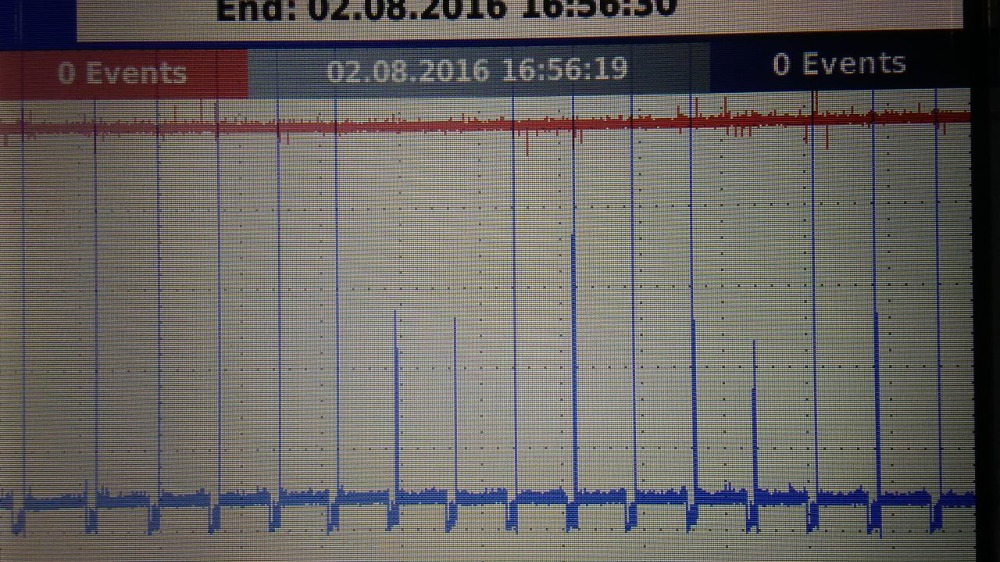

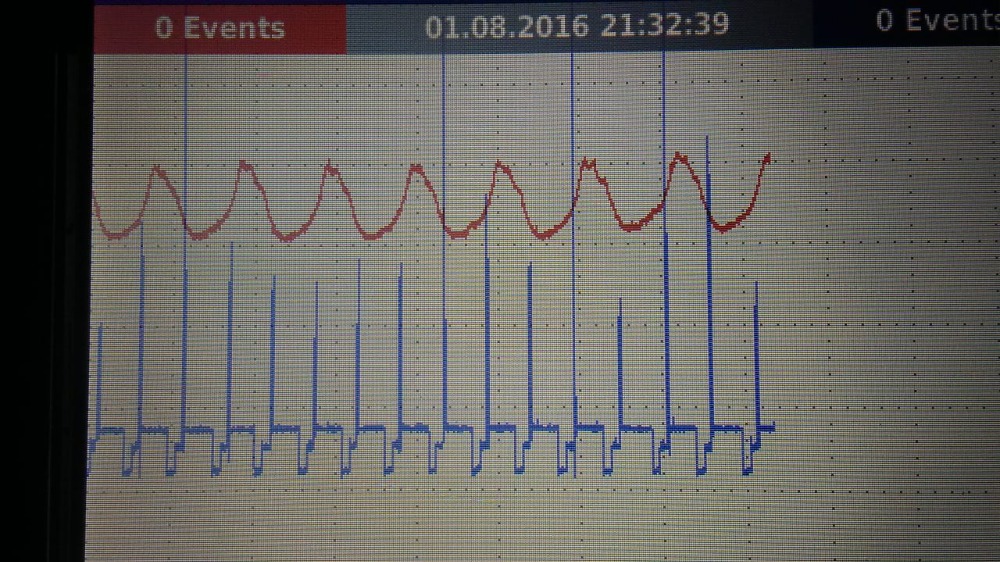

Hello guys,
Blue trace is primary ignition coil in a distributor type and red trace is intake vacuum.
This engine has modified camshatf (a little overlaping according to customer)
Vacuum idle (cold) is about 6.5 in/Hg and (warm) about 9.5 in/Hg.
My question is how modified camshaft could affect vacuum waveform, since I am watching just one valley every two ignition pulses instead of two valleys (all cylinders sucking separatedly).
Any comment would be apreciated.

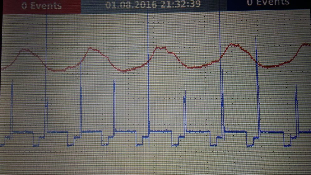

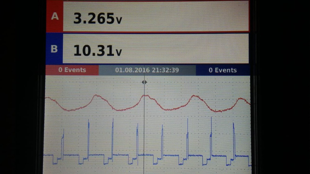

Another picture a took before, was secondary ignition on cylinder #1 (blue) and vacuum (red) at idle (see attached file). I could notice cylinders 1, 4, 6 and 7 are the ones which generate that valleys. On the other hand 8, 3, 5 and 2 match the peaks (which are the ones i would expect to generate another valleys)
Due to not all the valleys or peaks are being generated on the same bank, and also the fact that every peak is followed by a valley (so symetrical waveform) i would discard a mechanical issue)
I am definitely not familiarized with modified camshaft, but my common sense doesn't explain why i am not seeing the intake job (valleys) for every cylinder (since camshaf overlaping is aplying to all cylinders and intake stroke is 90 degress separated one from another)
Capture was taken at idle.

There's a good chance 1, 4, 6 & 7 are tied together as one half of a dual plane intake. You might have your transducer hooked to a port that only sees one of the intake planes. Or there could be a restriction in one of the planes.Another picture a took before, was secondary ignition on cylinder #1 (blue) and vacuum (red) at idle (see attached file). I could notice cylinders 1, 4, 6 and 7 are the ones which generate that valleys. On the other hand 8, 3, 5 and 2 match the peaks (which are the ones i would expect to generate another valleys)

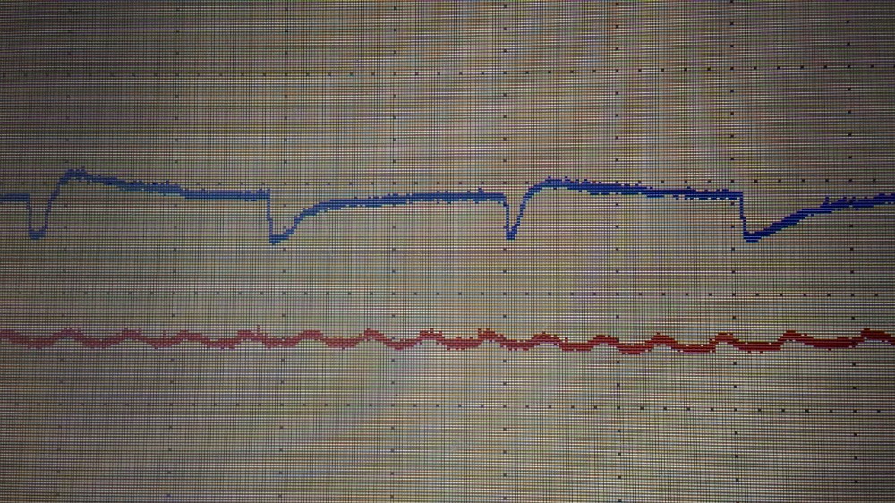

Ok guys.
Here is a picture of vacuum while cranking.
Map voltage (red trace) is 3.9v (which is barometric pressure here (82 kpa)). As you can see there is no vacuum pressure.
Matt T. All readings were taken at throttle body ( 400 hp 4 barrel fi tech) system.
Intake manifold is eldelbrock 2101 (i know nothing about this intake manifold but i'm afraid it doesn't have any test port)
