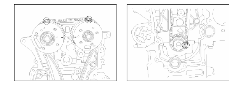

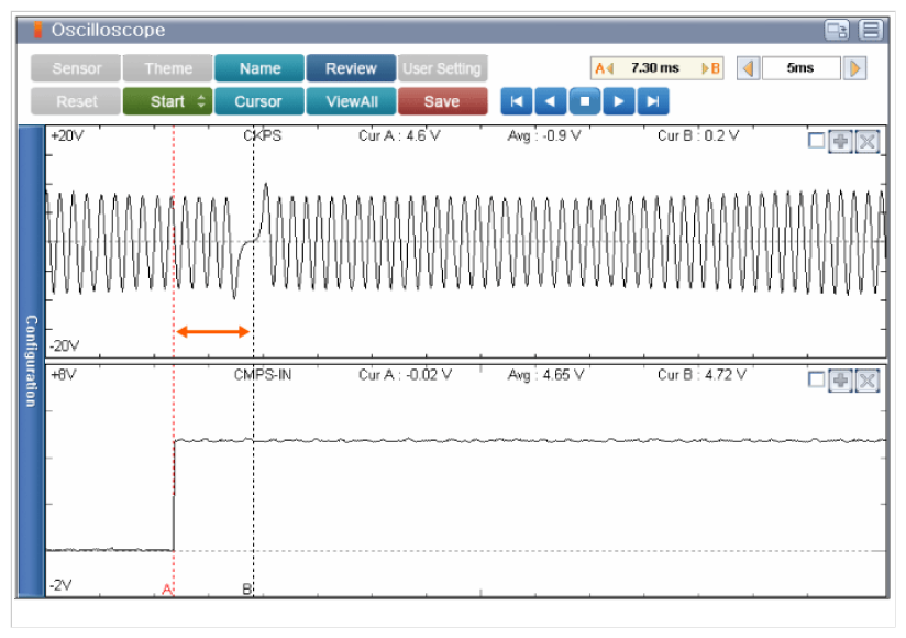

Replied by Noah on topic p0012 intake camshaft position over retarded
Sorry you haven't gotten any replies to your post.
Generally speaking, when I see codes like this, especially if they come right back in a very short amount of time, my first suspect is mechanical timing.
I believe it would be easy enough to pop off the cam cover and verify the timing marks.
I don't have the Pico software on my device to open your waveform attachments, but Kia provides a sample waveform.
This is for a 15 soul with a 1.6.
My service info doesn't list a Forte in 2009.
Also see attached the camshaft alignment marks.

- nidalalrifai
- Posts: 2
- Thank you received: 2
4 years 7 months ago #50939
by nidalalrifai
Replied by nidalalrifai on topic p0012 intake camshaft position over retarded
Thanks for your help
I fixed the issue
Cleaning the small filter live under VVT ...
I fixed the issue
