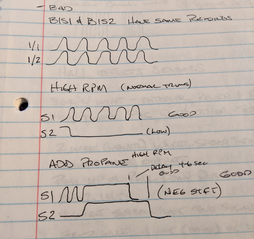

If I did this right, here is what you want to see. This is a cat efficiency test.

Did the test but didn't show the sensors like I was expecting, will try to print them in sample unless you would rather see it live.

Here are the graphs, a total of 6 of them:
Bank#1
1: 2500 RPM No Propane
2: 2500 RPM With Propane
3: 2500 RPM Remove Propane at Marker 1.58
Bank #2 "Same As Above"

Dean,
After everything we did today I went back and read all your posts for anything I might have missed. I did, the P0430. That pretty much does it for me. I would call this a bad cat problem. But, careful, what caused the burnout. A rich condition for to long. If you decided to get a cat, check all readings after.
You could replace 02's but I don't think it's going solve the problem.
John

Replied by Dinos55 on topic Scanner Readings
I was concentering that bank (2) had a bad Cat. but I didn't think that it would affect bank (1) readings to swing so wildly like they are on bank (2)
Assuming Cat (2) is bad would that cause it to miss really bad when going up a hill "Under a load" and cause a negative LTFT.
John, again thank you for today, you were very generous with your time and knowledge I very much appreciated it.

Hi John, unfortunately no I haven't I am still driving it every day to work, a few test I have done since we spoke I took to a smog test station and had them measure the exhaust and at first it showed very high "Bad readings" then as we put it on the Dyno and brought the RPM's for about 30 Sec's the reading came down to normal, I also recently drill (2) .200 in front of the CAT hoping that if there is too much pressure it would relive it and make it run normal but only seem to help it a small amount but not what I was hoping for, it seems that when I put a load on it the fuel trims don't really go up much at all, I am very frustrated with this issue but I won’t give up until I figure it out. Not sure what direction to go into next. I may need to put in bigger holes in the pipe to relieve more pressure however if you remember my pressure reading, they were showing more of an erratic reading mostly in the negative until I got the RPM up to about 3000.
If you have any other ideas, I would love to hear them...!
