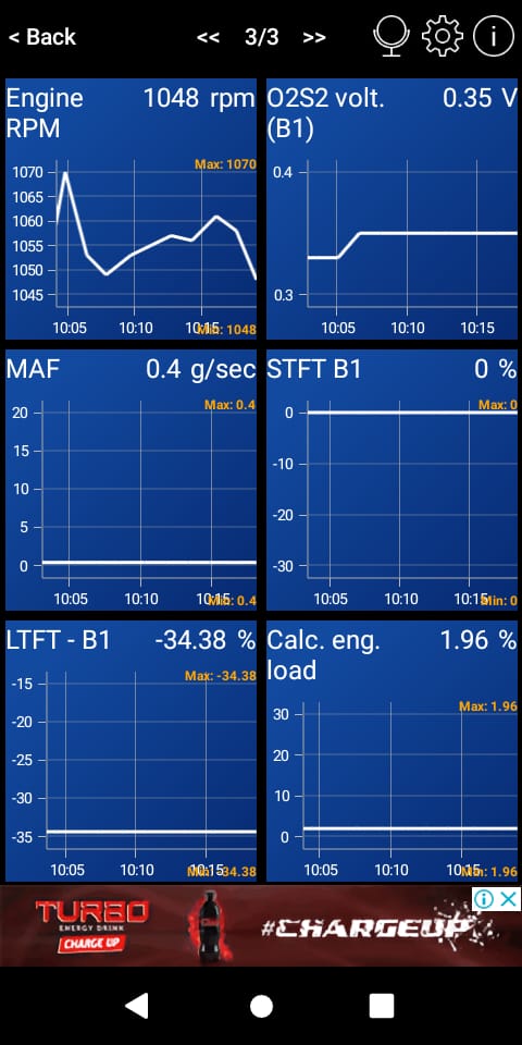

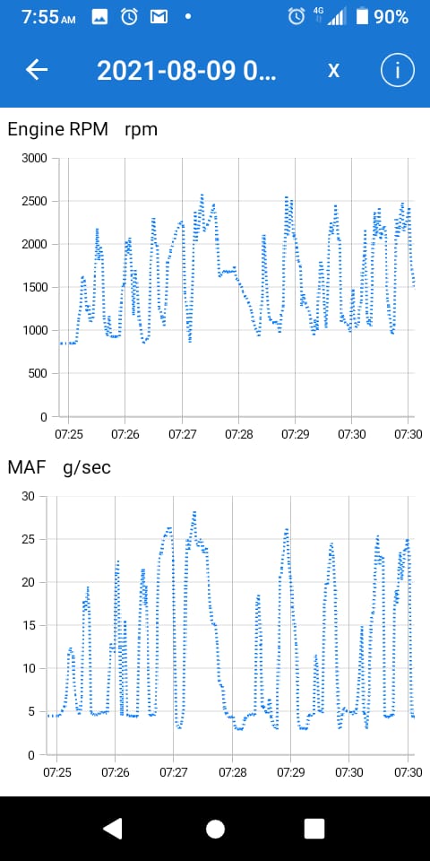

5 years 2 months ago #50551 by john1920
Hey guys, so i had enough time to do just one test, to disconnect the maf, im going to attach a screen shot that. I will get the results of the other tests tomorrow when i should have more time.
  • juergen.scholl
  • juergen.scholl's Avatar
  • Active partschanger
5 years 2 months ago - 5 years 2 months ago #50552 by juergen.scholl
Hi guys, There is a detail which doesn´t make too much sense to me.
If you pulled off PCV, you are forcing air bypass Maf, so readings should go down, since air passing through Maf sensor is reduced.
My little experience tells me at idle minimum reading should be above 1.8gr/sec (Don´t you think scannerJhon?. could be you know that engine better than me (i don´t know it at all). I Suggest you unplug Maf sensor at idle and see where fuel trims go (so that you can rule Maf out (only for idle condition)
So then if logic and design dictates that maf readings should go down......why then, did they infact go up?
This may shed some light on why the MAF reading can go up when creating a vacuum leak:
www.scannerdanner.com/forum/scannerdanne...ith-vacuum-leak.html
How are the fuel trims behaving at different rpm and load conditions??
The scan data shows 0% STFT, probably the ecm entered open loop mode due to the disconnected MAF?

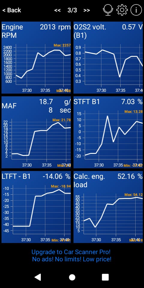

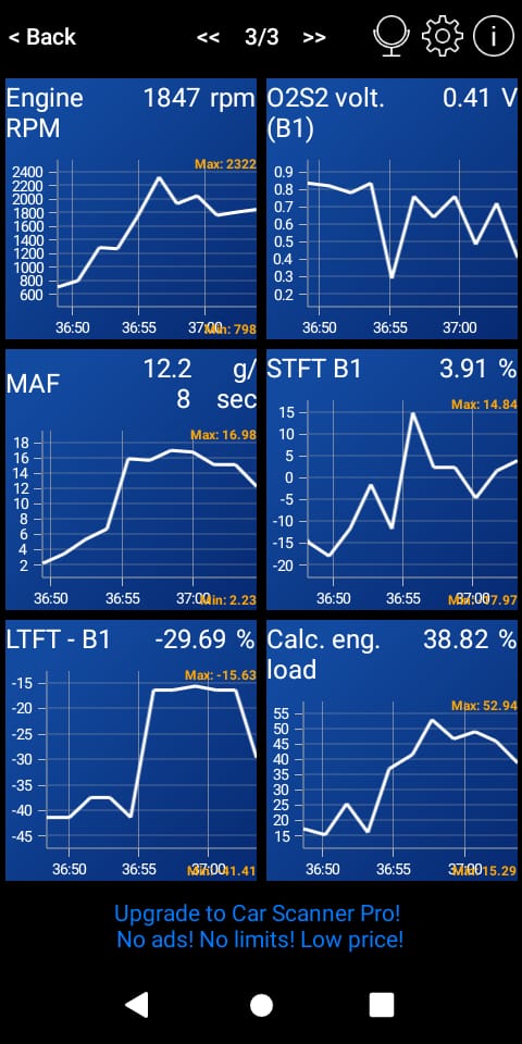

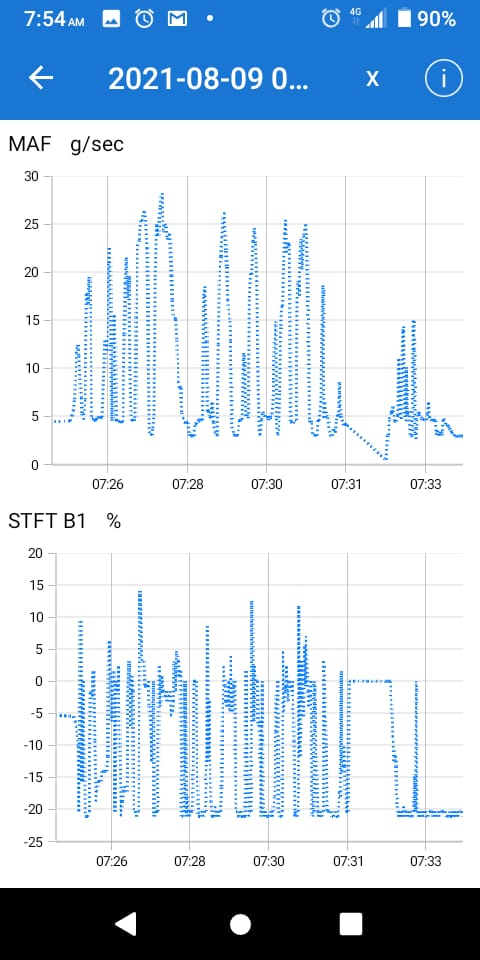

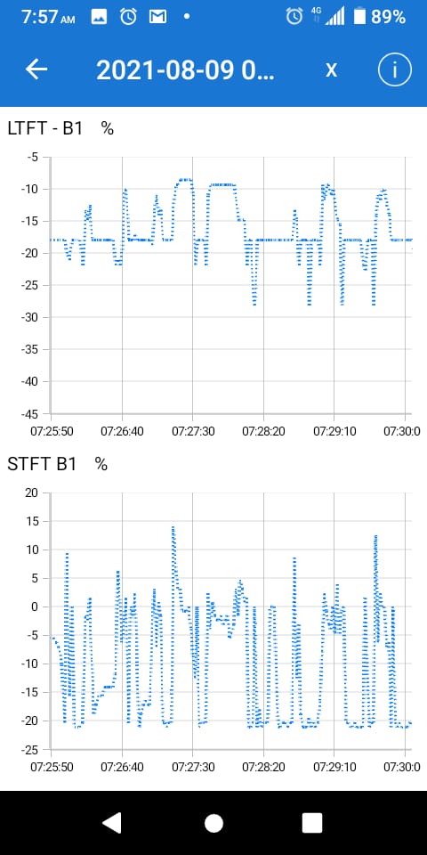

5 years 2 months ago - 5 years 2 months ago #50555 by john1920
Hey guys, good morning. So i just came home from a test drive and here are some scans that i took some screenshots of....
MAF is connected and codes were cleared.
I must also mention that yesterday when i was testing with the maf off I took another look at my vacuum lines and noticed quite a few cracks right at the ends, some of them weren't holding air when i blew through them, so as a temp fix until i could get some tubing I wrapped up the ends with some electrical tape nice and tight and I have to say that my G/S rose from that 1.2 - 1.4 that i reported earlier, to between 1.8 - 2.0. I'm going to attach some recorded data as well as some live data. Based on what I'm seeing here I'm starting to lean more to what scannerjohn said.....for me to look in the area of fuel.....furthermore, I'm starting to think that MAF isn't my problem but the O2 is still seeing a rich condition so that tells me that combustion isn't being completed.....I'm thinking I need to put my focus in the area AFTER maf and BEFORE O2S1 which would mean plugs, coil packs, and fuel injectors. Let me know what your brilliant minds come up with as my solution.
Last edit: 5 years 2 months ago by john1920.
5 years 2 months ago #50568 by guafa
Juergen.scholl. That make sense to me. you should see rpm going down for few seconds once you make the vacuum leak and then IAC opening to compensate rpm. Thanks.
John1920. I guess you have found root cause for Maf readings (nice). I would say now we don´t need to keep an eye on Maf as a problem now.
As i understand, LTFT is affected no matter PCM is on closed loop or open loop, so by unplugging Maf, LTFT on -35% is still telling us there is too much fuel
What the other tests are telling me is the amount of fuel that is leftover at idle, is becoming diluted at higher rpm (fuel trims going to less negative and O2S2 going to little leaner).
BTW. it would be great to have O2S1 readings instead of O2S2, since upstream sensor is not affected directly by CAT. Also fuel tank pressure and Map.
I´ll be pending on the other tests we suggested because we have not found root cause for excess of fuel.

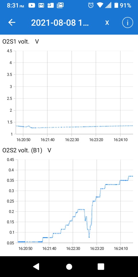

5 years 2 months ago - 5 years 2 months ago #50570 by john1920
Ok here's a shot of both O2 sensors, but i as im watching it i have some questions. I had always thought that the voltage on the upstream (O2S1) was between 0.1 and 0.9, not the downstream (O2S2). Was i thought wrong about the voltages on the O2's or is my scanner screwy?
5 years 2 months ago - 5 years 2 months ago #50571 by guafa
O2S1: It should be hot and on closed loop to start operating. the oscillation (between 0.1v and 0.9v) is due to PCM adding and extracting a little amount of fuel from stoichiometric (O2 sensor voltage at 450mv).
O2S2: When CAT is cold, you can see a voltage similary to O2S1 because CAT is not able to use oxygen passing through it. Once CAT is hot, you can see a steady voltage (depending on CAT efficiency between 0.4v to 0.6v). That steady voltage means CAT is using oxygen to convert CO into CO2 and HC into H2O. That voltage also means absence of oxygen (or at least there is less oxygen than present in atmospheric air).
If you have more oxygen than CAT can storage, It passes through CAT and O2S2 voltage drops.
About O2S1 screenshot, I´m not seing it bouncing and based on time you recorded, it should jumped into closed loop. Have you tested it?
Test O2 circuit integrity by unpluging the sensor and watching PID (should be 0.45v). Also you can check O2 sensor (plugged) making a vacuum leak and watching voltage droping.
Last edit: 5 years 2 months ago by guafa.
